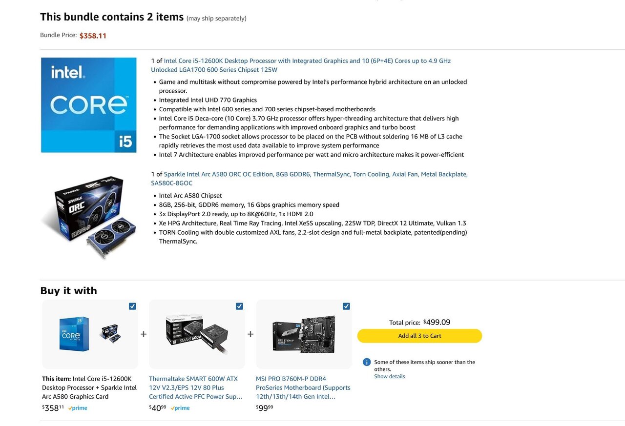

So I have a nzxt case laying around.  He already has peripherals.  I think realistically all I need is a gpu/MB/CPU/Ram.  I have SSDs, like what else is there been a while since I built a full computer lol.
Assuming i'm correct (Pretty sure I am), the most demanding games the kid plays are poppy playtime and fortnite.  He is turns 9 this year, so hes getting close to either turning the leaf to realing games or giving up gaming......So I want to get CPU/GPU combo that won't break the bank but can offer him more in teh futuer if he expands.  He games at 1080p 100hz right now and that probably won't change for a while.  Could I get a decent used combo for 500 USD or so and what would you guys look at?
Or am I better off driving to a costo or microcenter and just grabbing a sub 1k prebuilt and ripping it apart, or leaving it alone to be honest.  Money isn't an issue for what he needs, I just want to save a buck if I can since I really only need 3 components.  But if buying him a more modern complete makes sense I can do that too.

Intel: I'd look for a 12600KF or 12700KF. The "F" means no iGPU which tends to lower the price a bit. I wouldn't go any older than this unless you got a crazy deal.
On the AMD side I'd look into Ryzen 5600 or better.  A couple months ago, I'd say order a 5700X3D off Aliexpress, but those shot way up in price unfortunately.
For GPUs, Pascal is holding up amazingly well for how old it is, but I wouldn't go that route unless it was dirt cheap. Quick scan of my local listings and it's all over the place. GTX 1070s range from $40-150. For $40, sure why not... $150 put the crack pipe down lol.
Basically any RTX card would be a good option depending on pricing. I see 4060's for around $200 pretty often which are basically 2080 performance at half the power consumption. The price floor doesn't dip much below that though and a 2060 isn't worth $150. The price ceiling for Nvidia cards is basically the moon.
Radeon RX 6600-6750XT would be decent team red options.
Another option with Microcenter is going with a CPU/Motherboard/RAM combo instead of a full prebuilt. If I were I were in the same boat, I'd probably spend the majority of the budget on a new CPU combo and toss a cheap used GPU in for now. If he sticks with it, swapping in a new GPU is the simplest upgrade down the road.

If I were trying to build a good gaming computer for cheap, I'd look at the 2nd hand market.  3060ti or 3060 super 3060 12gb version, and 5800X3D would be my go to choice.  That combo can run any game on the market reasonably well and will be an enjoyable experience.
The 5800X3D is somewhat expensive as they are good gaming cpus and hold their value well.  However they have the same socket (AM4), as many other CPU's, and you could easily pick up a different AM4 CPU and change it later if it matters.  5700x's are going for about $115 on ebay.    Ram should be DDR 4 3600 or 3000, with the 3600 being preferred.  16 gigs is probably enough.  Just about any B450 motherboard should work, and they are pretty cheap new. Although you might want to consider if you need/want wifi tied into the motherboard.
PSU?  What is your power supply or do you need to buy one?
I generally do not buy prebuilts, although I do recommend picking up used computers from the local university, which are essentially prebuilt PC's that are about 5 years old.  University computers are cheap enough that replacing a component or two isn't that bad.
Prebuilt computers tend to cut corners.  PSU is generally not a good one and ram is often slow.  Often times they never bother to set the ram timing in the motherboard settings.  For me, it works out better to just build a computer.
