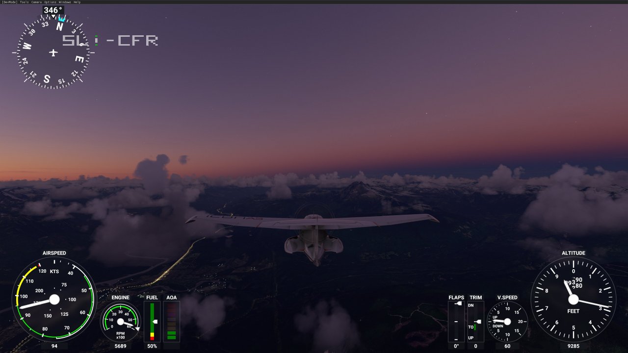

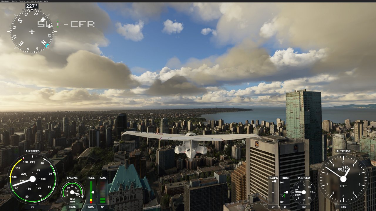

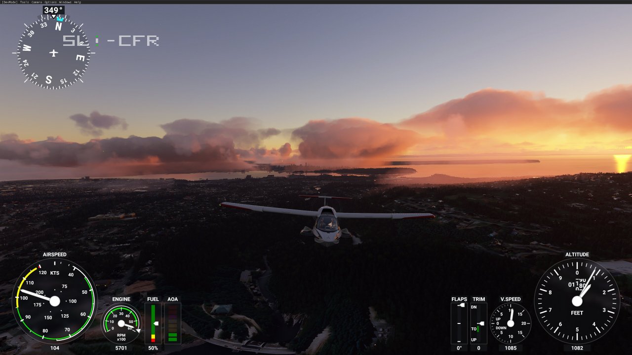

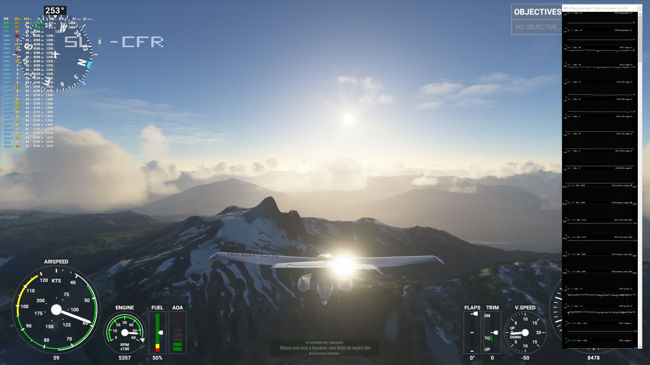

For now, I am having a grand old time via 2x 2080 Ti in CFR in Microsoft Flight Simulator 2020 (EHW thread on that > here ) - got CFR working with that shortly after Flight Sim 2020 release...4K Ultra ?
1534224379_GaribaldiMntScreenshot(3217).thumb.jpg.3f1de51bba88fb3ed1fd0858dfeef4ef.jpg
901445982_VanRoyalCenterScreenshot(3914).thumb.jpg.e452cc82581f63ebc8ea2bdccc9ad094.jpg
625086590_VancSouthCloudScreenshot(3522).thumb.jpg.670110f760196deac0540e092bee01fb.jpg
