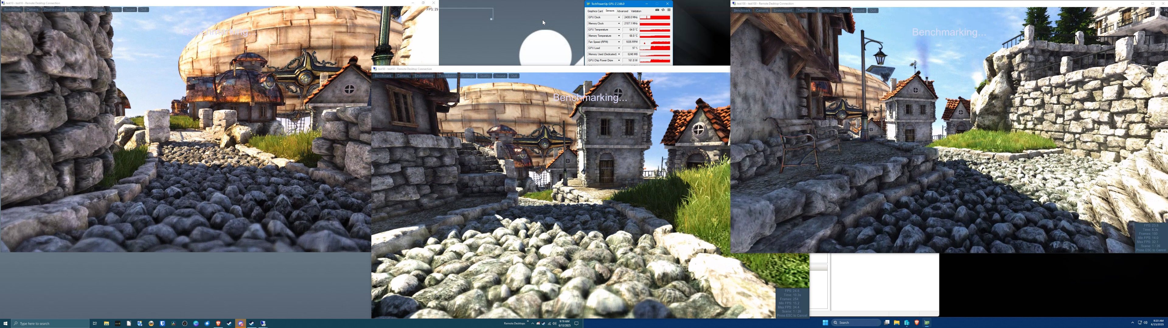

Three VM's all sharing resources together to utilize my 16GB Intel Arc A770 (tested with GTX 760 and newer and RX 6500XT and newer too):

This program splits your GPU EVENLY among VM's.  If there's no GPU load at all, your VM will have 100% of the GPU's capabilities.  If 2 VM's are fighting for resources, each gets 50%.  And so on.
