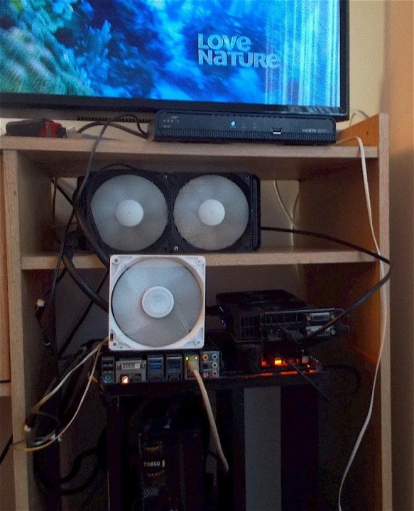

...the 'Porposie' build with the rejuvenated and modded TT 240 is still humming away with the same temp deltas for idle and load...since the end of July 2020 now, so the rebuild was worth it one way or the other...
...Porpoise has moved though - below shows its temporary home (re. cable '''management''') - building a new dual loop for 3950X / 3090 Strix OC and that affects three other existing w-cooled builds in daily use...going to be a busy month !
