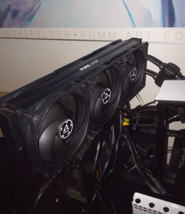

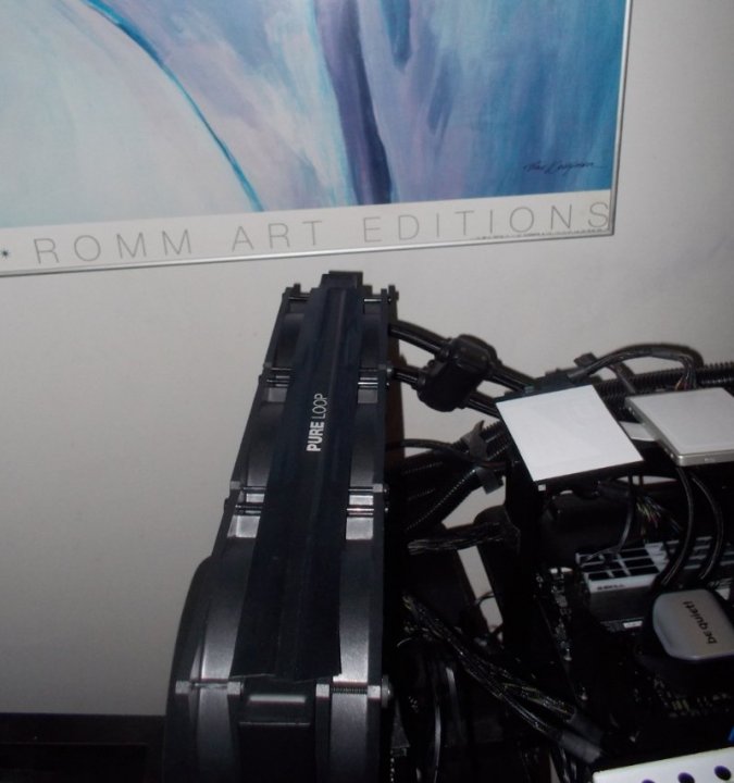

...quick update on 'sealing' push/pull with electrical tape: I'm just putting together a X570 Asus Crosshair Hero VIII wifi and a 3950X...got a BeQuiet PureLoop for a very low price (and it's even refillable !)...while this AIO is a great performer as is, I took the BeQuiet fans off and mounted six Artci P12 pwm pst in push / pull.
Even at full song, you can hardly hear them and manages to keep a 3950X in repeated Cinebench23 in the low seventies C. This unit will get a full custom loop as soon as the 3090 Strix block and backplate is settled on, but for now this is a more-than-decent solution. Pics below of the testbench for that, not final...note the electrical tape on top of the rad...still have to do some trimming, plus the sides...
