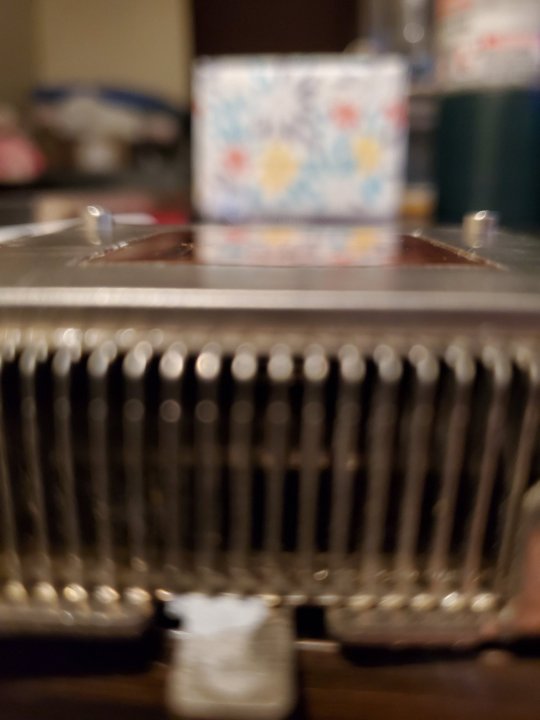

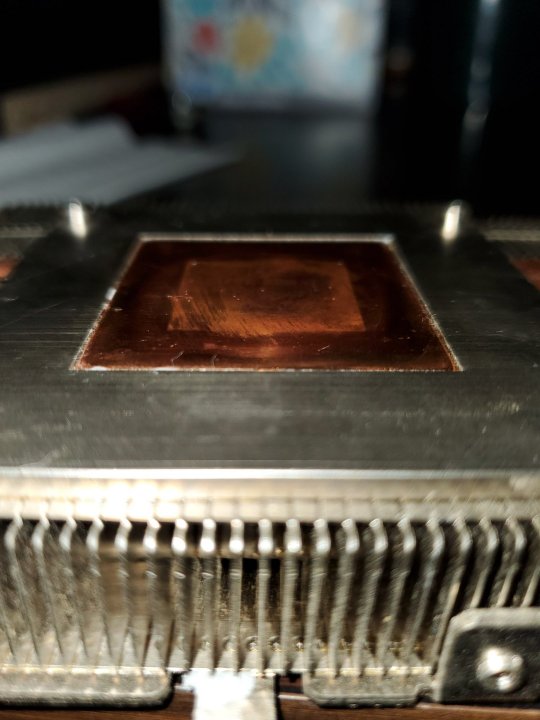

How is the cooler surface? Fairly flat?

tbh, never really paid attention to the cooler surface, case has moderate airflow (360mm rad push only, 120mm exhaust) ill take some pics of the cooler later tonight

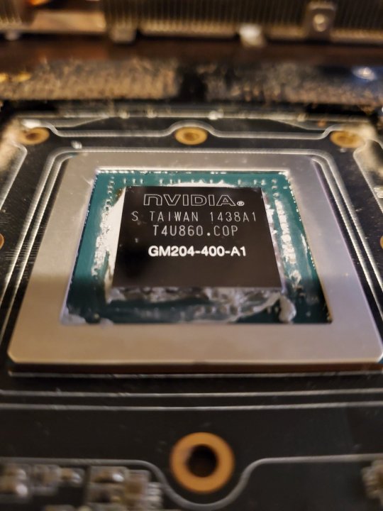

I would take a good look at the cooler surface and chip like @Mistio said, look at how the paste has been pressed out to the sides on the die(maybe not enough pressure), and confirm that all 3 of the fans work.

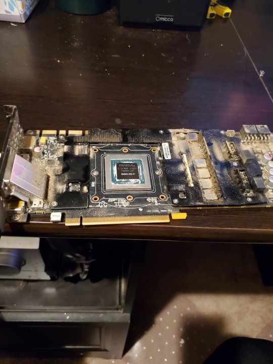

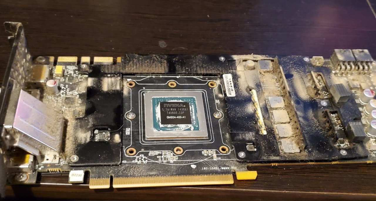

...I happen to have 2x GTX 980 Classified running in one of my retro machines. Even with XOC bios and on stock air cooler, they are at about 57 C max (no oc) after 20 min at 100 % load / 1.212v per test just now. That, though, is with a well-ventilated case (mesh side panel).
One thing that would definitely help is to clean that card...I did a double-take re. your top pic. The memory, power stages and all that contribute to heat, and their heat transfer is diminished per your pic. Also, if the fan shroud / fans have a similar build-up, their efficiency will be very much affected.

on a desk, with filters, I promise this isnt a airflow issue, and the heatsink is super clean. possible the hatpipes i nthe heatsink have failed? i might just pick up a cheap waterblock for it

Def possible. I once did a repair on an imac where the heatsink had failed and the gas inside it had leaked out through a tiny hole. Replacing the heatsink fixed it.

I would still clean the PCB but in any case, I have used these universal-GPU w-coolers on various (by now older) GPUs, including the 980 Cls. They work great. Just add 120 mm fan for the VRM and VRAM, and you're done.

Immediate thoughts are that either the gas in the heat pipes leaked out as mentioned before and thus they aren't working to carry away the heat, or maybe fans are broken even if reading at "100%", but that seems unlikely.
I'd see if you can source another heatsink, or else look at a universal water block or aftermarket heatsink. Considering you've re-pasted and reseated several times, I'm inclined to agree that the heatsink is probably toast if everything else is clean and airflow is good.
