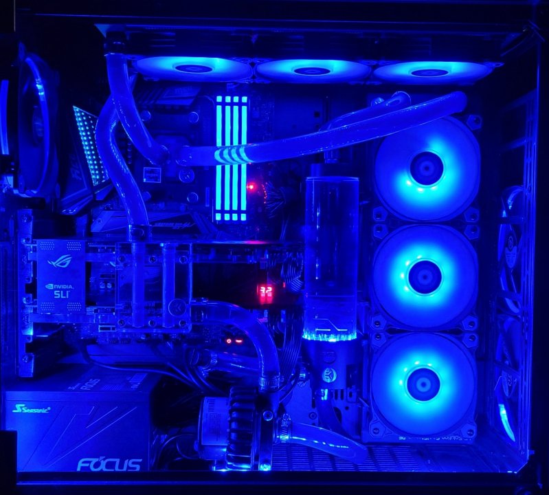

I just jumped on the 5800x train this week. I have 2x EK CS 360's in my custom loop and an EK Supremacy CPU Block. Stock and Auto CPU everything pushes me to 90C after a couple of P95 tests complete. My RAM is 3800/1900 at C16 and stable. Basically, just the Fast Zen2 Option for B-Die and it's 4 DIMMS in Ryzen Mem Checker for now.
Anyway, I'm trying to decide on whether I should replace the CPU Block. I use MX-4, but I think my tube is about 6 years old lol. I spread it and it's tight. I'm folding on 2 1070's only and my CPU is sitting at 72C, GPU's 52C both loaded. I even put a RAD between the GPU's and CPU to try and cool it a little before hitting the CPU Block.
Edit: I might even throw some ultra kaze fans on the rads to see what that does lol! It will become a jet engine, but that's a lot of static pressure vs TT Ring+ 12's!

I personally use Thermal Grizzly Kryonaut as my TIM of choice. If your MX4 is old and hard to spread etc, it may be time to swap that out.
Good call on the second RAD. I put one in my setup ready for a GPU so I can cool the warmer water from the CPU block a little before hitting the GPU block.

The change was maybe a 4C improvement to the CPU, but the GPU's are 5 C hotter, which is perfectly fine. I think I should have just reversed the order honestly. I think it's probably better overall to have only 1 cooling zone and to put your hottest block first, at least in my case. The GPU's are plenty cool still.
 It did spread normally. Not hard at all. I think it's probably still effective, but I may try some new stuff and re-seat it.
I just can't get over not comfortably being able to run CPU stress testing the way we used to. Maybe 90C is just the new 70C lol!

I got it figured out. My heat plate fins were oriented in the same position as my jet plate. I had placed the mounting plate wrong, fixed it, and forgot to check that. 20 mins p95.
The flow is really good now. I can now get into that oc.
