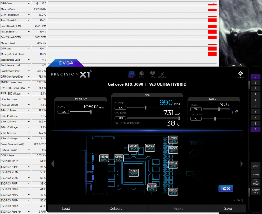

Like the title says, I'm not trying to boost lock - rather I'm trying to set a constant clock of lets say 1100 on the GPU clock. I've tried to do it in MSI Afterburner using CRTL + F, then hitting L at the proper offset but I think the evga BIOS prevents afterburner from modifying certain settings (like voltage control for example).聽

I don't want to *boost* lock though, I want to frequency lock. I'm clocked at -300 and as you can see my clocks are variable (i enabled the lock before i opened gpuz):

Yea, I get it, you are mining. Boost lock is the exact same thing as frequency lock. and I have never come across any software that is 100% locking. You are always going to have some variation.聽

I dunno how else to state it -- I want to lock the frequency at a certain clockspeed. Thats it. Boost lock doesn't seem to be doing it -- when I had my 1080ti I could force, through MSI afterburner, the clock to stay at an exact level I set.聽
There is no other question or circumstance. I just want it. I'm not crashing, I'm not getting errors, nothing bad is happening... I want to lock my clockspeed like I used to be able to do using MSI.
Hmmm, yea I don't know. I have never had a lock be 100% all the time, but usually very close. I don't know exactly how much variation you are getting. I see the graph, but don't know what the range looks like for you. If MSI or X1 don't work, I wouldn't even begin to know where to direct you. Sorry :(
