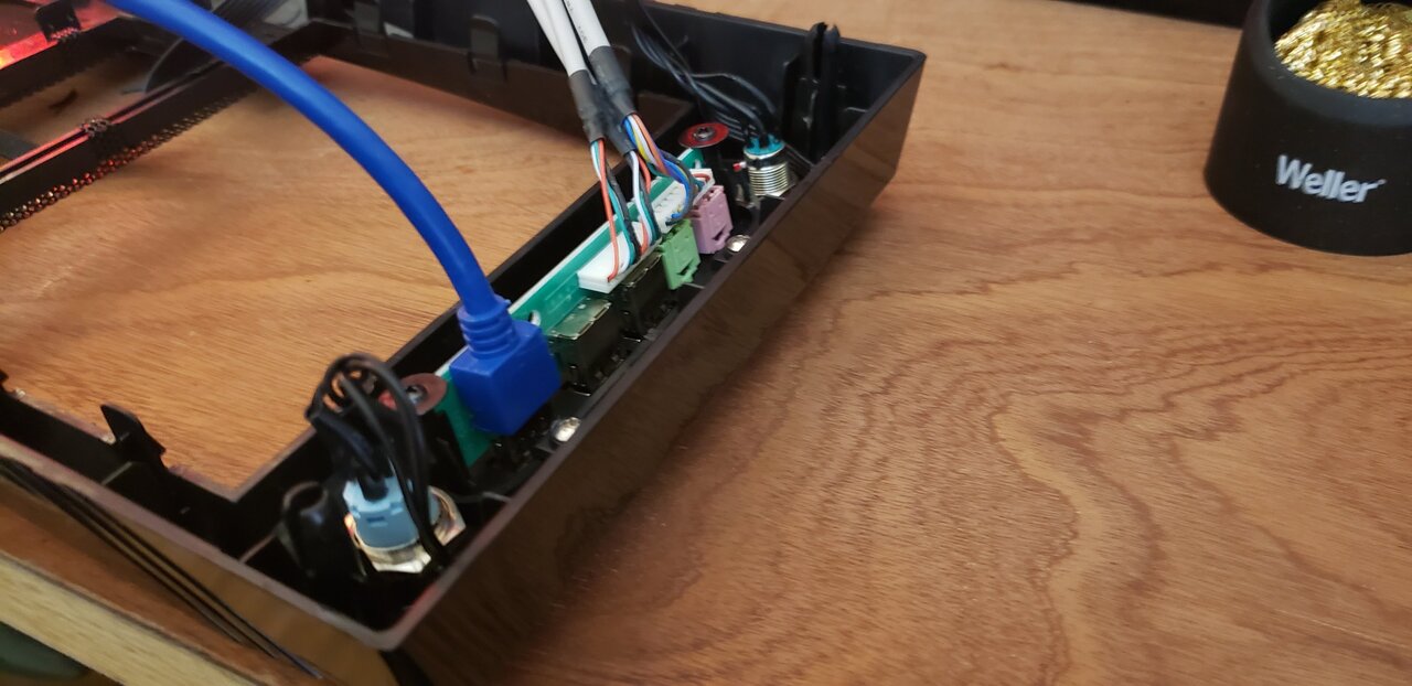

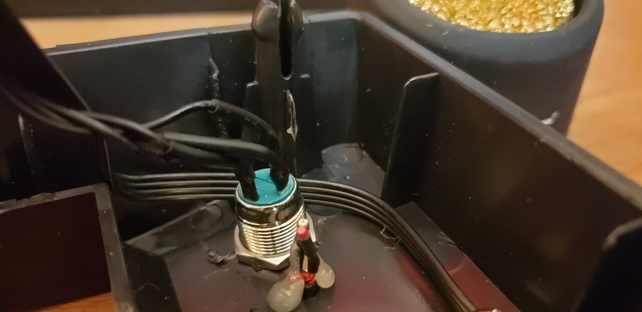

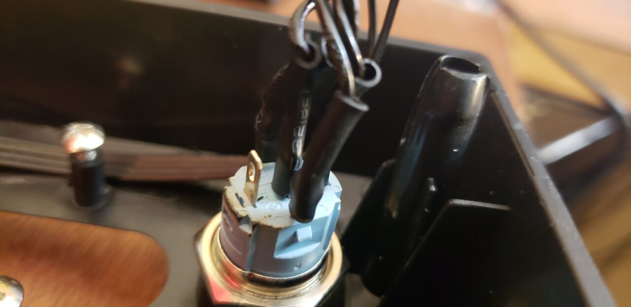

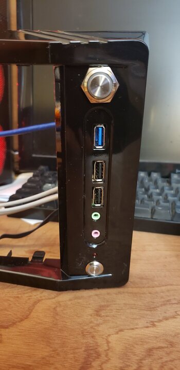

Power button, power LED, reset button, and HDD LED are all connected now.  Front USB's and audio are re-installed on the case again.  Tomorrow night (hopefully), I'll be swapping boards out on the 939 rig and with any luck......finally having it working! 🙂
Of course, I'm not an expert at soldering by ANY stretch of the imagination.....but they work. :wheee:

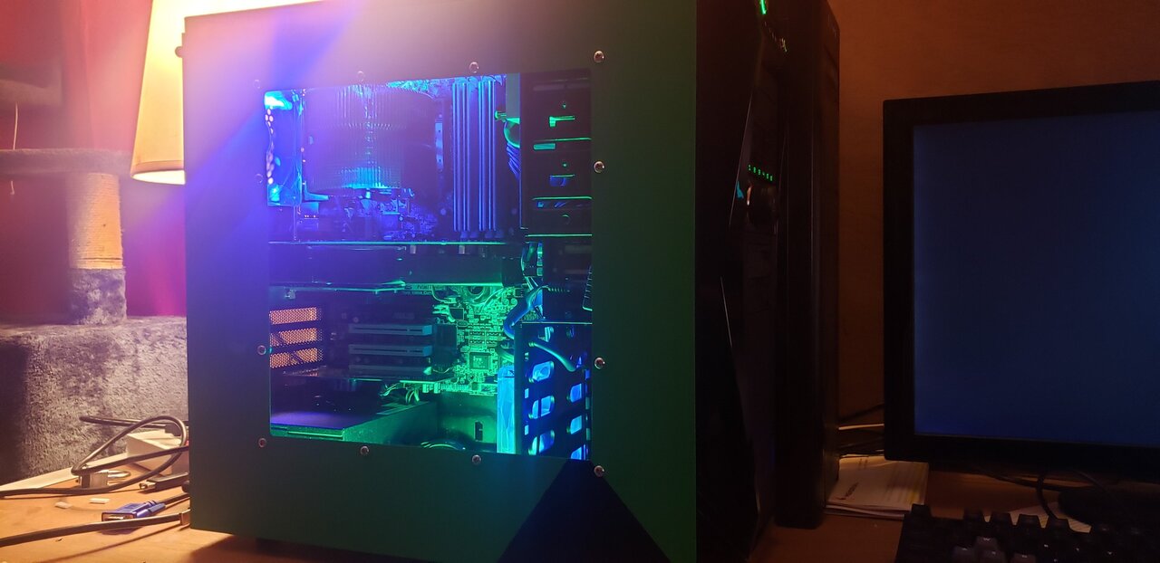

It's finally alive!  My first (again) Socket 939 rig!  Attempting to install Windows 10 to it right now, will settle for 7 if it doesn't work.  I definitely still need the A8N SLI Premium, the base model has no chipset controls hardly at all, and very little overclocking options.  I'll see what I can do with it though.
Short lived success I suppose. -_-
My test bench monitor died last night.  It's now stuck at 640x480 resolution.  Yes, its most definitely the monitor.  I swapped rigs, I swapped cables, adapters, everything else I could think of.  Only thing I couldn't swap was inputs on the monitor because I lack DVI-VGA adapters.  So, my museum pieces are now actually on a pause till after Christmas.  Small packages arriving or not, since I can't actually test anything.
In the meantime, I'll use my TV for making sure the 939 rig works.  Looks like I'll be in the market for a new cheapy monitor after Christmas.

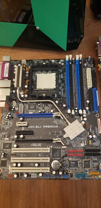

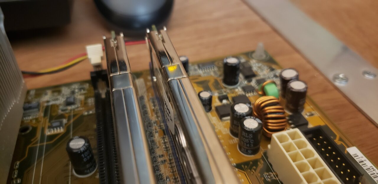

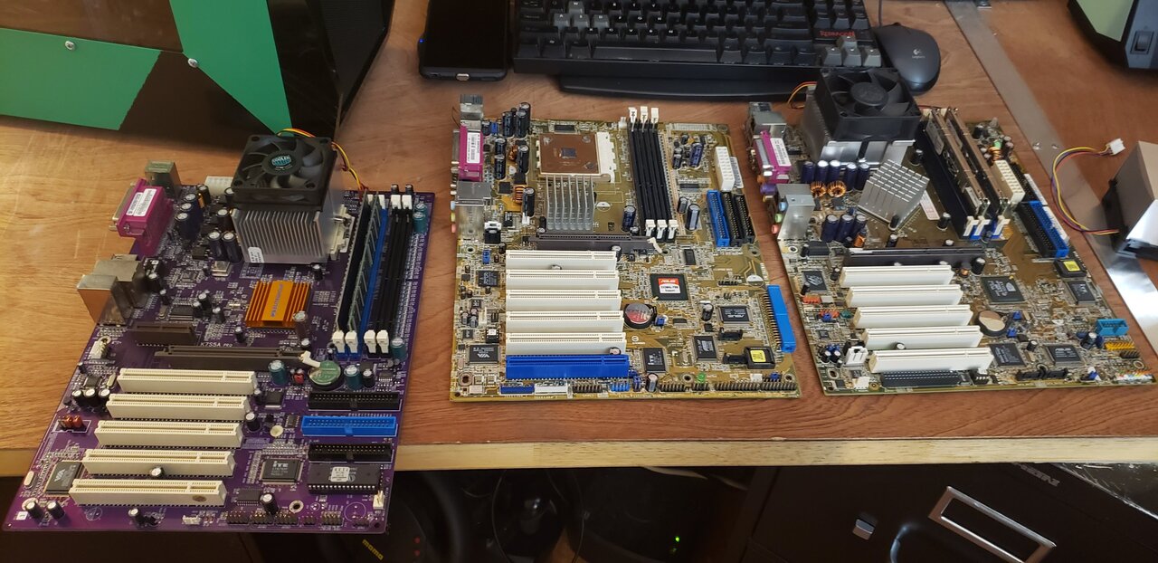

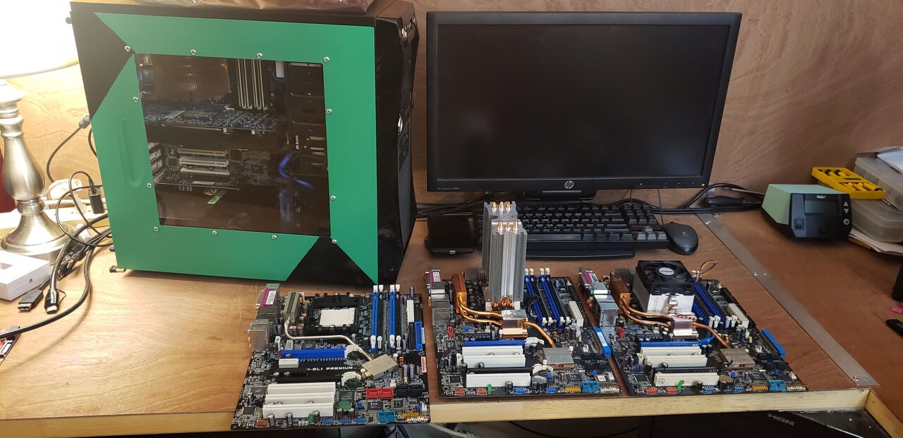

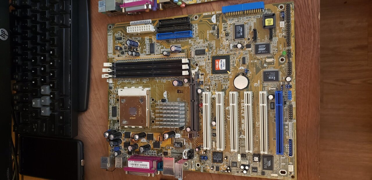

Huge images update (damage report):
So, the test bench monitor died.  I went ahead and went into a thrift store today, and I scored two 21.5" 1080p TN panels, one Dell and the other HP.  The 939 rig that's built is 110% functional, I had Windows 10 32bit on it for a little while and it was rock solid.  It was PAINFULLY slow though, CPU was pegged at 100% even when doing nothing.  So.....trying to get 7 on there now.
Images, I promised images.  So, its no secret now Bones said he had some cap soldering experience and even some spare caps perhaps on hand (depending).  So I went ahead and did an inventory of my leftover older boards that need attention to their caps.  Figured these are all getting built here within the next few months, might as well double check the caps before I proceed.
Socket 939 Boards:

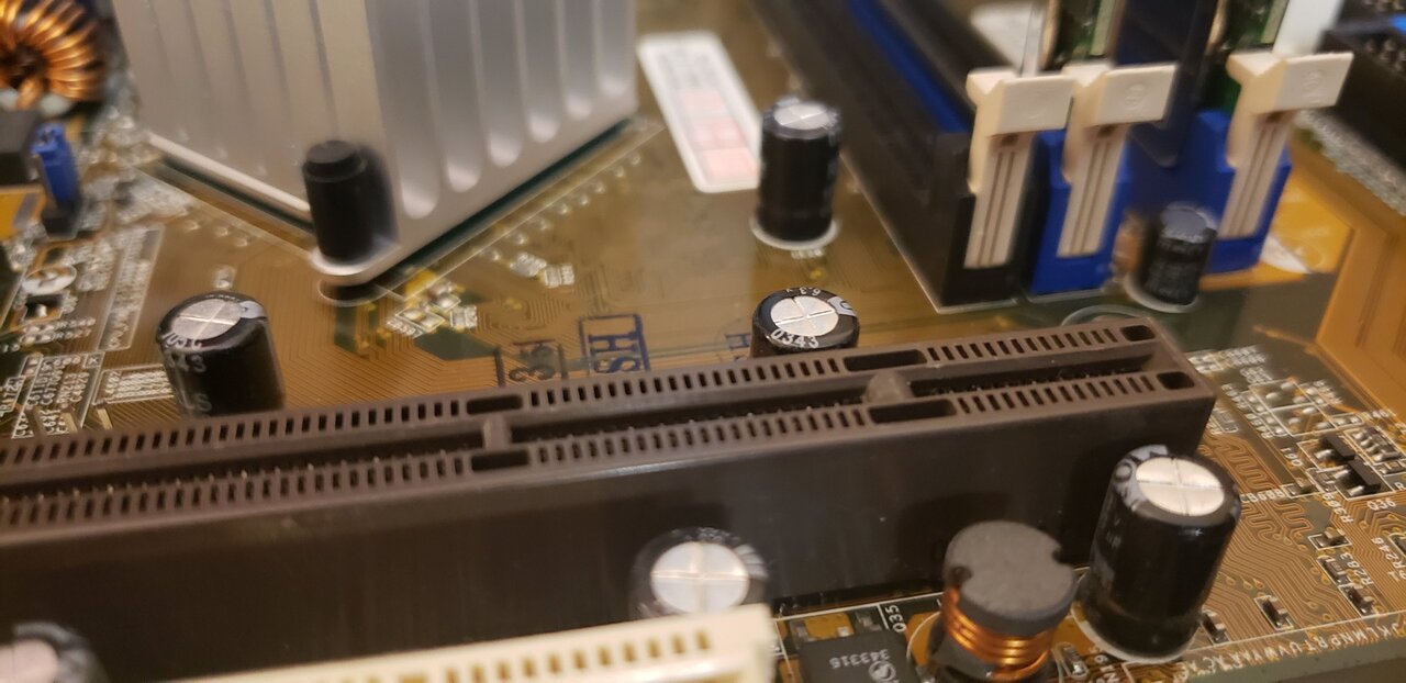

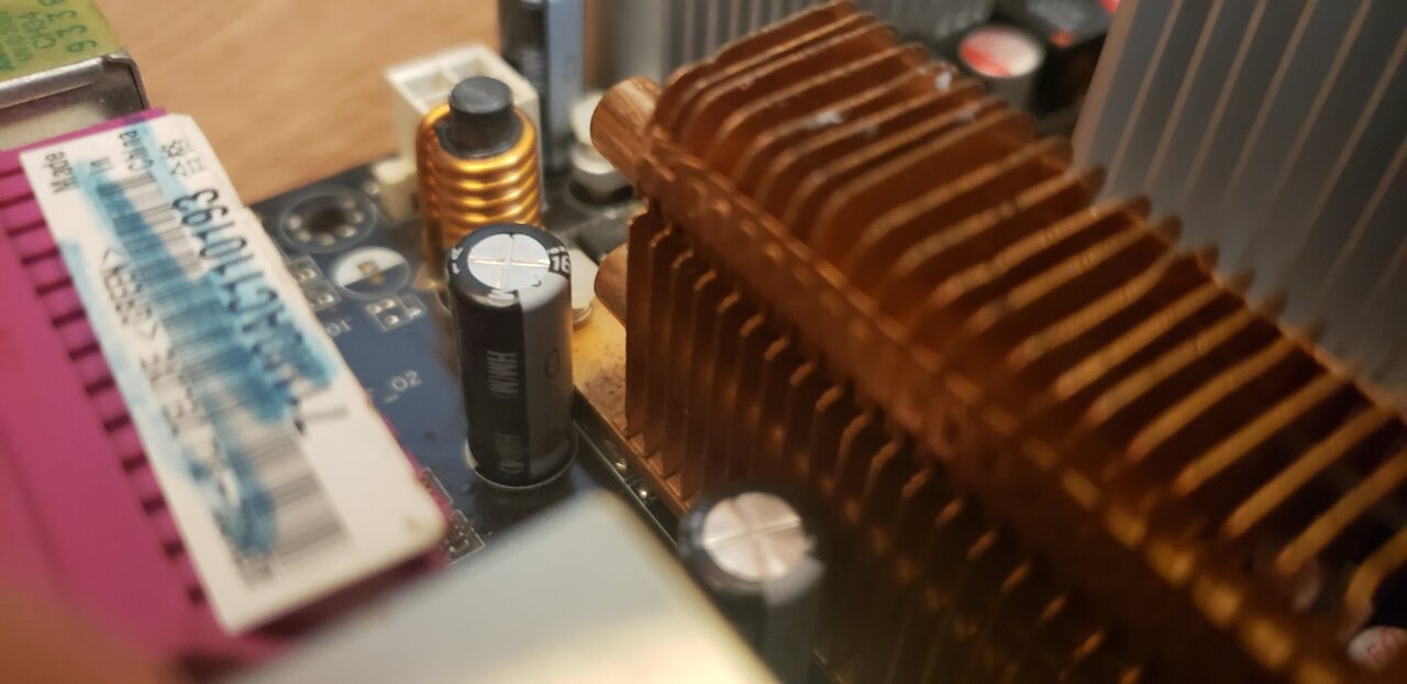

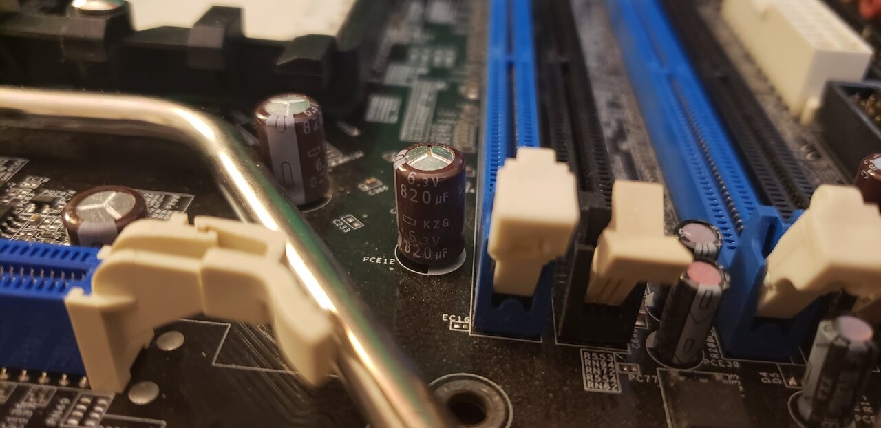

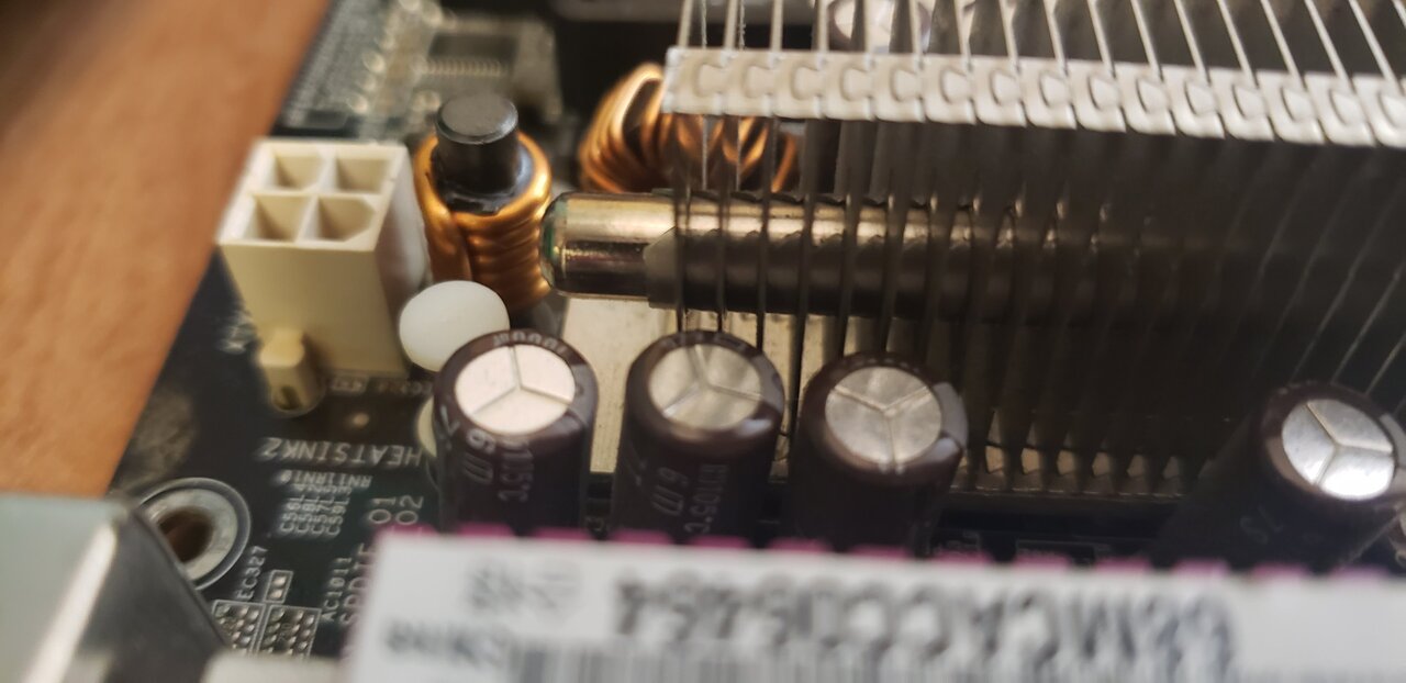

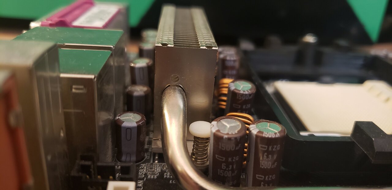

Asus A8N SLI Premium:
Definitely needs recapped, board works but is finicky with heavier power loads
This board is supposed to be inside of the case that's peeking in and photobombing it right below.  Bad caps were causing it to act funny under certain power load conditions.

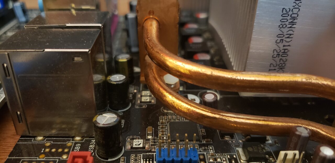

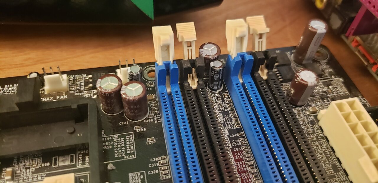

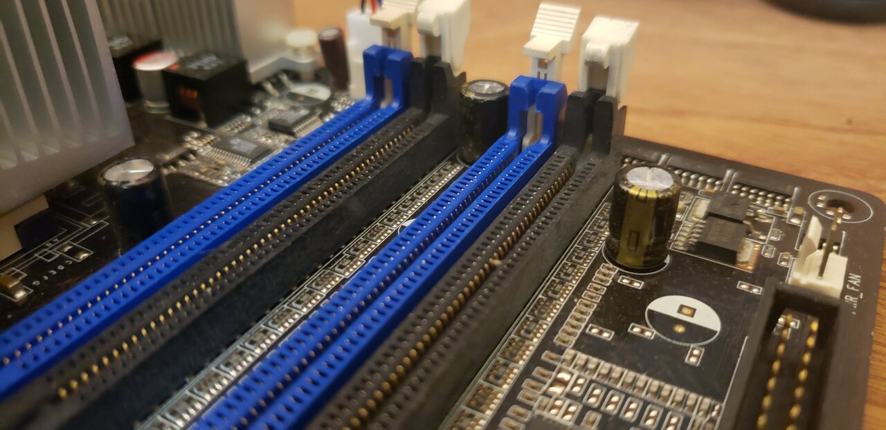

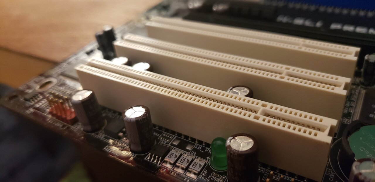

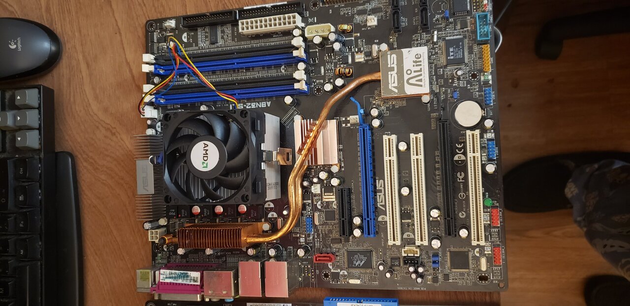

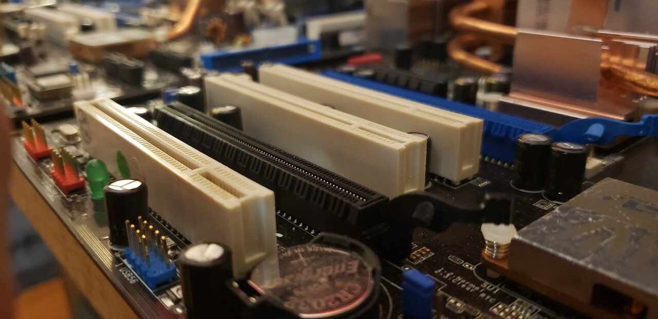

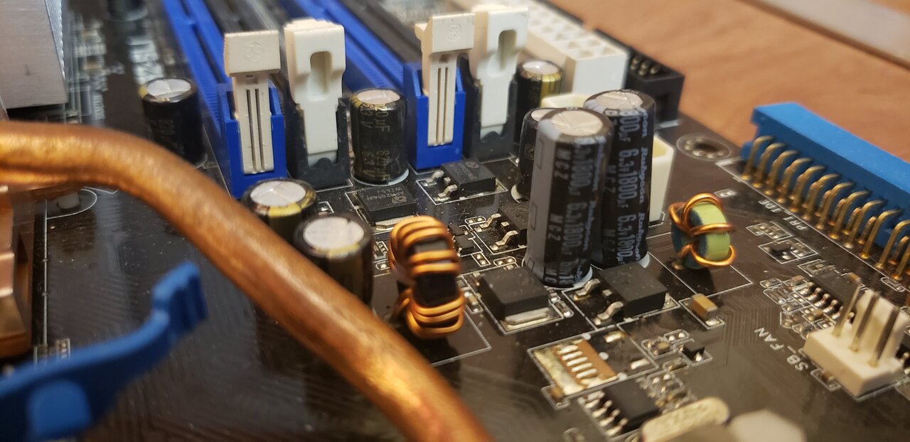

Asus A8N32-SLI Deluxe:
PLEASE LET ME KNOW IF YOU SEE BAD CAPS
I did check by hand, I didn't feel any.  I did look, I didn't see any.  I overlook things quite easily though. 🙂
This board was intended originally for the "only" 939 build.  However the HD5870 planned does NOT work in the top PCIe slot.  I couldn't stand that, and I happened to have a pair of GTS 250's on hand, so its going to be used in a second 939 build later on when I'm done with the original builds......a Socket 939 build that I intend to use somewhat regularly.
Asus A8N32-SLI Deluxe x2:
Pictured above is a second A8N32-SLI Deluxe (middle board), caps all looked / felt flat, but I assume broken traces.  So its just a spare parts board really at this point.  Did not take cap pictures or details of it since the other 32 laned board is the intended use board.

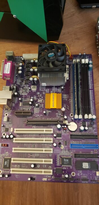

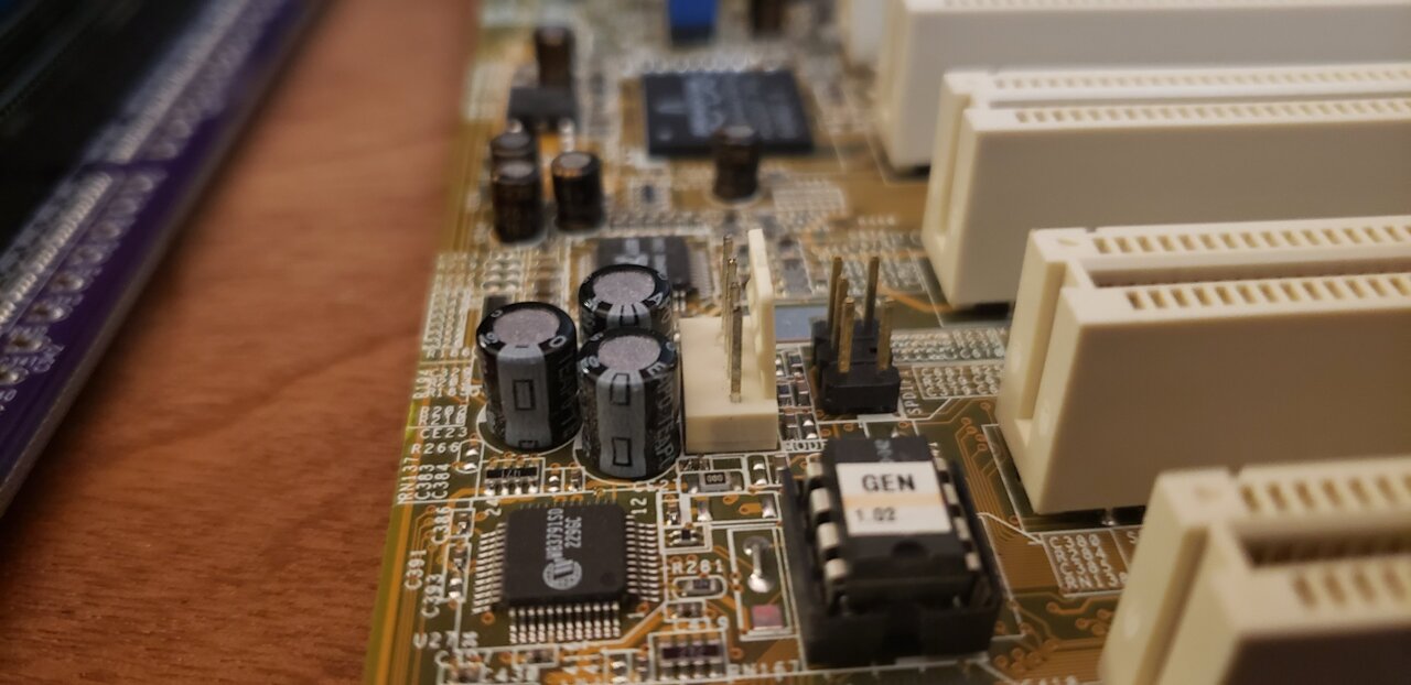

Socket A / 462 Boards:

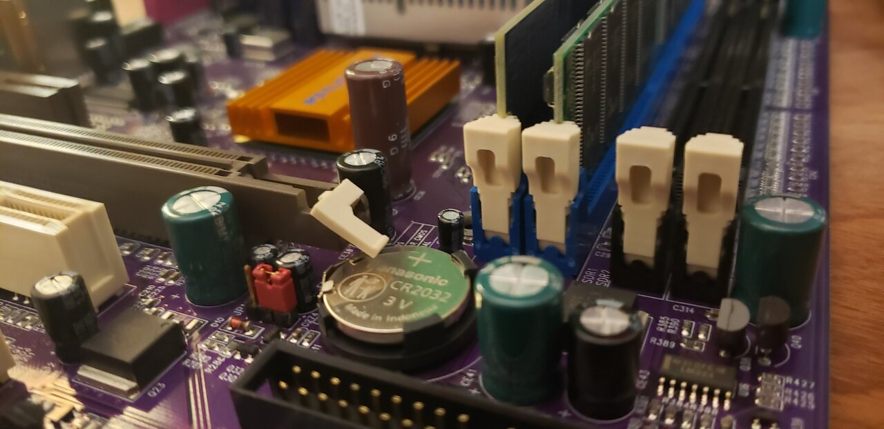

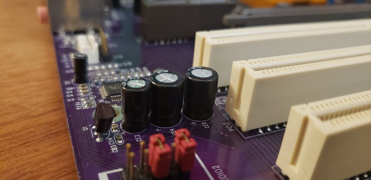

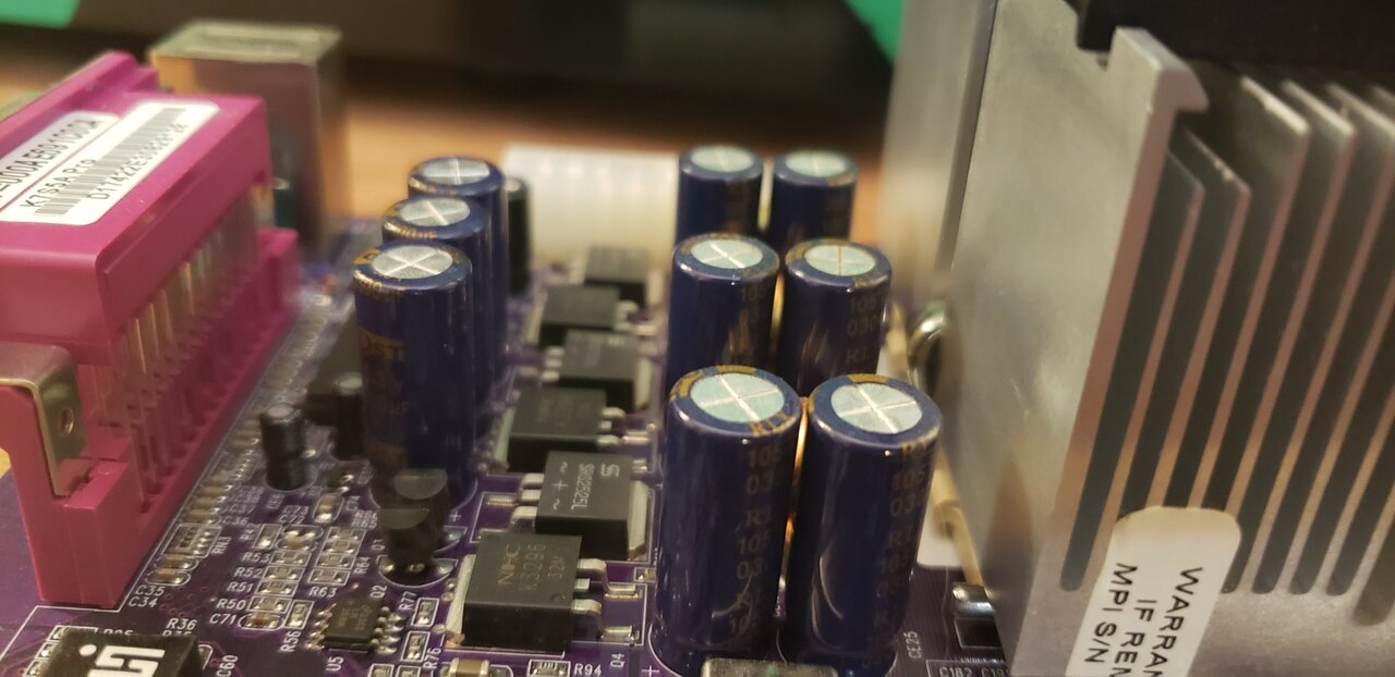

ECS K7S5A Rev 5.0:
This board I bought with the intentions of using the Athlon 1100Mhz T-Bird that's in it for a Windows 98 box in the Chieftec Dragon case.  Wasn't intending on buying an ECS board honestly, but the caps are flat and it had the CPU I wanted.  Appropriate era board too.

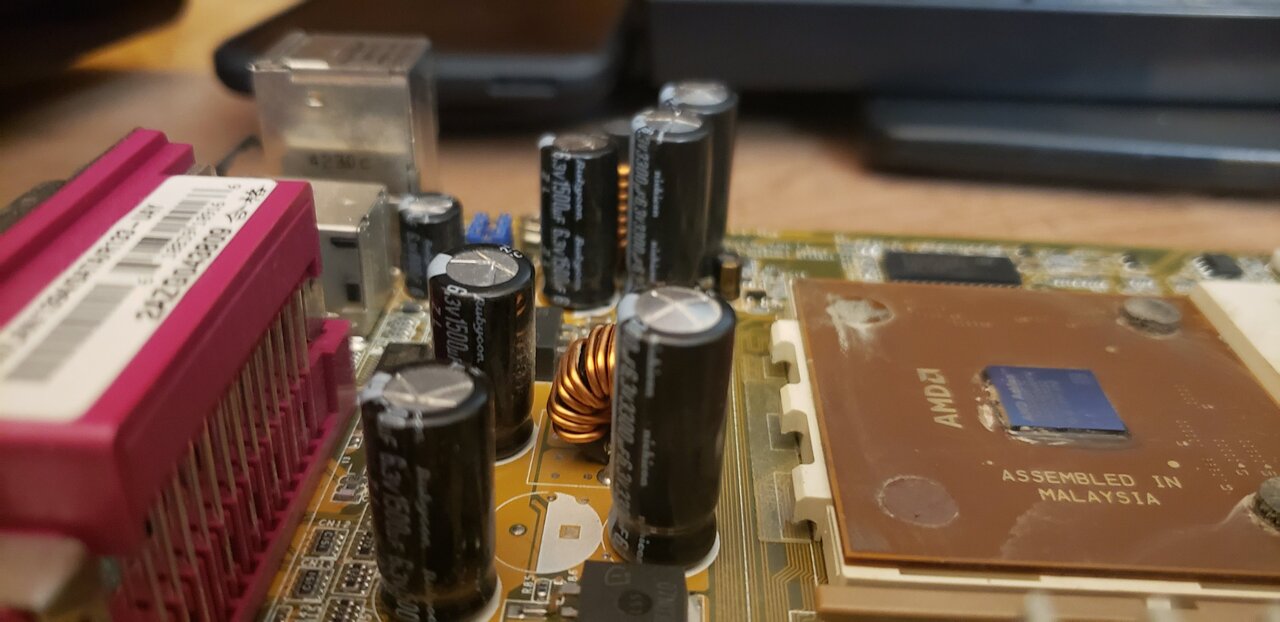

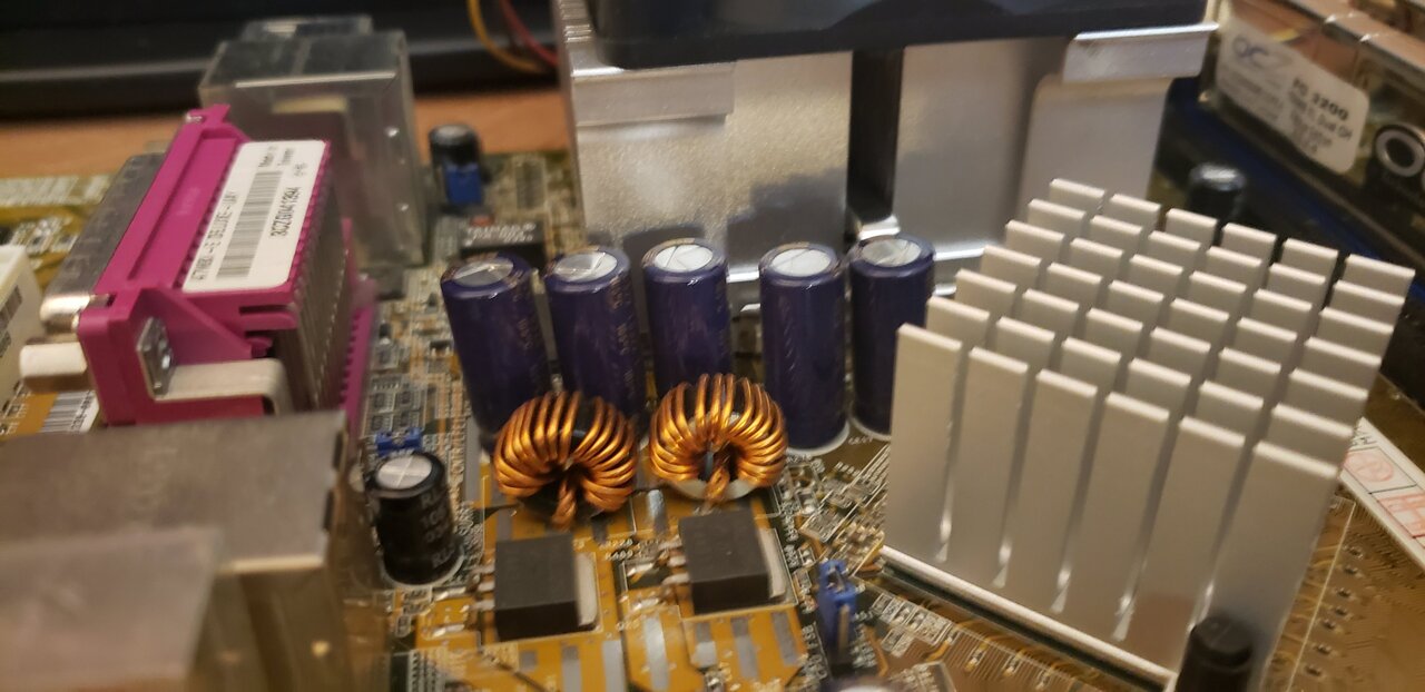

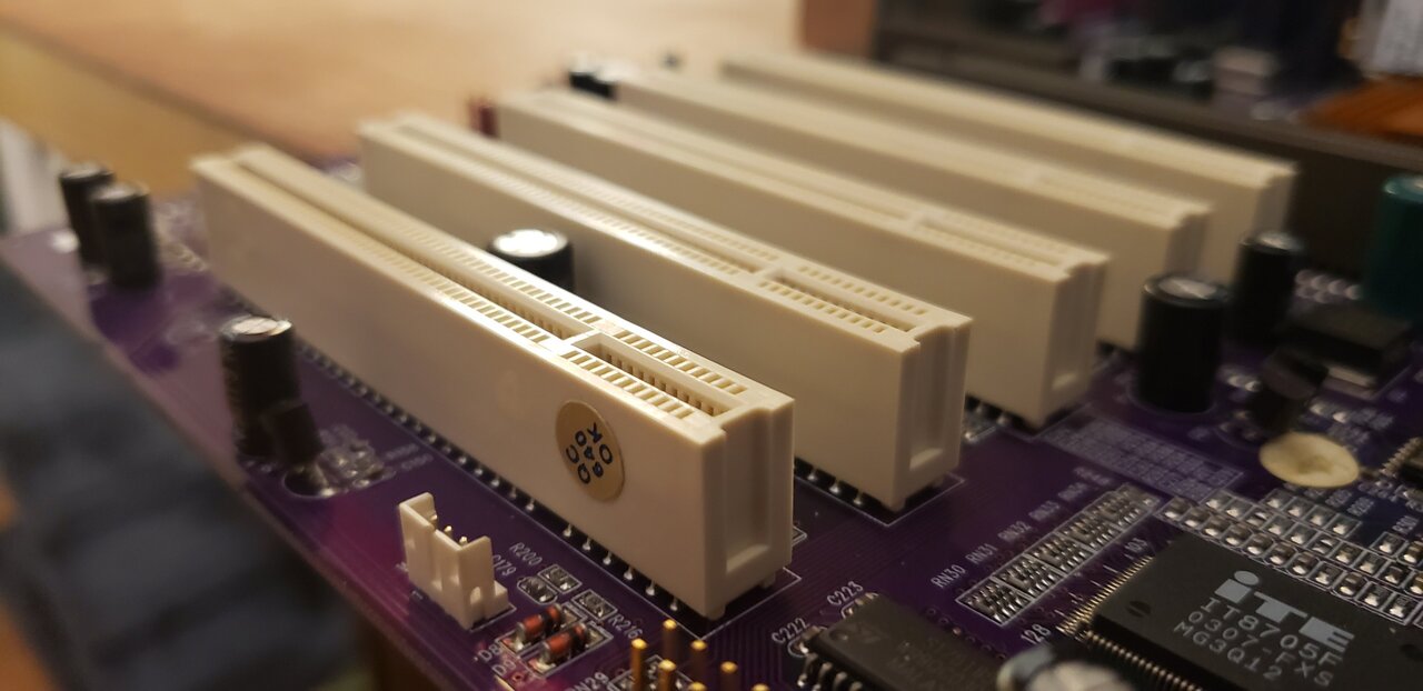

Asus A7V8X:
This board was donated by Diffident.  Definitely has bad caps on it, which I assumed it would so that's okay.
I would absolutely love to replace the ECS board with this one.  Much much better board for the 1100MHz Athlon.  If I can't find somebody to do it for me for a fee, I might attempt my luck at doing this one myself.  Worried about my hands being too unsteady to solder something so intricate, but I've been practicing..... 🙂

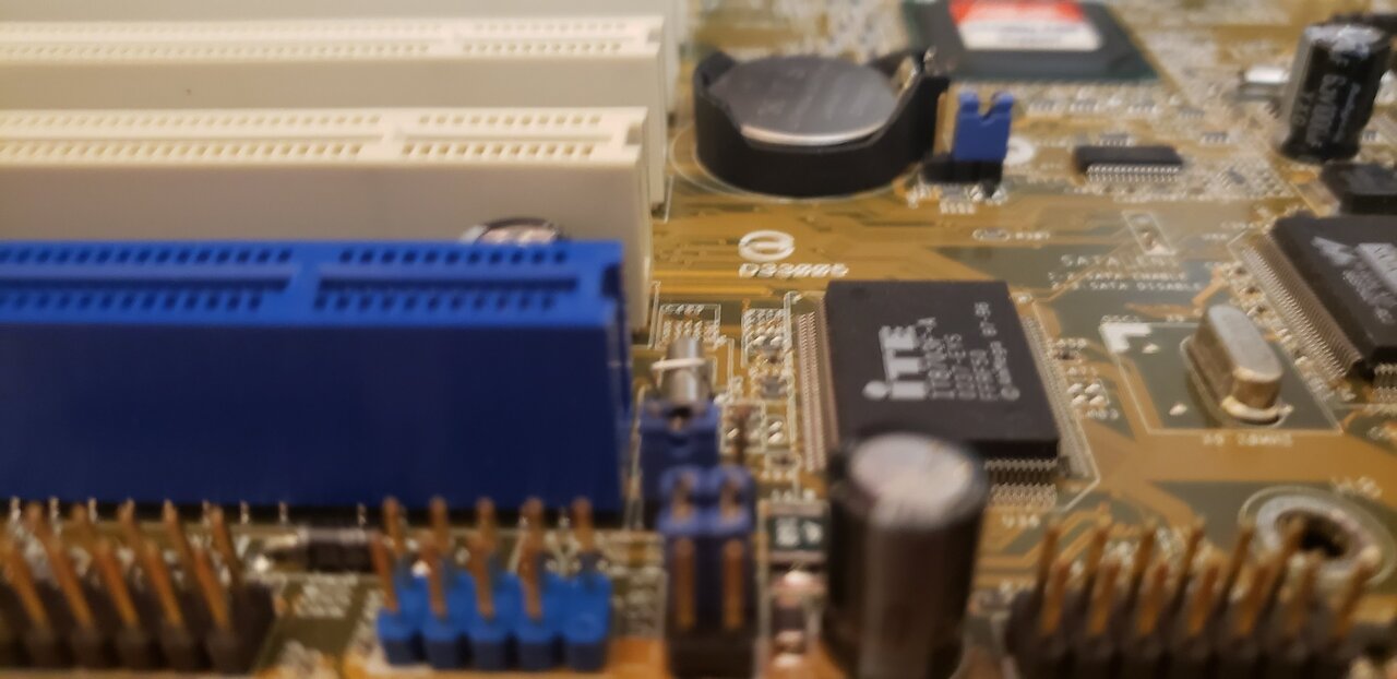

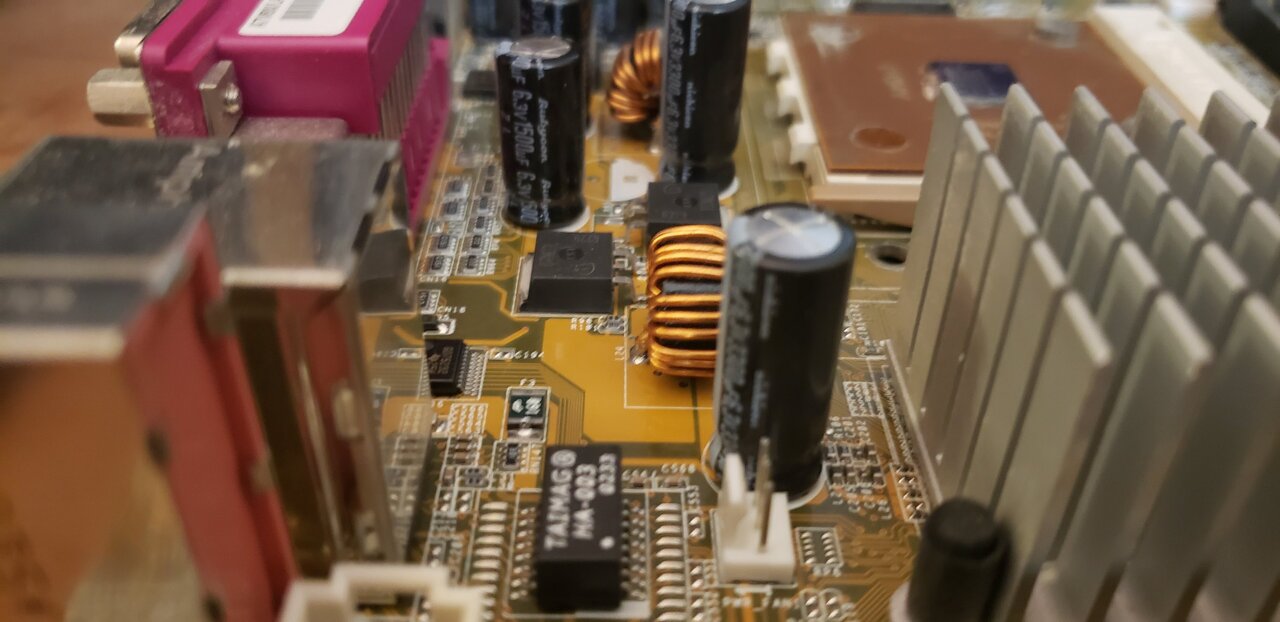

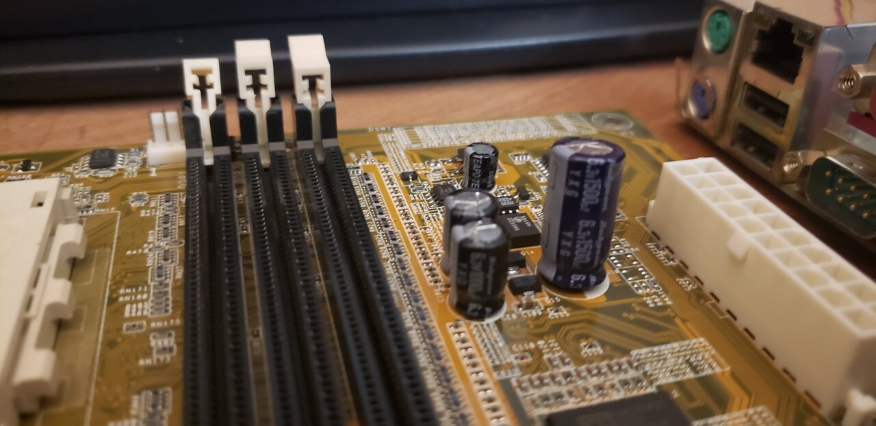

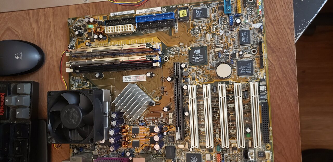

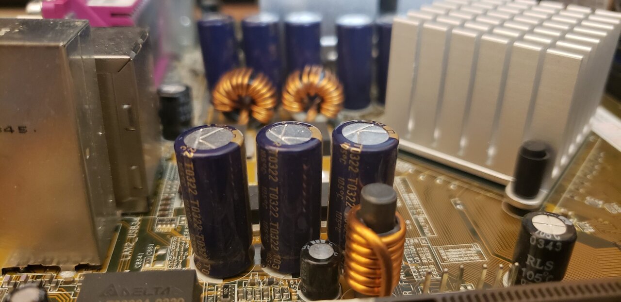

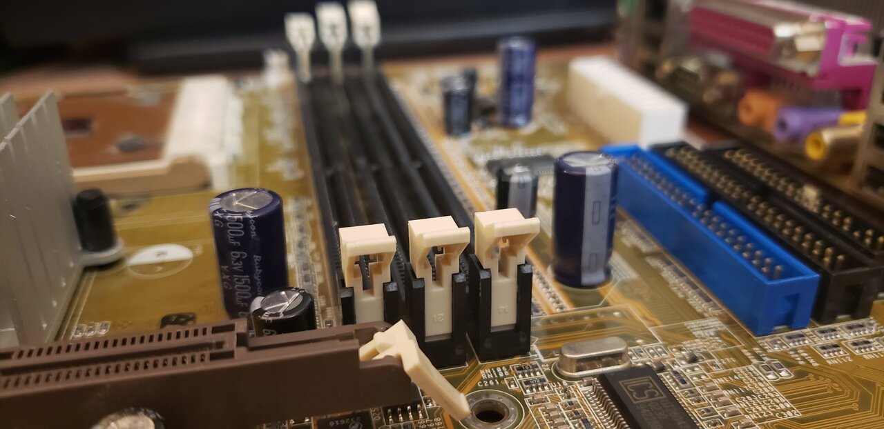

Asus A7N8X-E Rev 1.01:
Bought this board to use with the Athlon XP 2500+M that's in there too.  Was the absolute perfect combo purchase for the era.  This is the next build coming I'm pretty sure.  Unless somebody spots bad caps on it, which I hope not.
I have a bag full of 3.6V 3300mfu caps and that's useful for the Socket A boards. Two I'm seeing definitely need some caps replaced, one doesn't look bad but then again I'm not there looking at them.
The SLI has three I'm seeing in need (6.3V 850mfu) and I believe I got those here. The 32 SLI doesn't look to have any that's bad but again, I'm not there in person to look.
As long as a cap looks flat I'm not bothering it but if it even has a hint of swelling, may as well deal and be done with it.
As for the board you say has broken traces, I can look at that and if it's not too bad I can take a crack at that one and see if I can't "Frankenstein" it for you.
No promises but at this point with it's condition I don't see why not.

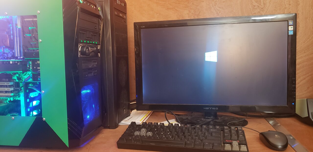

My Socket 939 rig that's functional now has Windows 7 on it, and I feel like a complete idiot.  This good A8N SLI board was showing the same exact signs of failure as the A8N32 SLI Deluxe, and the same as the A8N SLI Premium.  I figured out the problem, was PEBKAC.  Apparently, the good old trick of ONLY having your drive plugged in that you intend to install Windows to......that was the trick to making these work.  Any other drives connected (especially IDE when using SATA drives too), the machine won't boot from USB and install proper.  To get Windows / any OS to install via USB, you HAVE to have just the USB stick plugged in and your destination drive.  ALL other drives MUST be disconnected, otherwise it won't write the boot.ini properly or something (won't boot).  I knew this was a "thing" back then, but honestly I forgot it was a thing on 939.  I honestly didn't think I would run into these kinds of silly BIOS glitches till Socket A.
The machine DID function just fine on Windows 10 32bit, which was a surprise.  However, sadly, Windows 10 does NOT function very well on a dual core at all.  With all the background processes going on, the poor CPU was at 100% load 24/7 and it was an absolute nightmare to even try to use it to web browse because of that.  If this were a dual Socket 940 rig with 2 dual cores installed instead of just one, it would operate perfectly and probably be a wonderful daily driver.  Luckily Windows 7 doesn't exhibit those same problems.  I was just hoping that all of my "multicore" systems could run it, but nope....not duallies.
