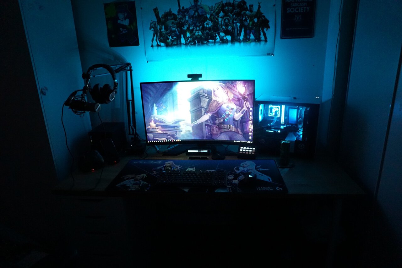

So, a while ago after my 5950X upgrade, i quite quickly noticed my temps were toasty. not worry toast but not where id like.
67-75C while loaded depending on game being played, with my fans cranked to max on all rads (only a 240 front intake and 120 push/pull exhaust out the back installed)
i started thinking to myself : i need a bigger case, to at least fit my second brand new 240 rad in (brand new EK rad still in the box) and get some more cooling performance.
current case is a butchered NZXT H210i (when i say butchered i so casually "removed" the rear fan grill honeycomb with a grinder and filed it to allow better radiator airflow)
id like something i can at LEAST fit my 2x 240s in (am open to buying a 360 or 2 if needed), still looks good, and maybe a vertical GPU mount because i want to cover empty space and not buy a new MB ( running on ITX) as im sure most of the recommended cases will be M-ATX or larger.
please leave your thoughts below, id like it to look decent, as it will be ontop of my desk next to the monitor. i have no current floor space avaliable. ill attach a current setup photo for reference.
