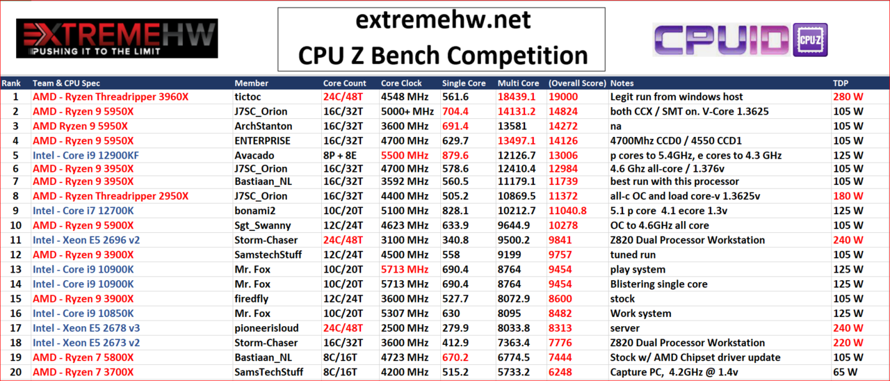

On 19/02/2022 at 14:01, Mr. Fox said:
Here is a new one when you get to it. 9454.4
So the chiller is back on. Tried to go for 5722MHz in the middle of the night after getting everything squared away and it crashed half way through the bench. Im going to blame less than ideal temps but we should have a cold snap later in the week. If I can get it down to 0*F I think I might have a fighting chance.

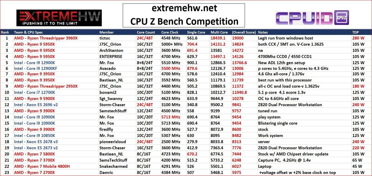

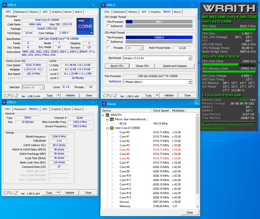

OK, here is a first try with the new hardware.
CPU: Intel Core i9-14900KS
CASE: Antec C8
CPU: Intel Core i9-13900KS
GPU: EVGA RTX 3090 Ti FTW3
PSU: Corsair RM1000e
...Nice ! First time I have seen CPUz single > 900 💪
What kind of full load PPT are we talking at those settings?
TDM
Thank you. Seems like a solid silicon sample.
I did not check in HWINFO64. In Cinebench R23 at 5.4GHz on P-cores, about 375W. Probably not quite that high in CPU-Z at 5.5GHz.
https://hwbot.org/submission/4943498_mr._fox_cinebench___r23_multi_core_with_benchmate_core_i9_12900k_30908_cb/

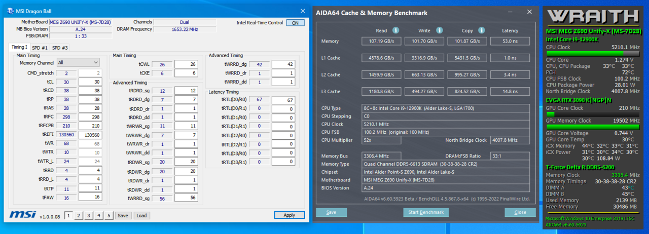

Looks like I got a good lottery ticket on the RAM and CPU IMC as well. I am only just now starting to tweak things. I have a ton of stuff to learn about Z690 overclocking and DDR5. Like going from Intel to Ryzen... or speaking a different language. These read/write/copy speeds remind me of my monster 7980XE benching days.
https://hwbot.org/submission/4943746_mr._fox_wprime___32m_with_benchmate_core_i9_12900k_1sec_532ms
https://hwbot.org/submission/4943767_mr._fox_wprime___1024m_with_benchmate_core_i9_12900k_37sec_90ms
