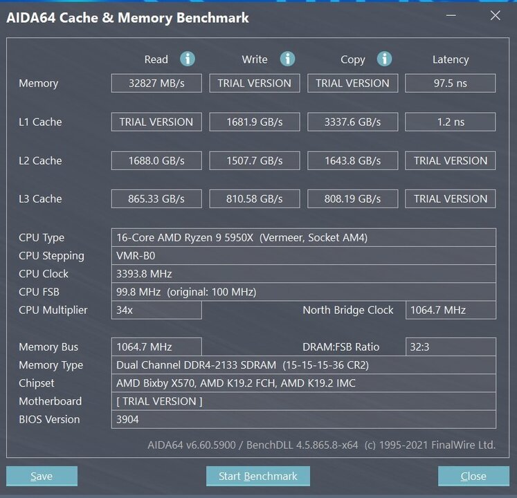

I'll try to describe the baseline test conditions.  DOCP off.  PBO off. Pretty much everything in the BIOS that looked like it might boost performance off.  The following background processes were running -> Samsung magician, Steam, Fan Control V101, Radeon Software, HWiNFO64 (sensors only).

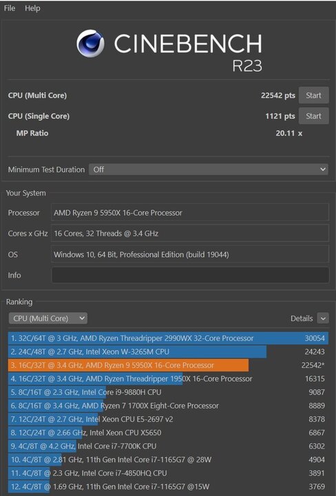

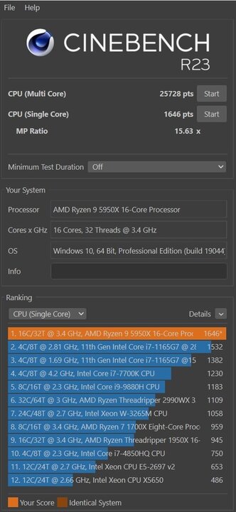

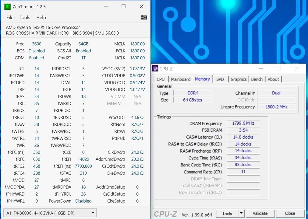

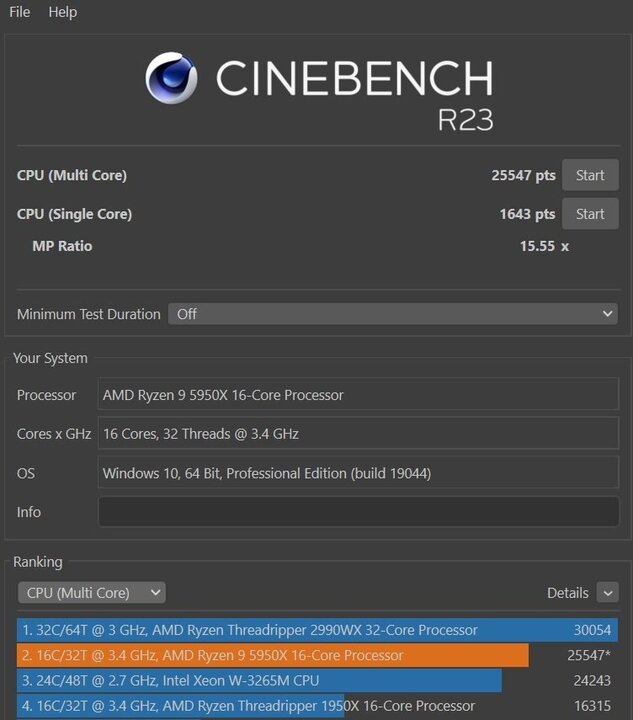

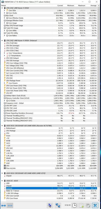

Round 2
Same conditions as before except DOCP is now enabled.  I honestly expect DOCP to have the single largest performance impact of any of the options available in the BIOS, but I've yet to create my spreadsheet for tracking % increases from one iteration to the next.
TDM
These initial tests have shown me that I don't actually have a good understanding of what DOCP is.  I had noticed that the CPU was limited to 3400mhz in the baseline test, but I didn't know that was in anyway tied to DOCP, which I had erroneously assumed was just an AMD version of XMP (I expected DOCP to only affect DRAM/fclk/etc rather than the maximum frequency of the CPU).
A summary of the changes in performance.  I'll add stability testing at a later stage in the process (likely after turning on the "base" PBO without curve optimizer).

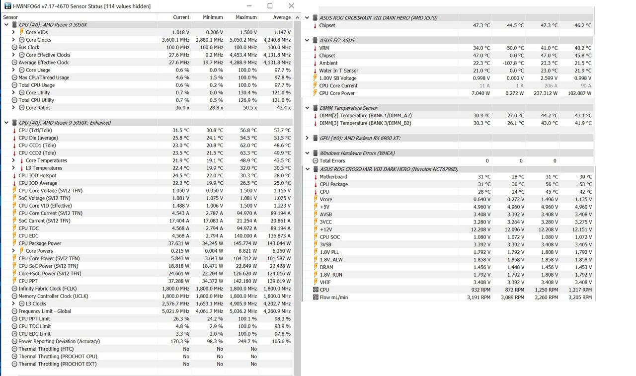

I had planned on further tweaking and testing last night, but I hit a snag.  Initially, I was going to rerun all of my original benchmarks with only 2 DIMM slots populated.  I wanted to see if asking a little less of the IMC had any effect on the performance at stock settings.  Also, I convinced myself that I will have more headroom running only two sticks for all the usual reasons plus the added benefit of better cooling of the RAM itself (some of my reading yesterday has led me to believe that keeping the RAM at 40 Celsius or lower is likely to pay dividends when trying to push a memory OC).
After removing the inner most stick from each channel (the MB manual indicates populating the 2nd and 4th slots is the preferred configuration when only 2 sticks are used) the system operated normally through all but my last benchmark (3DMark CPU profile).  When the test reached the 4-thread section, performance dropped down to comically low levels and stayed there through the duration of the test.  In fact, the system remained "gimped" after the test concluded.  Laggy in the extreme.
Here I failed to document the situation correctly.  I got flustered and focused on resolving the issue without bothering to track what I was doing.  I checked task manger to see if Windows was up to something in the background (not that I could see).  I restarted the system and initially things were normal.  I began to rerun the 3DMark bench and this time the system entered "borked" mode during the 8-thread section.  I restarted and looked things over in BIOS.  I booted into Windows and fired up CB R23.  I was blessed with a "mind-blowing" MC score of 3551...
I started thinking that maybe I had dislodged a stick of RAM while removing two of them.  Three RAM re-seats/restarts/borked benchmarks later I decided that wasn't the case.  It was "cool and dry" in my laboratory last night, and while I hadn't donned my anti-static wrist strap, I had been careful to ground myself right before touching anything in the system, but maybe not careful enough.  I say this because, removing the RAM from dimm B2 and replacing it with one of its fellows seems to have eliminated the issue.  I'm not convinced that this stick was defective from the factory because it had passed at least 4 iterations of memtest86 in this system prior to the creation of my original post.  I left the unit running AIDA64's generic "system stability" test overnight and things seemed correct when I left the house for work this morning.
I keep telling myself I'll need to be more "detached" when/if "hiccups" occur in the future 😬.  I'll try to stay calm and do a more thorough job of diagnosing/documenting the issue.  All the benchmarks that completed correctly before the issue manifested showed at most a marginal improvement that I think could be explained by a temperature variation in the testing area (about 1.5 Celsius cooler than previous).  I hope to post those results later today (those that I didn't inadvertently erase in my haste to "fix my baby").  I think I'm likely to run a battery of longer stability tests prior to making any further tweaks.  I plan to include OCCT/testmem5, generic prime95, and maybe prime95 through corecycler as well.  I'm considering adding geekbench5 as another general-purpose performance metric.

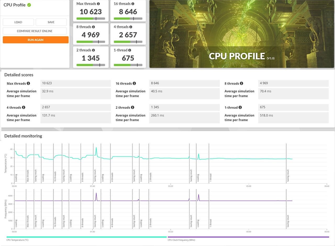

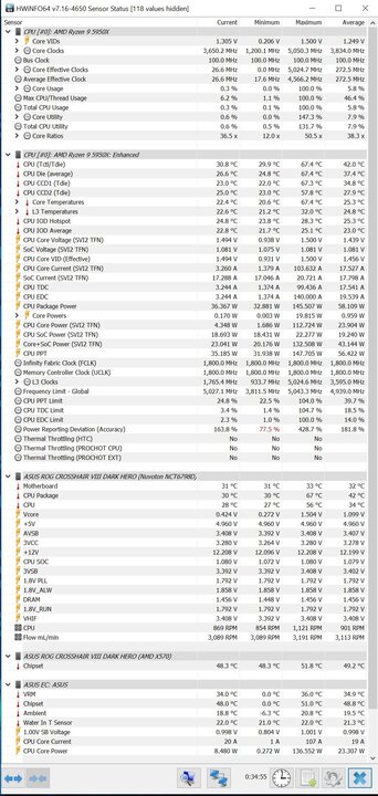

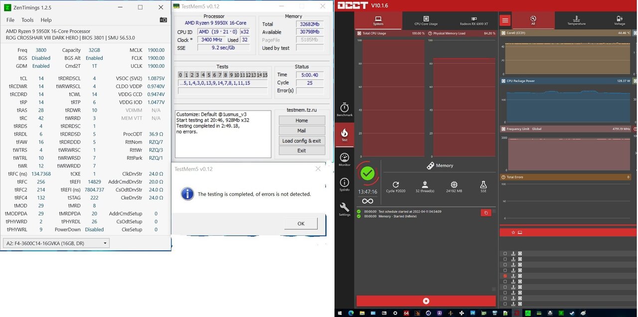

Some results from before the levy broke last night.
TDM

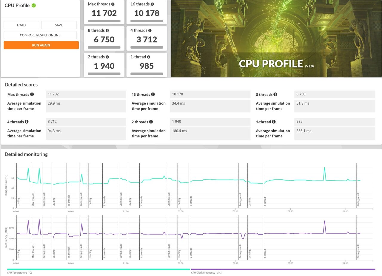

A 3DMark CPU Profile run completed after swapping RAM module located in dimm B2.
TDM
Summary.  No real performance changes detected by my test regimen.  Likely just some thermal and run to run variance even for the memory latency, I think.

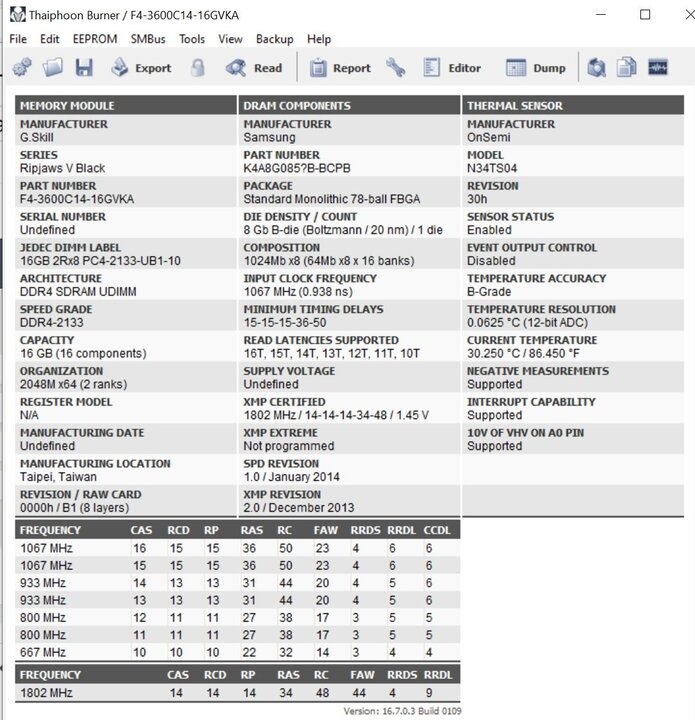

If I understand this correctly, my system is in "quad rank" mode with 2 modules of this RAM installed.  2 ranks per module * 2 modules installed = 4 ranks total.

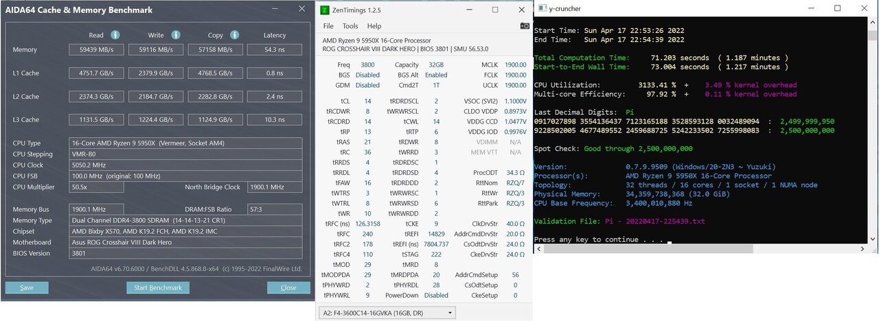

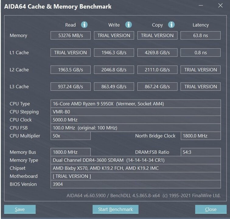

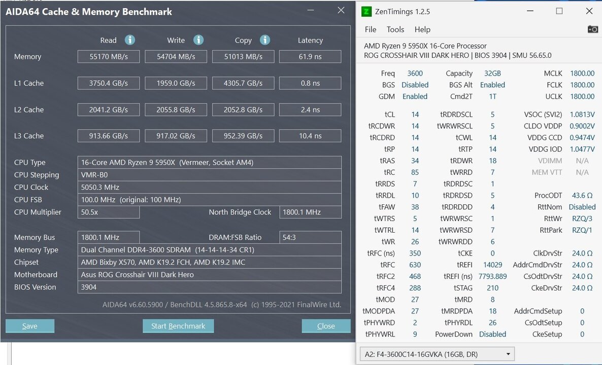

5 hours of Aida64's seemingly underwhelming "stability test" yielded the following (I used it because it was at hand and ready to run).  I think I'll make a few passes of their "cache & memory benchmark" to see if that slight reduction in memory latency might be real and then maybe some prime95 small fft with AVX for some additional assurance that things are like they should be.  I do find it interesting to note that my RAM exceeded 40 Celsius with only two modules installed while using my current fan control curve, but it's still running at the "DOCP" specified 1.45v.  I plan to see if there are gains to be had with a manual memory OC using 1.40v at some point in the future.
TDM
5 run average memory latency in Aida64 Cache & Memory benchmark = 62.04ns.  So possibly a genuine 2.5 to 3 percent improvement over the 64GB results, but this did not seem to translate into the scores from my stable of other benchmarks.
