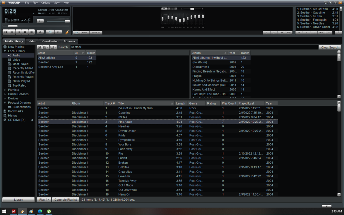

What I am reverting to for now is a program called winamp. Donno if you have used it, but the program is actually very useful. There is a built in EQ with a number of presets you can try out to dial in your speakers for your own preferences. When you say never boost frequencies, do you mean dont use pre-amp?

Very familiar with Winamp, it really whips the llama's ash. 😄

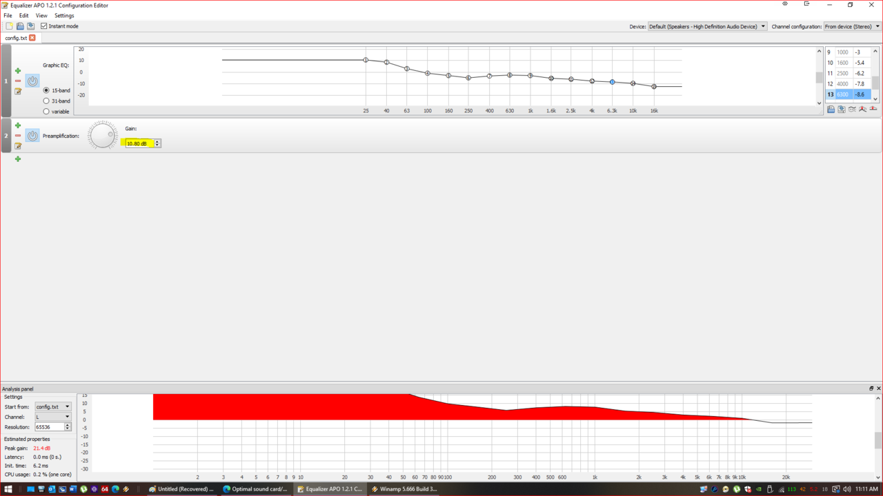

What I mean by don't boost, I mean leave the EQ at 0 for what you're wanting boosted, and turn everything else down.  For example, if you're wanting more bass, keep 60Hz and 31Hz at 0dB on the EQ, but turn all the rest of the EQ down to -6 or -12.  The preamp also should most of the time be at 0.  Of course it depends on the source, most of the stuff I listen to is bass heavy and recorded near clipping anyway.  Software is fine for EQ's.

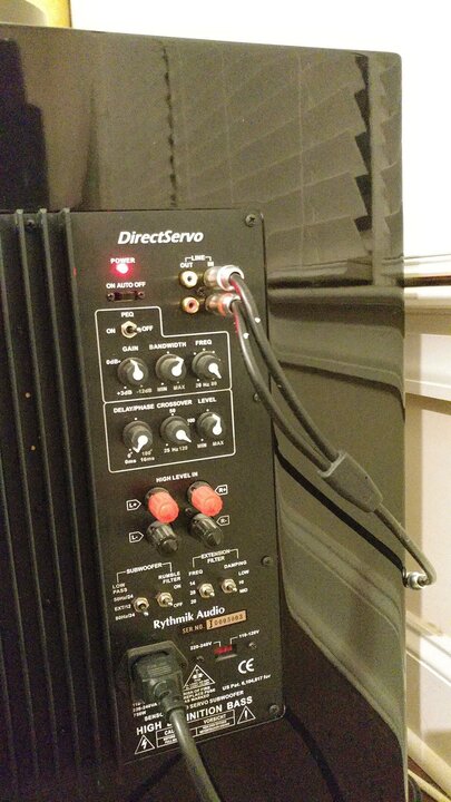

I’m not sure if a small third sub is going to offer much. The Z-5300 sub is just 6.5”. You’ll have a legitimate-sized sub at 10” from the Z-5500 that in theory should do the heavy lifting, a Z625 sub for which I can’t find any published specs, and the Z-5300 sub will be a toy. Also, since they’re all going to be tuned differently, I don’t expect them to be very harmonious together. There’s going to be an artificial bump starting at the bottom end of the weakest sub’s frequency range.
Aside from the tuning issues of three non-tunable subs, I don't think the small sub will be able to provide anything other than the ability to show off. A 15” sub is not only able to hit lower frequencies, but has more surface area than a 10”, 8”, and a 6.5” combined. Meet my servo-based 14 Hz end table. Forget about the pounding in your chest. The real pounding is between your ears.
20160914_002536.thumb.jpg.3a6ec99df990c66b0f166403d295a06c.jpg 20220210_004026.thumb.jpg.8e9686fa33d792e55029f7dddcc152ba.jpg

  3. EQ Apo is great, but use the Peace GUI for it as it makes it a much easier to use tool.
