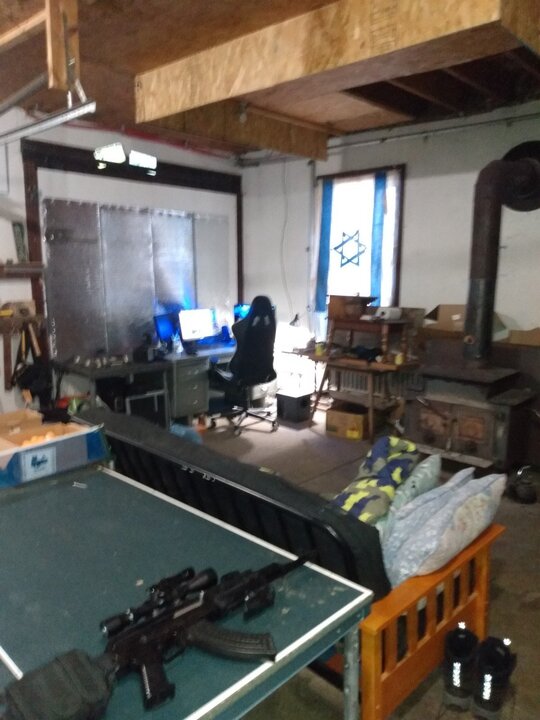

I'm trying to piece together the room between the picture above and the videos, but where is the "hood" you mentioned where you'll be mounting the left surround channel? I'm having a challenge figuring out what I'm looking at with the glare of the light in the picture. It took me a bit but I figured out the Israeli flag is covering the window. The way things are stacked along that wall behind your desk is also messing with my depth perception.
Yeah I'm having a hard time understanding where the rear channels are going too.
If that corner over there on the right side of your desk is an INSULATED corner (outside corner of the house), that'd be where I'd put the z5500 sub.  I'll bet if you move it there, on the floor, you wouldn't need the z625 set at all for the extra "oomph".  You can try firing it INTO the corner.  However big the port is in inches or centimeters, keep the entire enclosure at LEAST that distance away from whatever wall its firing into, more if you can (don't go too much, play with that distance).  You can also try firing the port towards you away from the wall.  Basically a 90* flip every time starting with the port firing backwards into whatever wall or corner, move it, test it, try again.  The port is where the noise is coming from.  If its firing downward then nevermind, won't matter lol.  But if you play with the 4 different directions it can face, in THAT corner (assuming its a good corner), I'll bet you'll find a super sweet spot and have a new love for the z5500 sub.  It still won't get low low, but it'll come more to life.  And I'll bet, at that point, you'd be more willing to lose the z625 set out of the equation.
Do that and get your front left and right put in the right spots, try out 2.1 mode to start, and see how you like how that sounds.  If you do, place the other 3 speakers properly and go from there.  Having them all in a basically mono configuration bouncing off the wall behind your monitor like that is only adding fill, not detail.  Details are how you get the music to come alive.

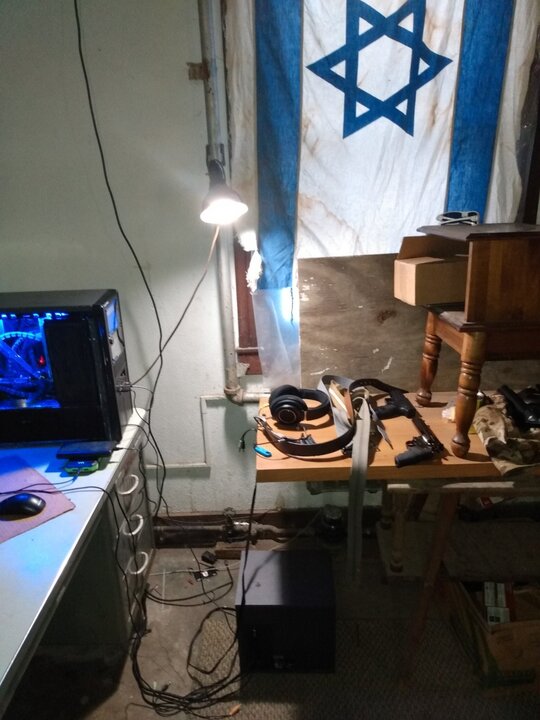

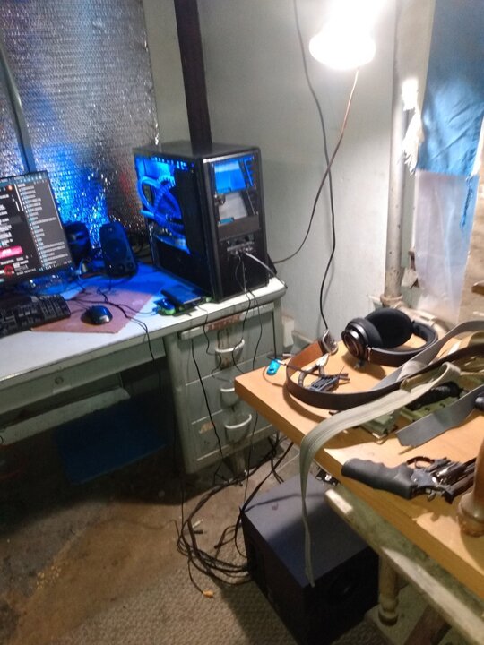

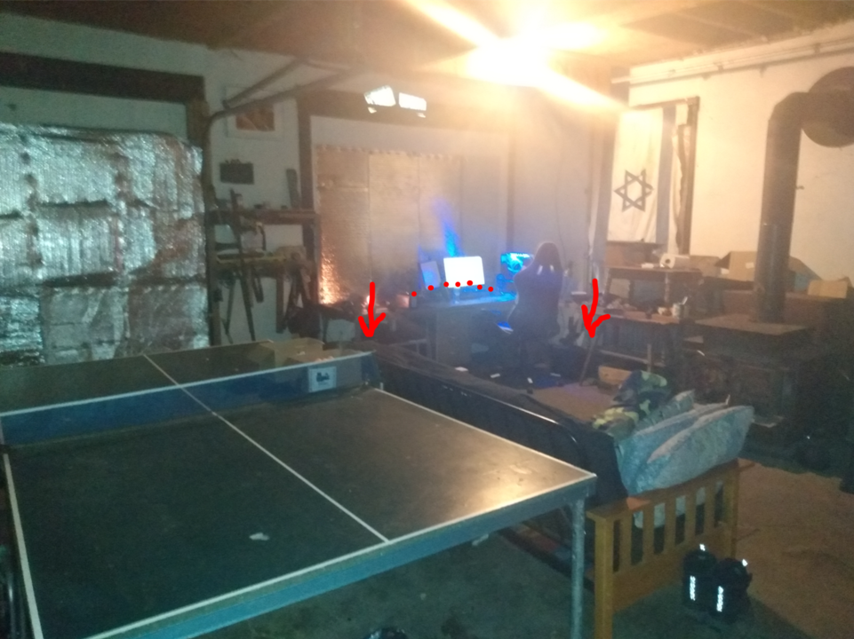

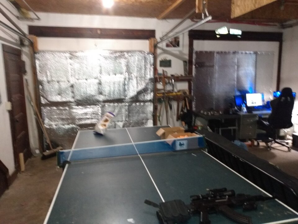

So I just snapped a couple more pictures. This is a ground floor area originally doubled as a two car garage and before that, for horses. In this iteration, you will see the two doors are now covered with silver reflective insulation to keep the heat in, so the wall straight ahead past my desk is where the doors are. The window sill to my right is where the Israeli flag hangs, and so the right rear speaker will be mounted to that window frame. The left rear speaker will be mounted from the hood itself. So not perfect symmetry but thats okay.
Yeah that first picture was bad, to much glare. These aren't much better but at least you can see the hood.
The window frame is wooden so I don't have to worry about destroying the sheetrock when mounting the right rear speaker.

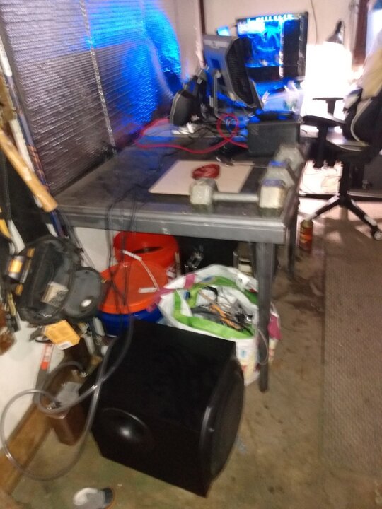

This picture is especially bad. But the z5500 woofer is in the foreground. the z625 is just beyond my chair, in the background.
Again both subs are visible in this shot.IMG_20220213_073705876.thumb.jpg.d1da0741caea2960897c166147cbe0de.jpg
The front of the house is obviously on this side, you can just see the hood coming into view in the far right hand corner of the screen. IMG_20220213_073647500.thumb.jpg.e2c7e0002c6faf146848d9cd35ba21df.jpg
A better shot of the hood itself.

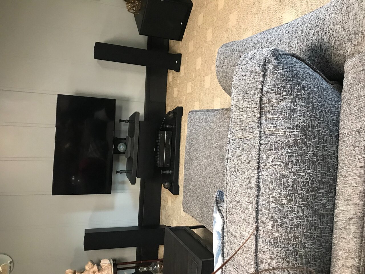

Heres a few pics of mine.  I cant get them to be right side up no matter configuration in folder.
