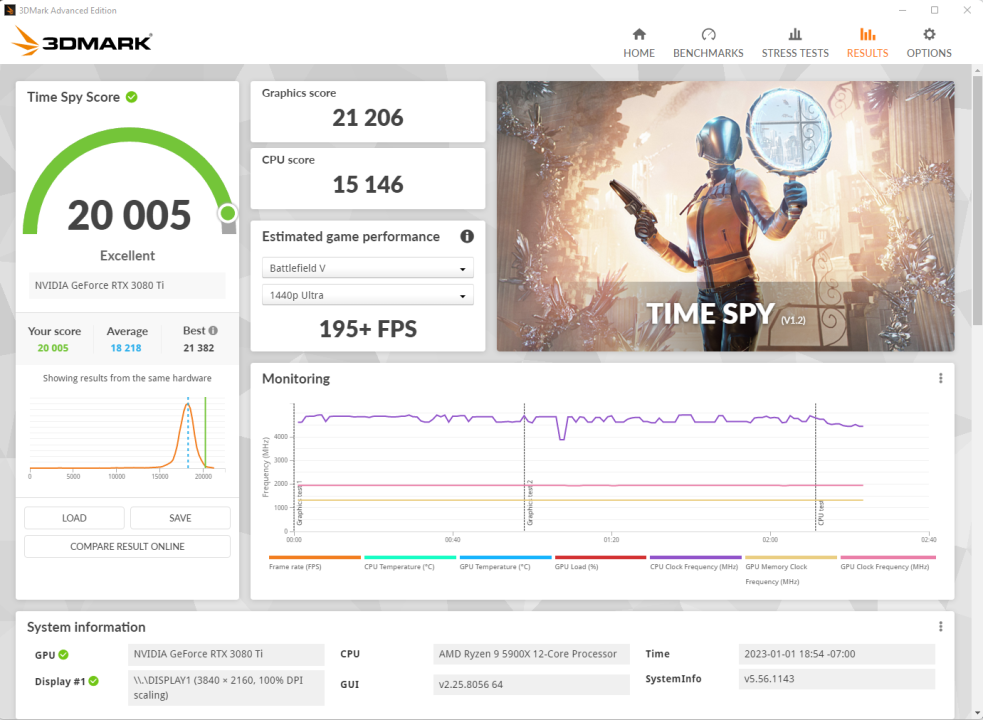

So was going to submit a Time Spy score on HWBot, but after filling out the form, says "413 Request Entity Too Large" - something you've seen before @Avacado?

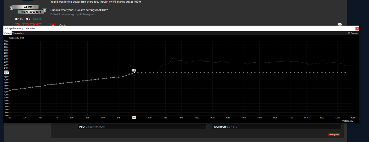

Got to work on the CPU some more. The 3080 Ti is easily running +120 to the Core clock and +1000 to the memory clock. May see if I can push it some more.
I meant +120 not +100
Got to work on the CPU some more. The 3080 Ti is easily running +100 to the Core clock and +1000 to the memory clock. May see if I can push it some more.
Yes, that normally occurs when you try to upload screenshots with a file size too large. Try resizing images to 25% of their original value.
