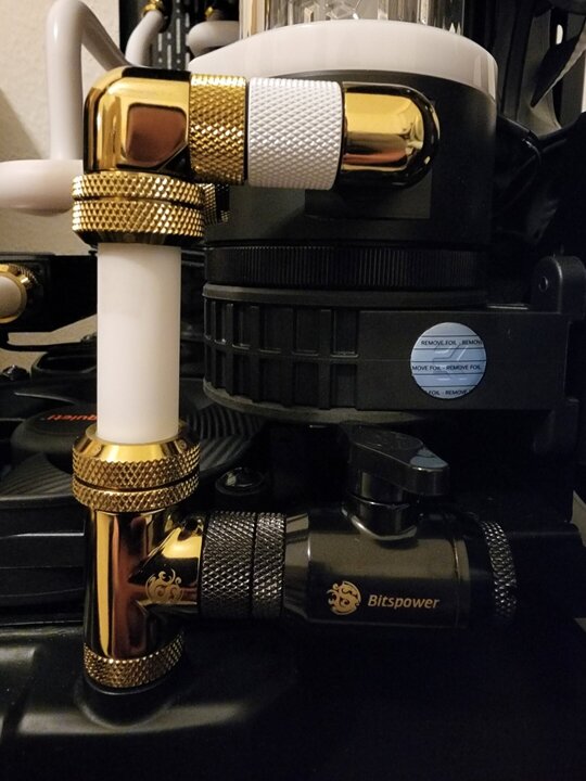

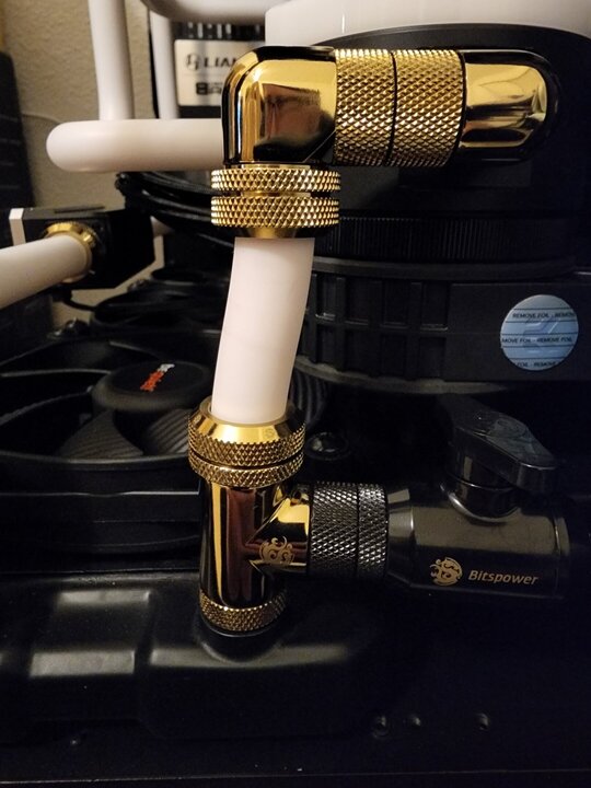

Hmm wish they made an extension that was just slightly bigger. Wasn't quite long enough. Had to put a very slight bend to offset the straight tube run. Not the most elegant solution, but will work for now.
I also went ahead and leak tested. I had the EK tester and read it was wrong with where they put the "green zone" on it (typical EK... 🙃 ) and attached to where my drain port is and measured it holding at 0.5 bar for 1 hour. It didn't drop even a little bit, so guessing that means its good to go. Anything else I should do with that?
Anyway, plan to fill it up tomorrow as its late and I also want to redo a couple cable runs in the back.
If it bothers you but you don't want to plug it apart again at this stage, you might consider putting some  matt black plastic around that connecting tube - or 'dress it' with a much bigger outer black plastic tube or even sphere for an optical illusion, sort of...
Forgot to answer your second question. You should be FINE with 0.5 Bar held for an hour. I usually go extra cautious at 0.75-1 Bar. Even if there was a very slow leak like losing 0.2 bar from 0.75 in an hour, it still should be fine. Air easily escapes faster and is less dense than water/coolant. I have filled a few complicated loops with very minimal "Air" leaks and had no problems.

This was bugging me and I realized my error. They did make a bigger extension, what I should have ordered was the 15mm instead of the 10mm. So I opted to do a Micro Center run. They don't carry any of the fittings in the brass/gold finish, but I figured let's see what a white extension does for it. I don't know, what do you think? I think it at least works for now.

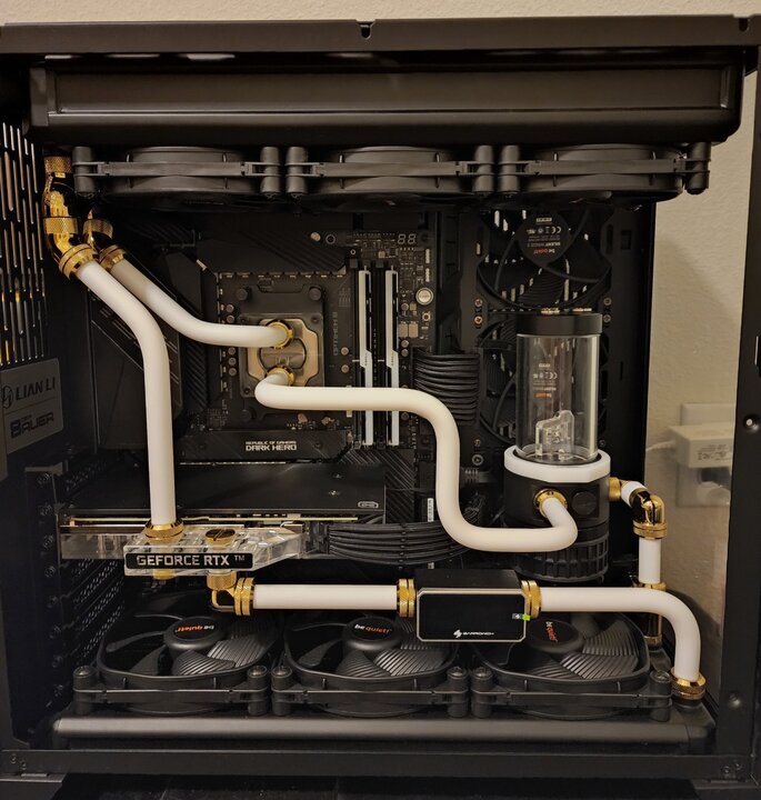

Anyway, I did a little more cable work in the back to help with the 12-pin Nvidia extension. I also added 4 cable combs to it to help keep it in check. I think it helped a ton.
Anyway, here is the completed loop. I may try a different orientation in the future, but for now, I think this ended up alright for a first attempt at hard line. I am unsure if I would ever do hard line again to be honest. But glad I gave it a try.
That now looks fantastic - great job !
Thanks! Yeah that other way was bothering me, so this will work for now.
