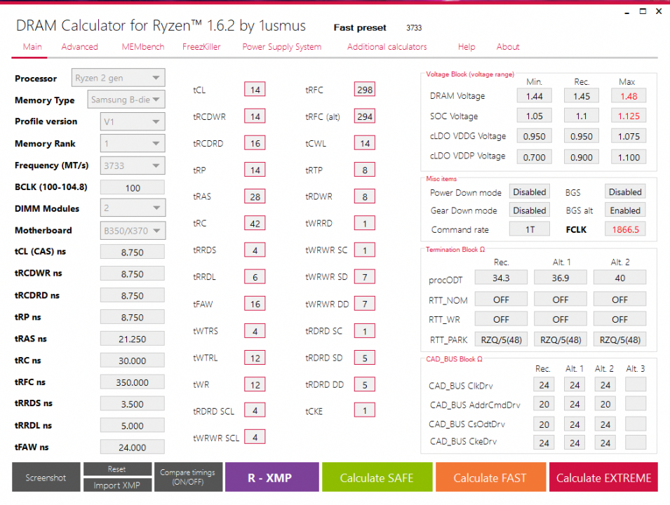

I tried up to 1.25v VDD_SOC for 1900MHz Fabric clock and 3800MHz memory and it's a no go. I fail very early in the boot process with an 07 post code.
However, it seems to do 3733/1866 fine, and the Ryzen DRAM Calculator does have a set of "Fast" timings for 3733MHz with primary timings at 14. So I may be able to try that angle. Though, those settings never worked on my 3900x.

I've found the Ryzen DRAM Calculator to not really work for Zen 3. I don't think they ever updated it after Zen 2.
Actually, it does work for Zen 3 however the naming they use is not in line with what everyone else uses. They call Zen 2000 series "Zen+" and Zen 3000 series "Ryzen 2nd gen" in the drop-down box for CPU selection. The settings it gave me worked great with my 3900x to hit 3800/1900 and those settings still work with my 5900x, except it won't do 1900MHz fclk. On OCN in the Ryzen owners club and other threads people were posting screenshots and using it heavily when I first got my Zen 3 setup in 2019. You are correct that it has not been updated for Zen 3+ (5000 series) though.
