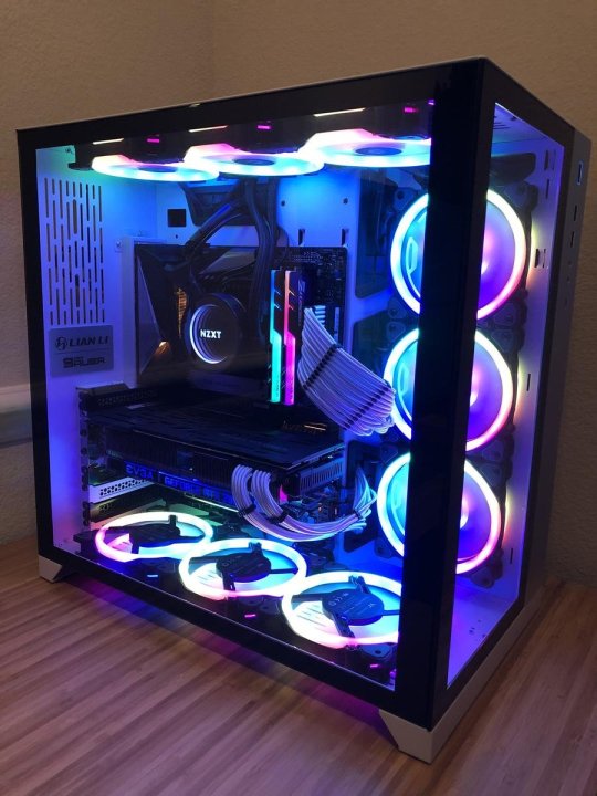

One of my old builds (The White Kraken (2019) by chrisjmartini - Intel Core i9-9900K, GeForce RTX 2080 Ti, Lian Li PC-O11 Dynamic ATX Full Tower - PCPartPicker) is in need of an upgrade to stretch it's life expectancy 2 or 3 more years. I have already decided that upgrading the gpu or cpu doesn't make sense as the board is a z390 and the gpu and cpu are already maxxed out (i9 9900k) for this configuration. Any newer GPU would suffer a bottleneck due to the PCIe version and other limitations. I have been building PCs for over 25 years but have never tried liquid cooling. My intent is to dip my toe into liquid cooling that GPU (EVGA RTX 2080 ti XC Ultra Gaming). The CPU already has an AIO liquid cooler installed that is good enough and should last a few more years. So i'm only considering the GPU cooling loop for now. I want the cooling to be optimized to push the boost clock and memory of the GPU as high as possible. The stock dual fan/heatsink on this card is already excellent, but likely no match for a higher end liquid cooling solution. Also of note: This PC has 12 fans! So I was looking to simply repurpose and not add any additional fans. Until someone commented that my fans have a static pressure value that is too low (1.4mm) for push pull on a decent radiator.
I have done a ton of research preparing for this but I am still a little unsure as to which radiator to use. I need some thoughtful suggestions from experienced liquid cooling gurus. The basic parts list so far (not counting the fittings & bending kit):
Suggestions on what 360mm radiator to use?
