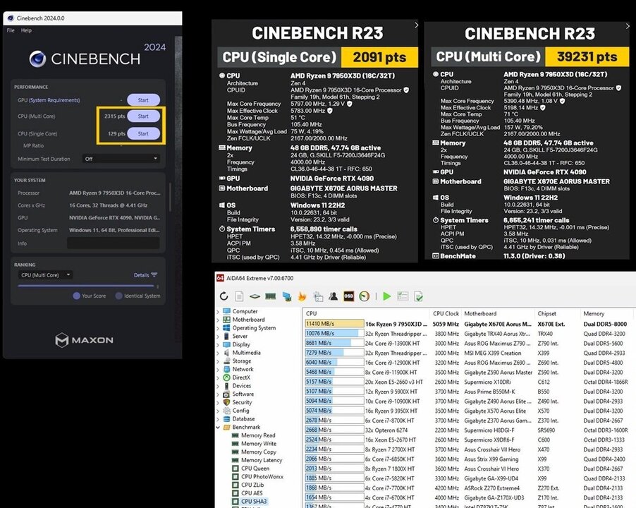

When I set my 7950X3D up for CO (following RAM oc and stability testing first), I used several benches but 3DM CPU profile combined with SMU-in-Windows CO adjustments helped, in addition to y-cruncher, Linpack, Aida, OCCT and other such tools. 3DM CPU profiles does sequential testing, starting with 'max' threads, then 16,8,4,2 and 1 thread. The 4,2 and 1 thread settle on your fastest cores and often, those have a bit too optimistic CO.
I now have a perfectly stable set of profiles for standard bclk (=100), custom bclk and also eclk...the eclk carries no additional per-core CO beyond the Aorus 90L5 PBO enhancement I use for all profiles.
So are you running 3DM CPU Profiles in conjunction with OCCT/Other benching tools ? When I say in conjunction, I mean running the benches at the same time.
...no, not simultaneously but sequentially. BTW, Aida is also useful, ie. SHA3 (tough) and FPU Julia. The Aida cache / memory bench helps to idea overly optimistic CO values as well, especially on CCD1 / fastest cores.

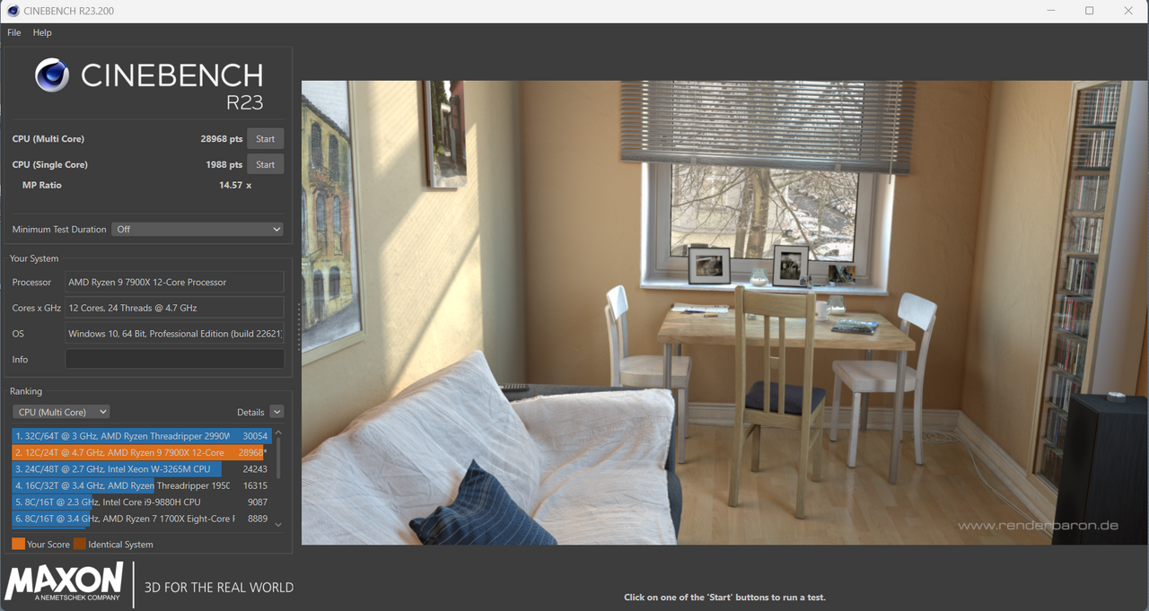

Well, it seems like its performing properly.....and better than a 5800x. 🙂

...Benching my new fav memory setting image.gif.74e5dab3915e136dd827a86863c4376b.gif: DDR5 8000+ CL 34-45-45-45-39...managed to get Y-Cruncher into the 13.3s, 7Zip to 254.8k mips and CineR24 multi to 2320, among other benches. For some Benchmate tests, I'll try 1:1 CL30 6400 or CL2? 6200 instead. BTW, ever heard of 2x 24 GB A-die (high speed, advertised as A-die) ? Dom doesn't think so - your thoughts ?
