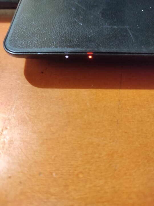

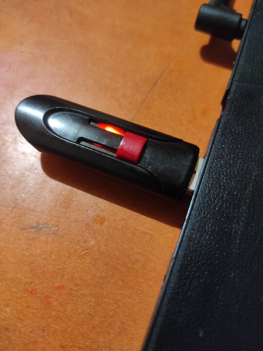

Hi Chris, it's me again, I used the files you shared me and I pressed FN+R and then the power button, but there seems to be a problem, my laptop doesn't give any video of the process about the recovery procedure, also my usb LED indicator is blinking and one of the LEDs of the laptop (The right one) is also blinking in orange( I think that's when the USB is working, because up in the topic you wrote about it ), do you know any way to display the screen on another monitor? Because my laptop can't display video of the recovery procedure. ( I uploaded the photos of the led indicators both the USB and the laptop )
  • Solution
Congratulations on fixing it buddy!  you're welcome.
