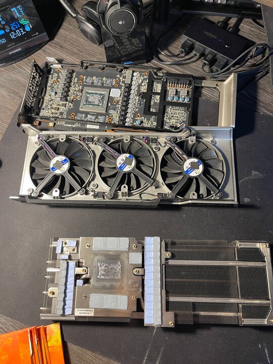

I forgot to get more pictures of the replacing at it self, as i was already to inpatient and wanted to see the results ASAP 😄  For this reason i could not do any kind of reviews, I'm not patient enough lol...  Respect to all reviewers on this place 🙂
E403F572-B5DF-4A94-ABBD-6F8F52F1BA9D.thumb.jpeg.67a6695d8ca93bae82e0c51a117440d9.jpeg81E98AEC-0872-4230-B3F4-8EA94BDFD7A6.thumb.jpeg.f594880eb00eef7ec4b6976d08c0a394.jpeg

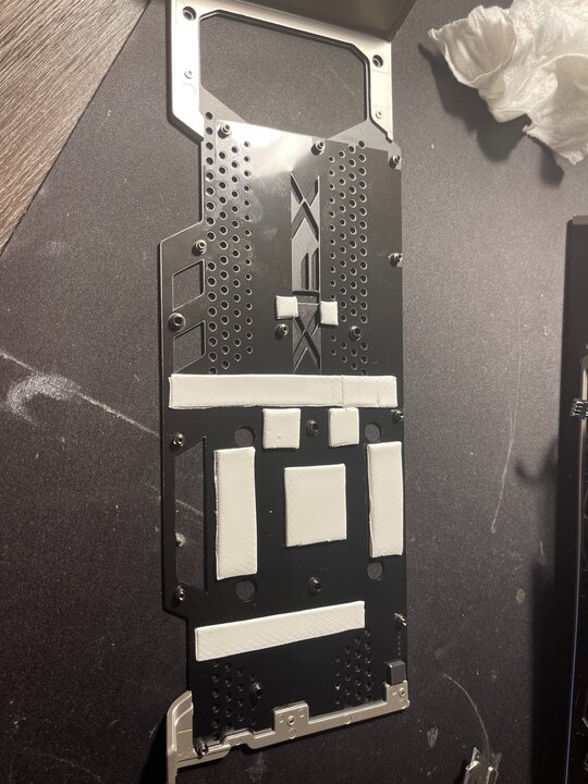

Just to explain, i got the following information's from XFX about the pads thickness:
Front:
VRM 1.5mm , 2mm
VRAM 1mm
Back
VRM 1.5 mm
GPU, VRAM 3mm

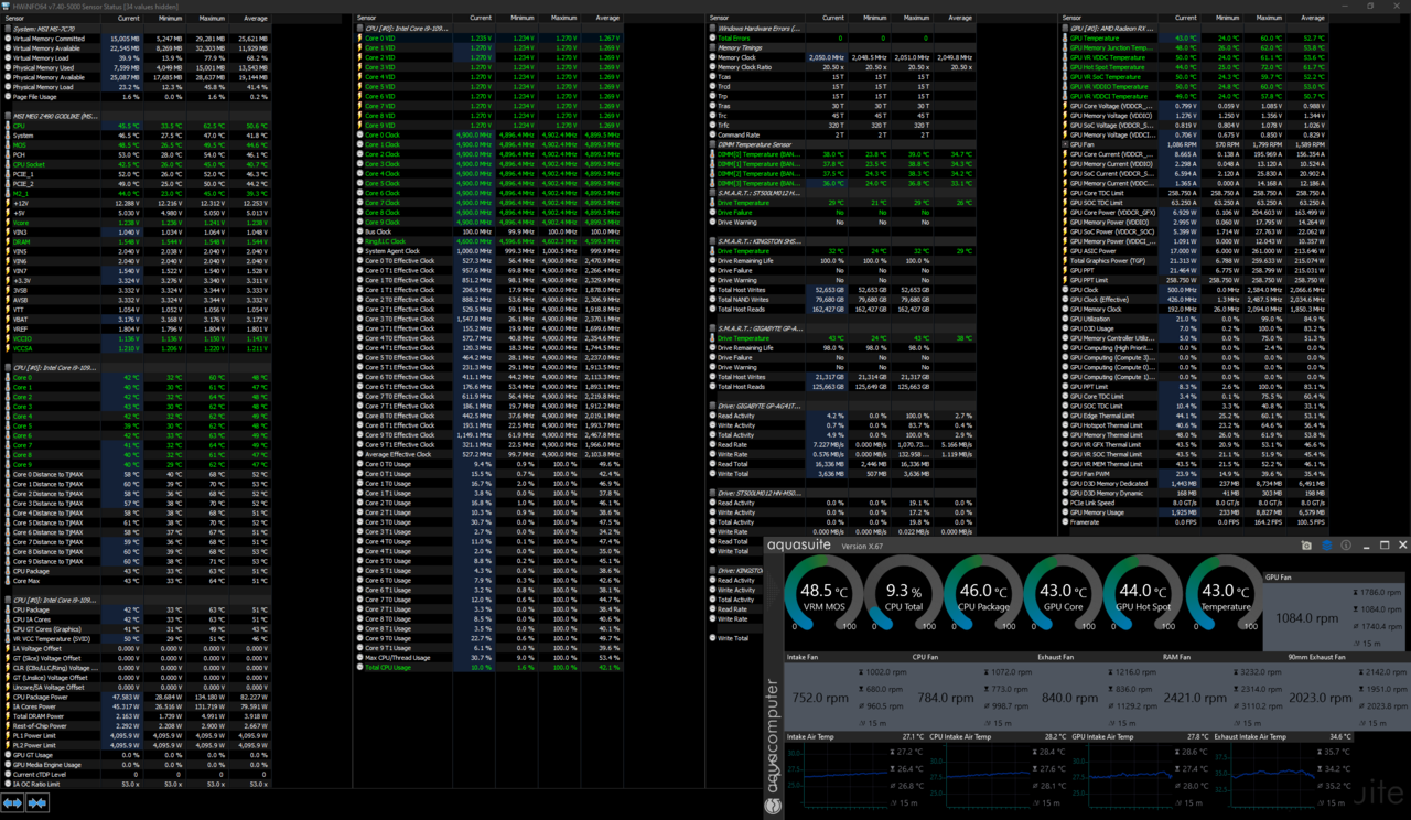

I as well repasted the GPU about 6-8 months ago with LM and as you can see there is no corrosion on the cooler at all which means its copper 😛  Anyway here are the results after the exchange of the pads:
GPU Temp: 59 C
GPU Memory Junction: 72 C
GPU Hot Spot: 71 C

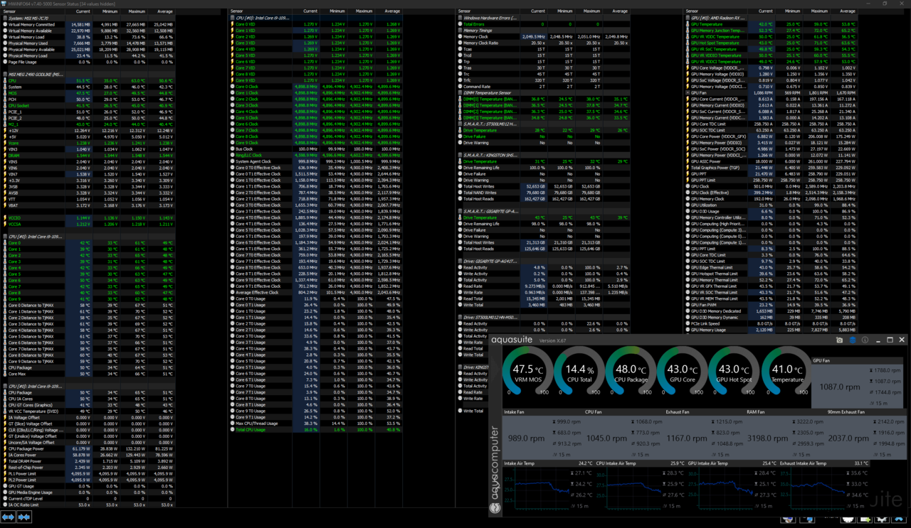

Compared after the test the results and noticed that the GPU Memory Junction temp increased by 8 degrees while all other temps were down by around 4 degrees on the GPU Hot Spot and  2 degrees on the rest. So i just took it appart and could see that on the Memory modules are no imprints on the Pads. So i just replaced the original 1mm thickness by 1,5mm pads and tested it again.
GPU Temp: 60 C
GPU Memory Junction: 62 C
GPU Hot Spot: 72 C
This time the temps looked OK and the final result is basically 2 - 2,4 degrees on the Memory and VRM... The decrease on the GPU hot spot could be a result of dipping a bit more LM on the cooler and I guess it has now a better contact with the chip...
