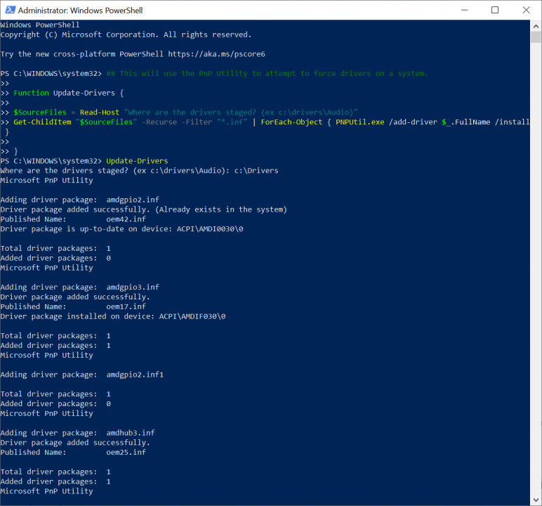

Forcing Drivers
Sometimes a device is not officially supported by Windows 10, and if you just download and try to run the .exe, Windows tells you to get rekkd. We had this happen a lot with old printers, so I learned how to use the PnP Utility. I needed to do this for my old Alienware 17 R2 (2015),  as the drivers from dell were causing USB glitches. I downloaded the H87 chipset drivers directly from Intel, and had to force them with this method, and the issues went away!
## This will use the PnP Utility to attempt to force drivers on a system.
Function Update-Drivers {
$SourceFiles = Read-Host "Where are the drivers staged? (ex c:\drivers\Audio)"
Get-ChildItem "$SourceFiles" -Recurse -Filter "*.inf" | ForEach-Object { PNPUtil.exe /add-driver $_.FullName /install }

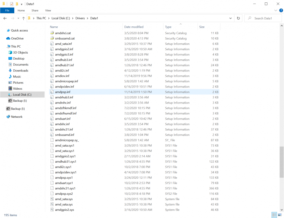

First, we need to download our drivers. Luckily, I have a great test I can run, a new chipset driver came out for my board. Sure, it will work with normal methods, but I'll use it as proof of concept.
Once you download your drivers, extract the files. I extracted them to C:\Drivers. Sometimes you download a .zip, extract it, and there's a .exe file. Guess what? Extract it. You can use 7-zip or WinZip, right click the .exe and extract it.
The AMD chipset drivers this time were a little bit of a pain, I found where the actual drivers were placed with the self-extractor, so I'll use that.
C:\AMD\Chipset_Driver_Installer\AMD_Chipset_Drivers\AMD_Chipset_Drivers
There was a file called Data1.cab. That's where the .inf files I was looking for were, and that's all I need. So now I have the files in C:\Driversdriverfiles.thumb.png.23424414ff59ff9cff575de1e14eabec.png
Now that my drivers are staged, I can run the script. PowerShell should be opened as admin.
First, we see that when you run the script, it stores what's called a function in your PowerShell session, so you can simply call on the function repeatedly if needed, without having to write or paste the entire script again. I'll go into PowerShell profiles at some point to show how you can keep all functions available every time you open PowerShell.
Next, I call the function. It asked where the files are, so I input C:\Drivers, and the PnP Toolkit installed all I needed, without extra garbage! Clean drivers, less crap. Some weren't required, so they didn't all install. But there you have it! Fun fact, the entirety of the actual files I needed for the chipset was less than 6 MB.
