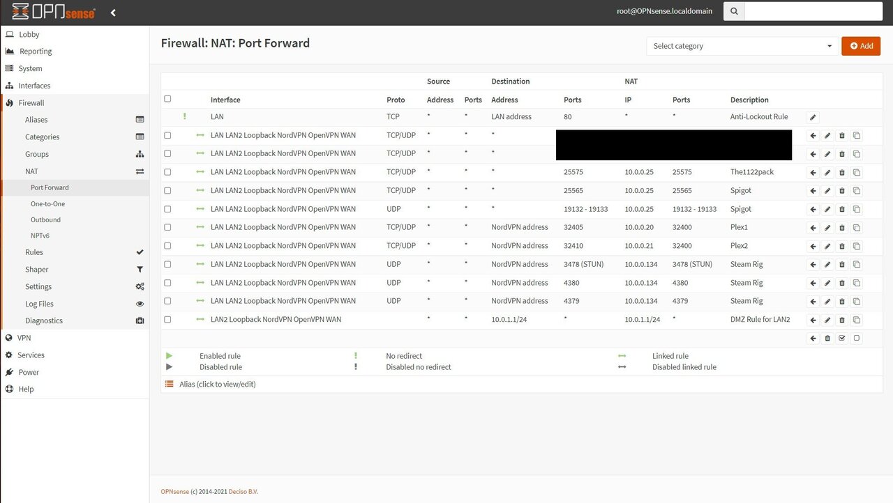

Do you have a screenshot of a configuration page for one of your port forwards ?
That is how my setup is, yes.  LAN1 (VPN) is my normal LAN where daily use goes on because VPN.  LAN 2 literally just goes to a seperate wireless AP (old router) and is not on the VPN, no.  Firewall, best as I can tell is 100% disabled on it.
The DNS service I'm using is an entirely different bug of some kind of my missetup I'm sure.  Of course anything I'm trying to connect to via the DNS is going to be through the VPN'ed LAN1 network.  I can connect through the DNS on my LAN2 somehow, but actually over the internet the DNS cannot be seen.
Here's a screenshot of my port forwarding page under NAT's, which I believe is the correct spot here.  I tried swapping the ports around as well and didn't seem to do any good.  Ironically Plex still works outside the home, but only via transcoding.  Says I lack a direct connection.  I assume ports, but I suppose could be VPN related there.
EDIT:  The blacked out ones are RDP connections that do not work outside of the home but should.  The Minecraft servers don't work outside of the home either.  And the ports for "Steam Rig" were just me attempting to get Steam voice chat to work over the VPN, which it never did work.
You don't need to have 2 LAN's to split VPN and WAN traffic, you can use Firewall rules to set what device you want to go through the WAN or the VPN.

Well, I wasn't originally trying to go straight to WAN, I was just simply trying to port forward through the VPN.  When that didn't work, I setup the second LAN as a backup idea so I could still game on my main rig.  It just leaves my entire server behind the firewall, and not accessible outside of the house.

You will need to segregate your clients in some sort of way (there are a multitude of ways to accomplish this, all have their up sides and down sides.) Then modify your outbound rules to send the traffic not meant for your local networks out the VPN's assigned gateway.
Port forwarding as you are thinking probably will not work, most vpn services will be blocking ALL traffic IN at their end and you have no control of that, so port forwarding though the vpn service isn't really going to work. If you want to host something real world you will have to port forward to your real WAN address.
To be honest, i think you may be mistaking the need of port forwarding for the reason of improper outbound rules. I take it you are having a hard time getting traffic to pass out the VPN connection as most traffic is trying to take the path of the standard WAN?
Another note, when you do get your issues above sorted out then there is still the issue of DNS leaks. By default, when making a DNS request it will ask all upstream dns servers to respond to the query (including your ones on the WAN port). Effectively you wont be fully routing all requests and traffic out the VPN. You will have to play with the DNS forwarder or resolver configurations (again different ways to get it done and they all have their ups and downs.) The easiest way i can think of to get around this is configure the clients you wish to use the VPN only, to look directly at the VPN's dns servers instead of your local opnsense dns forwarder.
