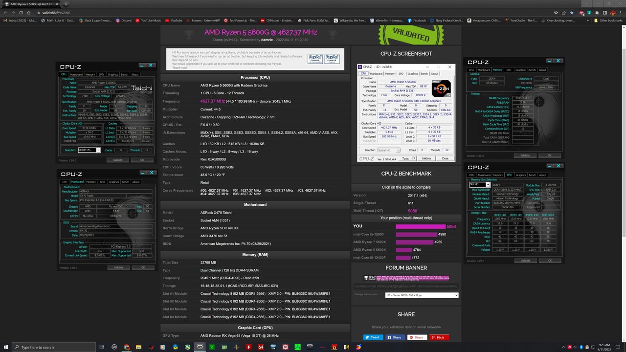

Ok so I ironed out a very good stable 24/7 overclock on this Ryzen 5600G. I'm still working on max bench overclock, but this is perfectly stable with 104 base clock + PBO. Interesting that it beats the new i5.
VALID.X86.FR
[xv2vk6] Validated Dump by damric (2022-04-11 16:20:49) - MB: ASRock X470 Taichi - RAM: 32768 MB
