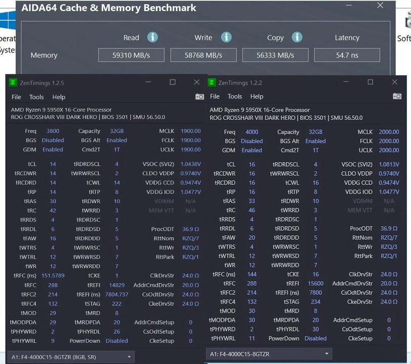

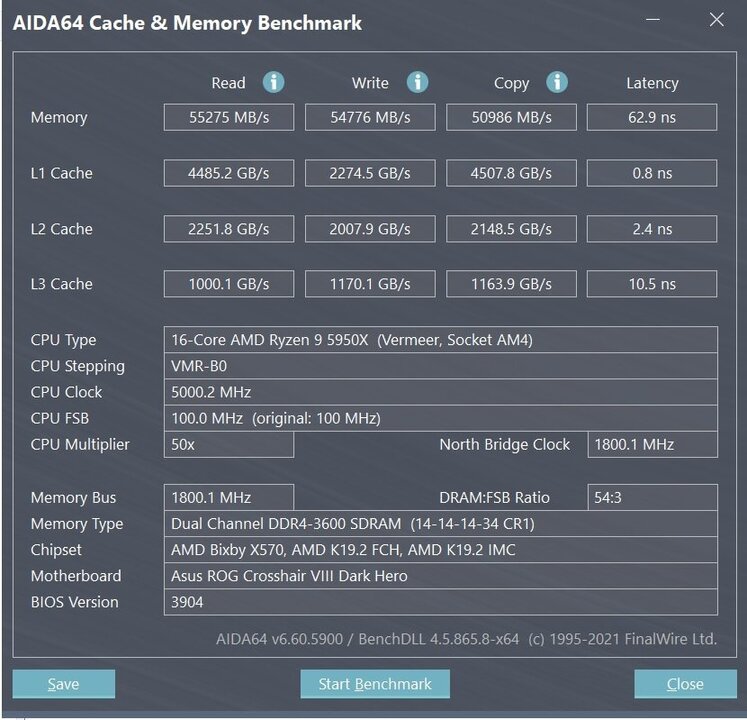

FYI, per HardwareUnboxed vid, 4 sticks of Dual Rank > 2 sticks of Dual Rank, but not that drastic a difference.
Re. your Aida latency...there might still be some room (ignore the ZenTimings IF2000/DDR4 4000 at lower right - not fully stable yet). My daily setup latency w/ 4 sticks SR hovers between 54ns and 57ns
  On 22/01/2022 at 23:55, J7SC_Orion said:
Good Progress ! With these Ryzen 5K, lots of permutations and combinations to find 'that setup'.
Expand
Thank you for the encouraging words.  Sub 60ns latency and an fclk of 1900 are hopefully in the cards for me.

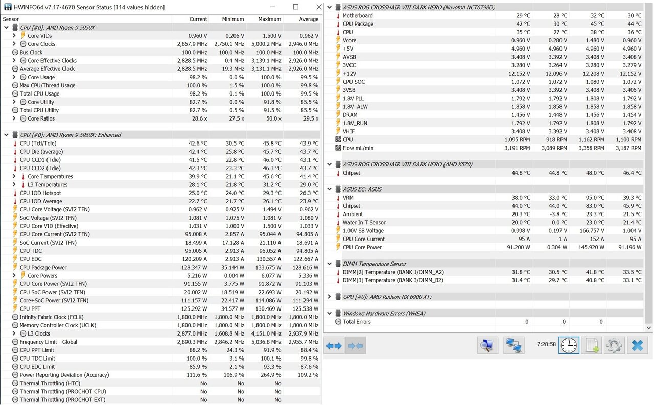

7hrs of prime95 and no errors.  Far from conclusive, but certainly encouraging.  I don't have much faith in some of the maximum temperature readings being reported by HWiNFO64 (or they are exceedingly fleeting), since if they were present for more than a flickering moment there should be a corresponding increase in recorded fan RPM.  I may let the test run again and log both the temps and RPMs just to have a better picture of the duration and frequency of the spikes.

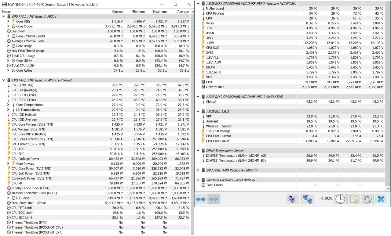

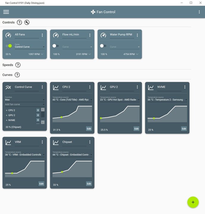

This particular piece of software has exceeded my expectations.  The screenshot was taken while prime95 was still active.  Hence the elevated temperatures on some of the components.  All of my fans are governed by the master "control curve" in the upper left of the picture.  It uses the maximum PWM duty cycle dictated by the 5 separate fans curves tied to individual temperature readings in the lower portion of the picture (I have each base curve set to 1-degree Celsius hysteresis with a 2 second response time to smooth changes in RPM out to levels I find acceptable).  Currently I do not have the option to create a base curve based on memory temperature as Fan Control v101 doesn't have the DRAM temperature readings in the list of possible sensors when creating a new curve.  I need to find or create a HWiNFO64 "plugin" for FCv101.  However, creating one is, for the moment, pretty far outside my comfort zone.  Regardless, those with more ambition and or time could really optimize the settings of their cooling system with FCv101.

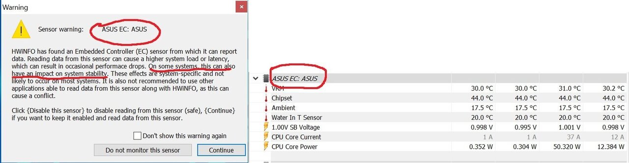

TDM
Reading comprehension is the most undervalued skill known to humanity...
TDM

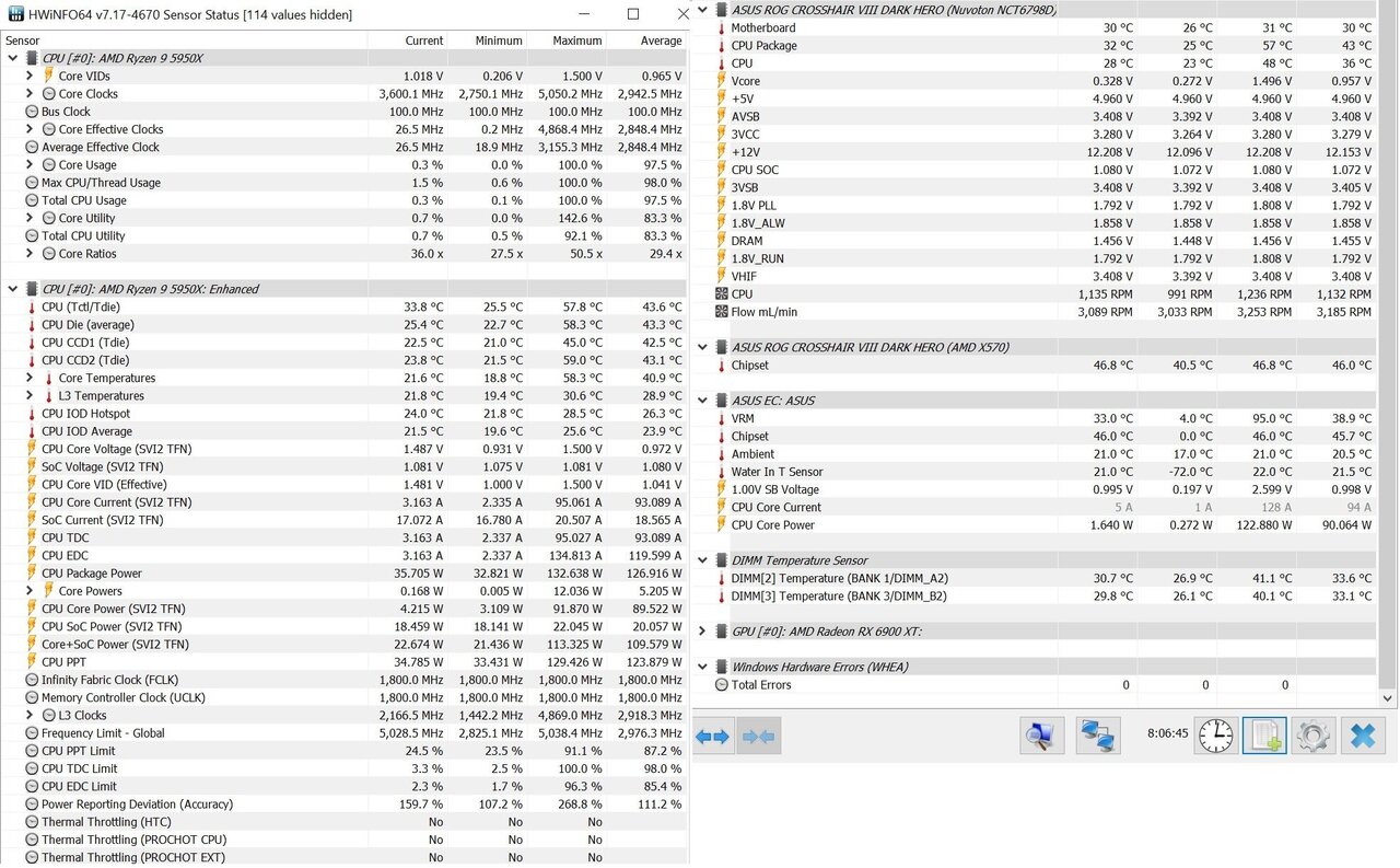

The good:  Another 8 hours of prime95 without issue.  I did save the .CSV log from HWiNFO64.  I'm pretty confident my VRM temperatures peaked at 40 Celsius rather than 95 indicated in the picture below since there was only 1 reading above 40 in 27,331 data points 🥳.  I also think it very possible that my mysterious wonkiness two nights ago was caused by the "Embedded Controller" issue highlighted in my post just prior to this one (rather than my RAM).  This controller's inability to play nice with HWiNFO64 at all times could explain some of the erroneous temperature readings I've seen in the past as well.
The bad:  Feeling like an idiot after wasting two nights because after reading that warning the first time I launched HWiNFO64 I completely ignored it from then on.

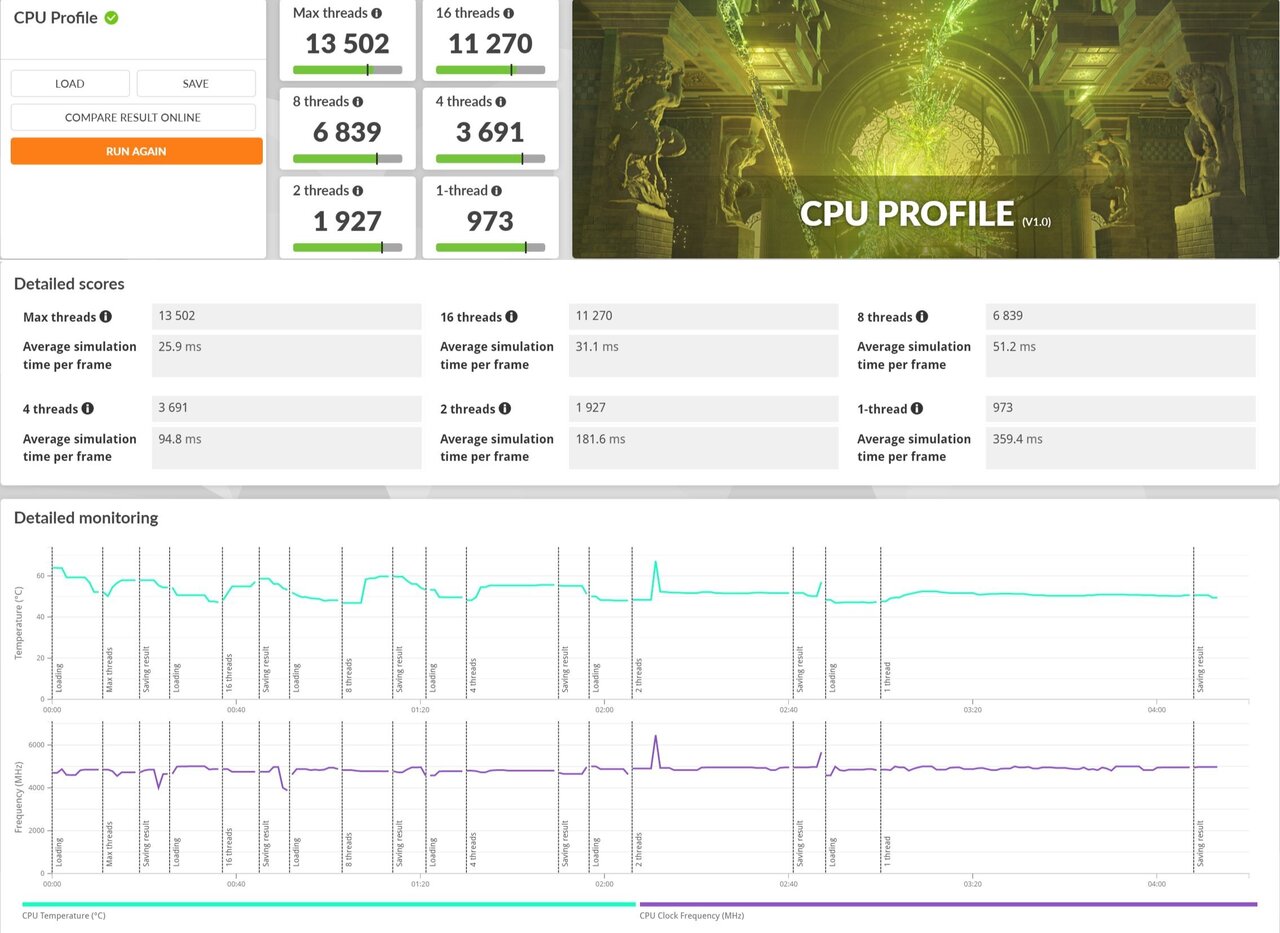

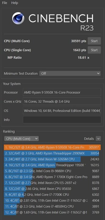

Results with the most basic level of PBO turned on.
TDM
Summary.
Significant jumps in multicore performance.  Slight degradation in single core performance.  Good for productivity and less than ideal for gaming.

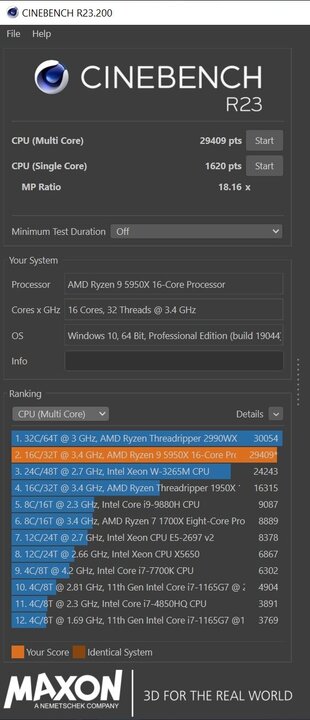

Began with some Core Optimizer tuning tonight.  I don't have it fully dialed in by a long shot, nor is stability truly confirmed, but it felt like progress none the less.

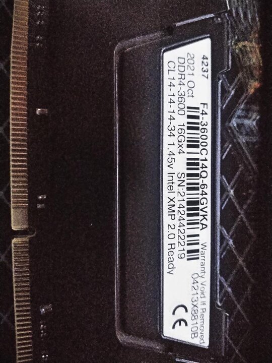

Before initiating last night's session, I opted to reinstall 64GB of RAM.  Not stopping right there setting the BIOS back to defaults and verifying the stability of both RAM and the system in general before proceeding one tweak at a time was a noobish naive numbskulled mistake.  Because now I have no way of knowing what particular change resulted in the never-ending series of errors testing exposed.  So, no charts with conditions and results today.  Tonight, its back to square one, after I tattoo "patience, grasshoppah" on my forehead 😉.

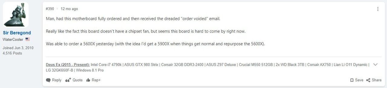

TDM
  On 27/01/2022 at 20:53, ArchStanton said:
However, I see you are aware of at least one of those threads already...
Expand
Yep. I did manage to snag a Dark Hero, but still on the 5600X for now.
Going to look at snagging a 5900X around the time Zen 4 comes out I think. I don't have a want/reason to go 5950X since I primarily will just be gaming, but would like to have some fun with OC too.

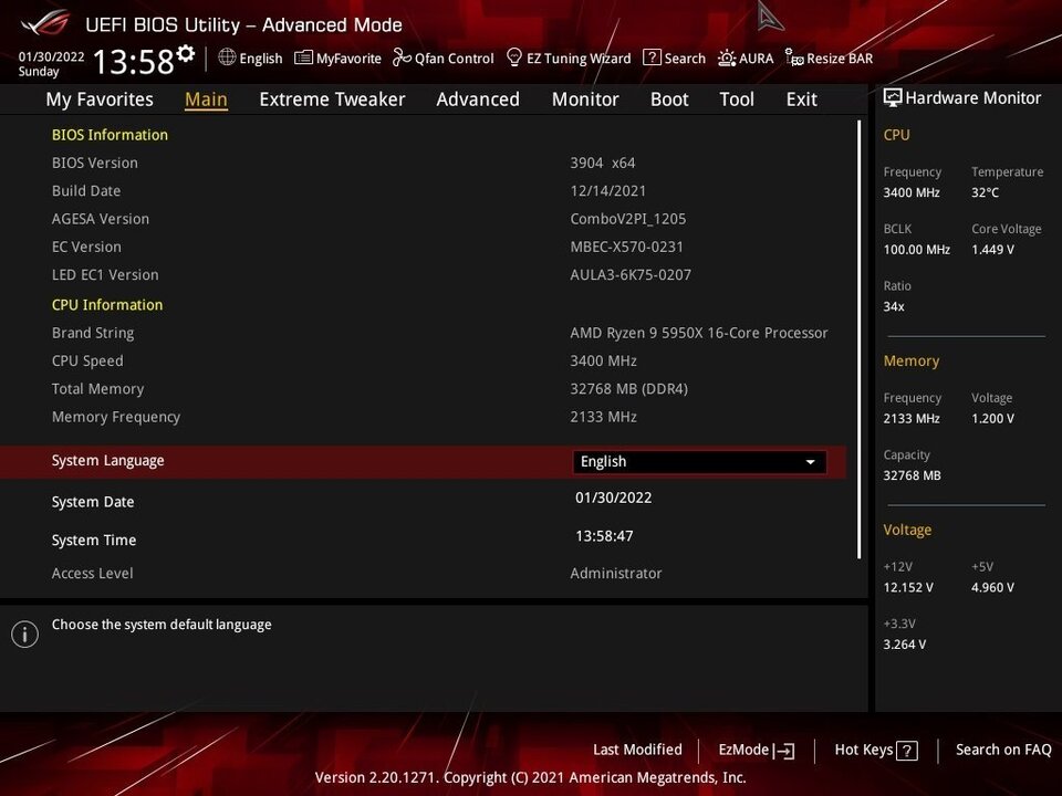

Update.
:confused_frusty2:

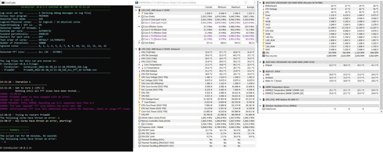

CoreCycler seems to be the consensus tool for verifying Curve Optimizer settings on the Ryzen 5000 platform.  As such, I have made frequent use of it to date.  However, CoreCycler appears to indicate I have "out of the box" instabilities.
I have previously checked the RAM installed in the system (2 DIMM's only, 32GB total) using 10 cycles of Testmem5 (extreme@anta777.cfg) and OCCT (6 hours) with DOCP both enabled and disabled.  I have never had either program indicate a memory error.
If I clear CMOS and start from scratch, I get the results detailed below.
CMOS reset settings.txtFetching info...
