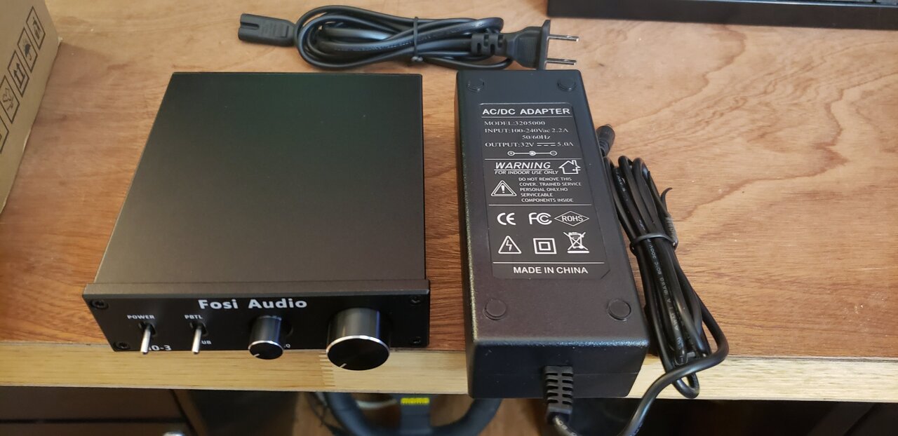

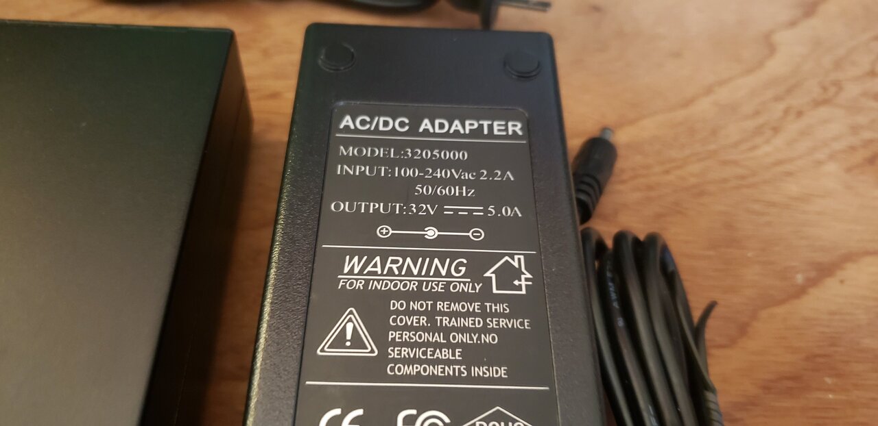

Everything in the box unpacked on my desk.聽 We have the amplifier itself and a 32v / 5a power brick.聽 Fosi Audio states that to get FULL POWER out of it, you need to upgrade to a 32v / 10a power brick.聽 I'm using a 6.5" 100w subwoofer, so I don't need to do this.聽 The stock power brick is fine for my uses, and they claim 150w capable with the stock brick.聽 Let's see if that's true.

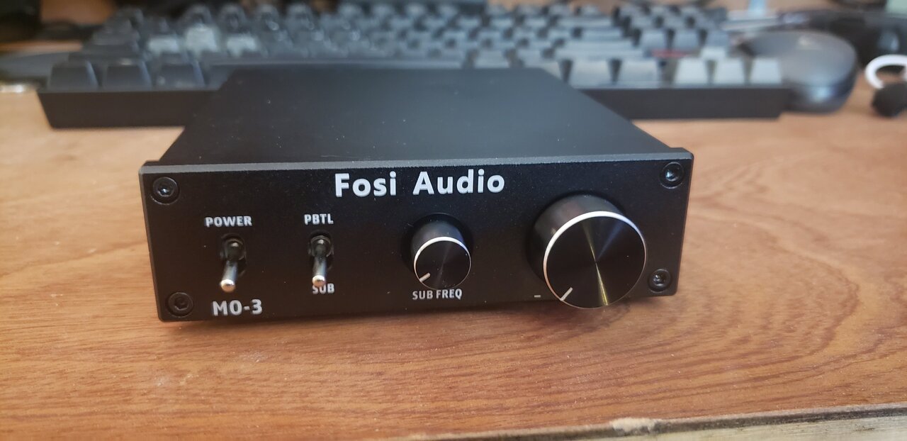

As far as controls and inputs on the unit, let's take a look at that.聽 On the front of the amp, we have from left to right, a power switch, subwoofer or full range switch, crossover frequency knob when set to subwoofer mode, and the gain knob to match the inputs to the outputs.

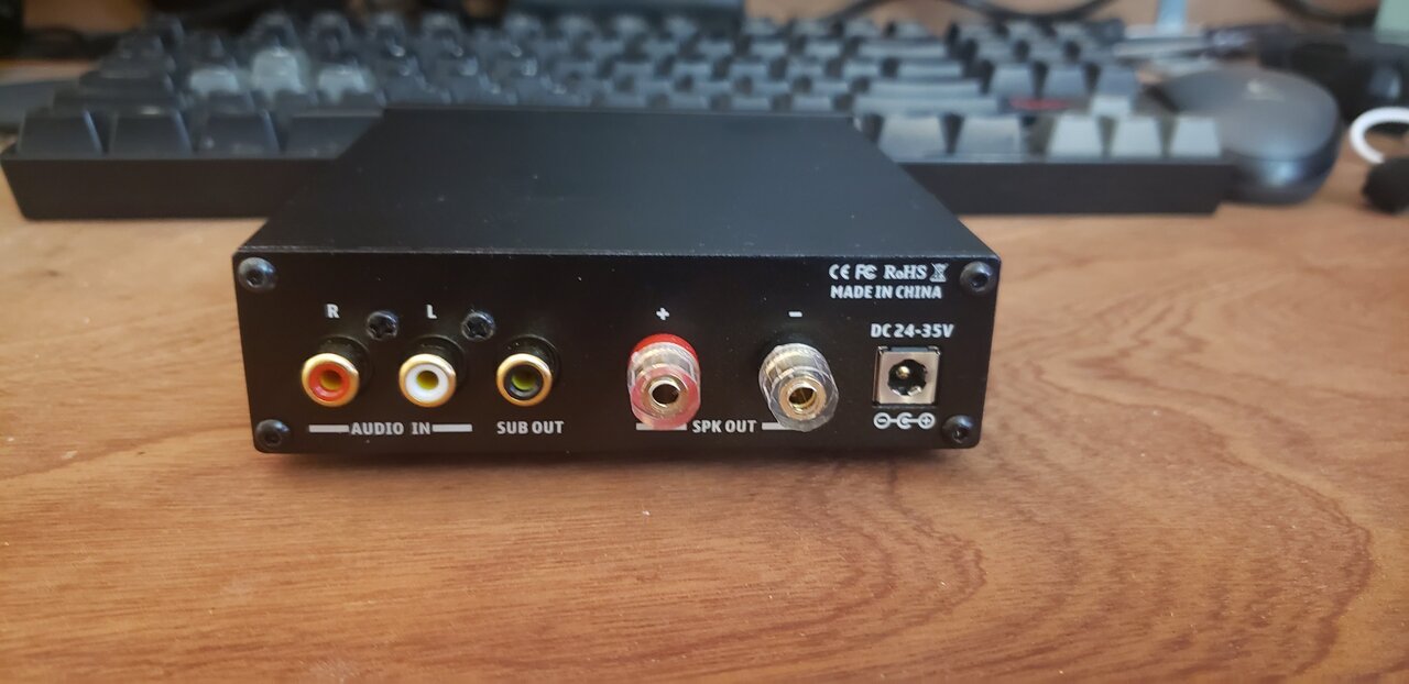

On the back of the unit, we have very basic ports to use.聽 Again, left to right, we have the R/L RCA inputs from your source (or from a powered subwoofer RCA out), a powered subwoofer out if you wanted to daisy chain another sub in the system, the mono speaker output, and the DC power jack.
