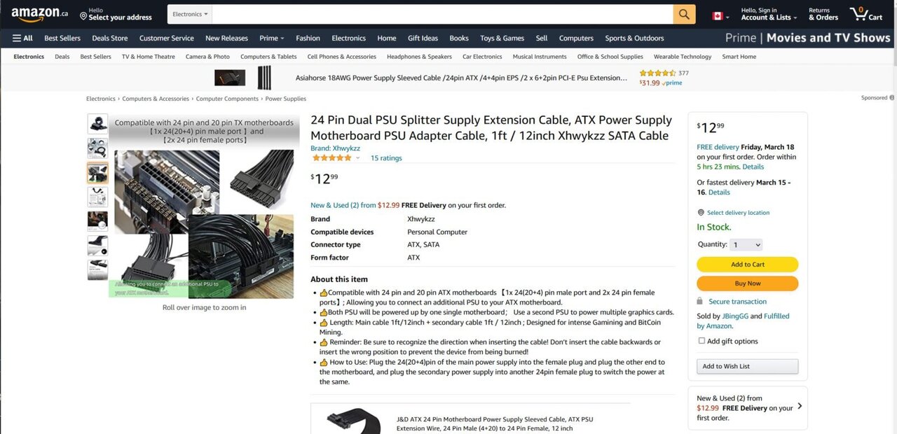

The 2x PSU's run independently from each other.  The only signal they share is On/Off when the system is turning on and off. I had used dual PSU setups for years back in the day and nothing has really changed, all you need in the 24PIN Splitter cable.
WWW.AMAZON.CO.UK
Xiatiaosann Dual PSU Power Supply 24 Pin 20+4 Pin Male, Main Second ATX Adapter Extension Cable Multiple Power Supply Splitter For ATX Motherboard : Amazon.co.uk: Business, Industry & Science
You will note that the spit off 24pin connector only has two actual cables going into it, that is because the second PSU as I mentioned just needs the On/Off signals.
I used to run my SLI setup off the second PSU and my primary took care of the system itself and overclocking.

I've been using the Add2PSU boards for a long time. https://www.amazon.com/Multiple-Adapter-Connector-Genetek-Electric/dp/B0711WX9MC
Below is the small add-on-board in my workstation. The top 1000W PSU powers two GPUs and the bottom 1300W PSU powers the rest of the system.  Absolutely zero issues.

I normally use either 2x Antec 1300W HPC which have a proprietary OClink to each other (for an easy 2600W), or heavy-gage multi- PSU cable trees - like the ones below but better wiring...probably what you need if you want to run dual upcoming dual 4090 Tis 😂
