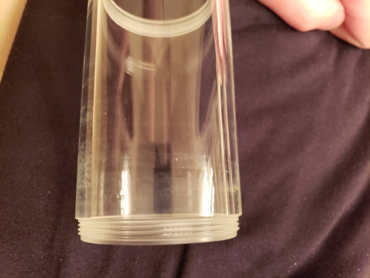

Anyway, I spent a good amount of time tearing the old loop out and starting cleanup on parts I am reusing, which includes the reservoir and pump.
I am wondering what the best solution might be to clean up the tube part of the res. Can clearly see coolant level lines as it slowly evaporated (loop was in use for 18 months and this room is a high sunlight area). Anyone have any suggestions?

Anything gentle enough to clean/polish automotive headlights.  Toothpaste is the "redneck" polishing compound of choice.  I'd certainly try just hot soapy water first though.  Microfiber to prevent scratches I suppose 🙂.
I started with the soapy water and microfiber. I do have some car polish in the garage (Meguiars Ultimate Polish I think) I could try then. If that's not fine enough, can look for headlight stuff.
I wouldn't suggest it, or other "paint" polishes.  No joke, plain old toothpaste, a gentle "cloth/brush, and time will polish her right up without scratching.  Any automotive parts chain store will likely have "headlight polishing kits" though.

Was able to clean up the reservoir tube quite well with some Meguiars PlastX clear plastic cleaner/polish. Reservoir looks great.

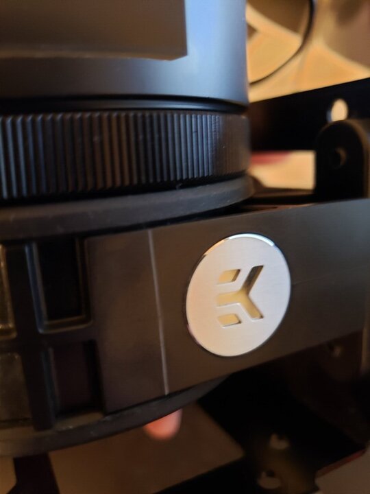

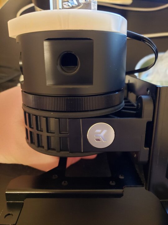

Bad news, when attempting to remove the D5 pump from the mounting bracket so I could better reattempt to reconnect the pump to the pump top, managed to snap back this plastic arm that wraps around the pump. It didn't cleanly break all the way through, so is still attached, but I'm going to pick up some super glue tomorrow just to make sure is doesn't break all the way through in the future. Worst case, just another battle scar as you can see this line where it bent now. Was really my fault as I overestimated how far it could swing out once unscrewed from the other side. Turns out just loosens it enough to allow you to pop the pump out. Oh well, could have been worse.

...Superglue (along with industrial velcro) are a builder's / modder's best friend. If all else fails, steel strapping such as the one below can be used to make all kinds of brackets (just add flat black paint 😉)

I'd have to check, but I might have an extra bracket in storage that I'm not using.  If I do, it's yours if you want it.
That's very kind, thank you. I'd definitely be interested if you do!

Well upon removing the pump again, the arm finally snapped. A dab of gorilla glue fixed that right up.
