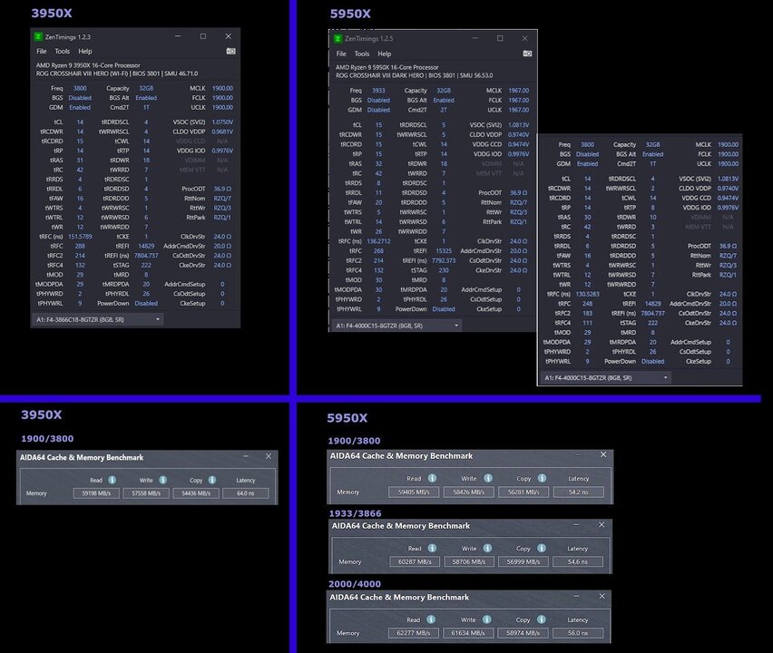

IF 2000 / DDR4 4000 can be done with the right RAM and willing IF, but it usually is a trade-off between latency and bandwidth (below). Also, I like to keep Soc-v and related IMC voltages fairly restricted for 24/7. Tight-timings 1900/ 3800 is great for most apps. All that said, there's also 3866 and 3966 if 4000 doesn't quite work (re. WHEA etc)...
Aida_new_comp_3800_3866_3933_4000_3950X.thumb.jpg.67b107be77bce40c248166b0c502dbc0.jpg
