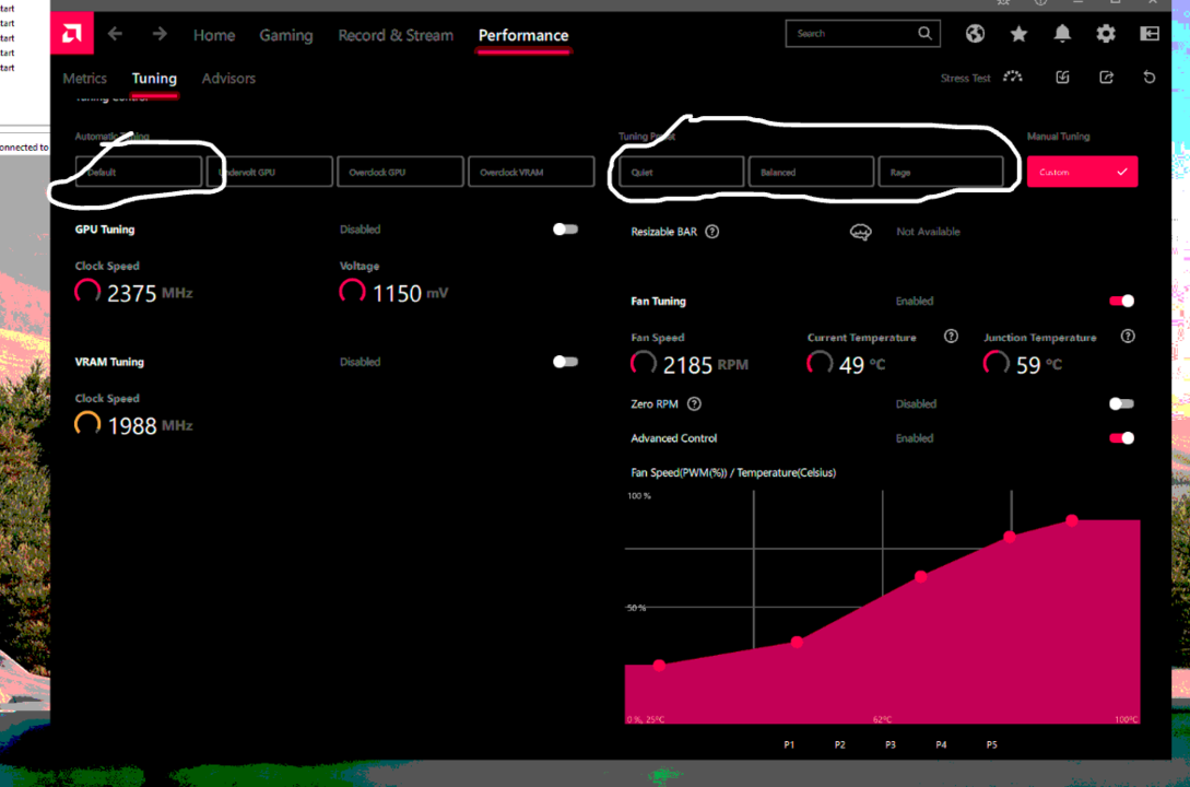

Sapphire 6800xt Cooking itself with any driver...
bonami2
1 Attachment
Always had that issue with all my amd gpu 7950 r9 290 rx 480.  The fan are always at like 700-1200 rpm till the gpu run at 80c+ And memory run at 80c
Anyone know if there any software that can cause this? I know in the past hwinfo64 was doing it was crashing the gpu to 2d clock on my 7950 and caused fan speed bug.
Am kinda exhausted of amd driver/hardware team and i think am gonna sell and go back to nvidia. Gave them enough chance to do something.
Am i the only one on earth with those issue ? 😆

No i mean the fan stay at 850/900 rpm while the vram junction is at 85c and core 80/83c
I ran DDU reinstalled driver and it was running higher speed but after 2/3 new driver it went back to this.
And manual fan control on afterburner or amd never work reliably for me when ran 24/7

Installed amd pro driver to test out. Fan rpm start a 1100 at 50c then at 65+ it 850. No idea who programmed that but he failed.
Except that the custom fan profile work and i gained 100k ppd so 1.1m 😬

Everything running good now it seem. Manual setting seem to hold 2k rpm and gpu core 53c and memory junction at 57c  room temp 20c Average 95% usage 1.7m ppd

I always had this issue with my amd gpu for some reason. I wonder if corsair or logitech software may be the cause.
Tried studio and latest driver. And the fan never go over 1000 rpm at high temp for some reason. Even tried all those setting in white here.  Just manual work. Gonna try uninstalling some software.
It is not impossible for their to be conflicts but this would usually only affect the reading of the sensor in Windows. Assuming fan speed is left to Auto, the VBIOS will handle it, meaning that it would bypass any potential software conflicts. Have you tried this GPU in another system/vanilla Windows installation ?
If you have issues on Auto in a different rig or vanilla OS install, I could only assume a bugged VBIOS, or the VBIOS has a really poor fan curve setup.

At least now it being folding for 3 days straight with the fan setting set.
My computer reboot seemed to be caused by one of the asus software so maybe the fan curve is alright and it mean to be quiet at 1k rpm.

40 minutes ago, pioneerisloud said:
With a full f@h load on it right now, I'm doing 206w, 58*C, and 2900-3k RPM.  On my 6900XT MSI card.  Using AIDA64 to monitor.  Stock everything in drivers except a custom fan profile (and game stuff but that doesn't affect stability).
I mean stock setting so it spin up or try to cook itself like mine. Maybe they are setup to be quiet.
