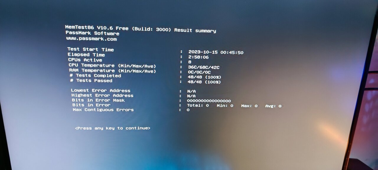

Okay, i made an memtest86 stick and let the program run overnight and when i woke up i saw that is passed at somewhat stock settings.

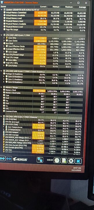

The cool thing about Aorus is that they have a need feature where you can see the timings in hwinfo64. You can access it via clicking the hwinfo64 icon on the right bottom in the hidden icons tap, than click timings.
HWinfo64 also has an Aorus profile which looks kinda need, i like these small little things.

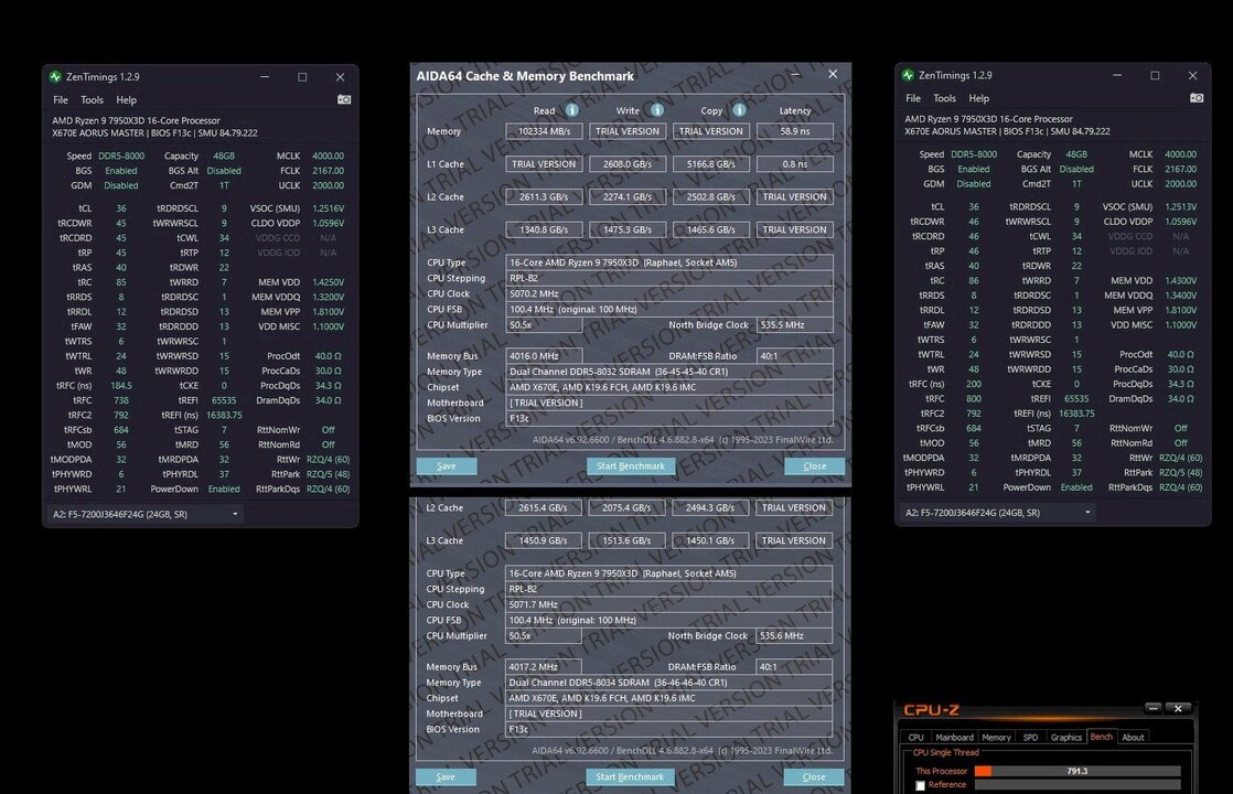

I admire the DDR5 voltages some of you folks are running...per recent post, I've used up to 1.5 V once for less than 30 minutes for 8200 in an otherwise daily config.
For the daily 8000, I've updated some voltages ever so slightly (per Zen on the right side). The setting on the left (GPU benching) uses the same voltages now. In addition, I have a CL 30 6400 at 1.42 V. After trying various minor timing mods for the DDR5 8000, I always come back to where it is below at the normal voltages.  I am also still having fun with 'eclk' as opposed to 'bclk' on this board; I'll post some results for eclk in a bit. ...still would like to break 800 in CPUZ single thread score on regular ambient custom water cooling...not too far from it and a few more eclk tuning steps might do it.

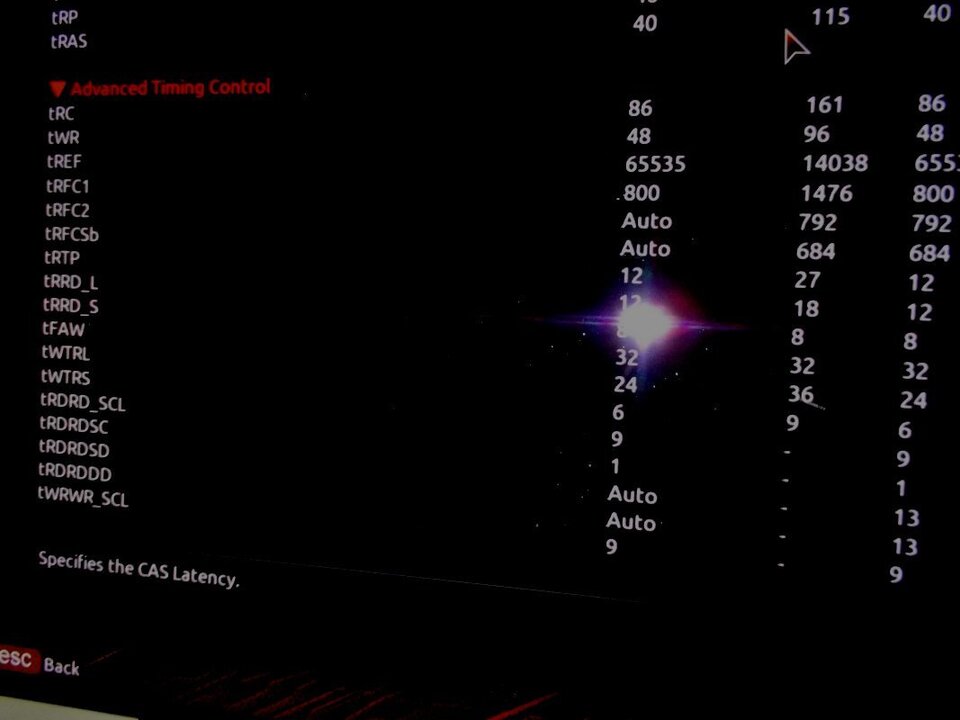

4 hours ago, ENTERPRISE said:
That would be great.
Source
you mean this from y Aorus 670E Master bios ? Also note @kaliz screen shot on p11
The one Kaliz sent they rejected saying it was from an Intel BIOS which I need to look into again. So I thought I would ask again.
I cannot see it in your screenshot either as something you would "Enable"
I looked through every section of my bios including AMD CBS, DRAM Timing, and AMD Overclocking, but could not find this option unless it's named something else.
