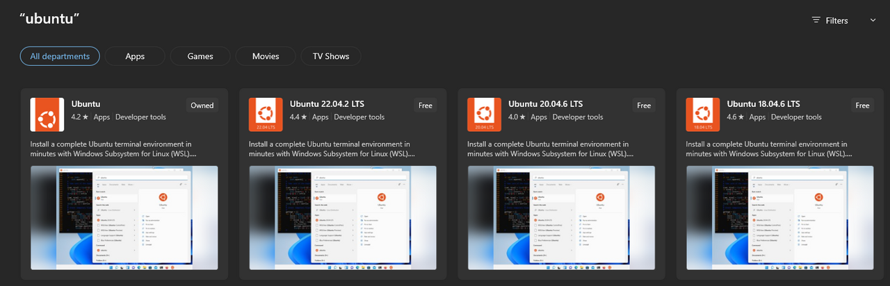

There's no really much to setup for GSAT. Enable WSL, download Ubuntu in Windows Store, start it, install stressapptest (sudo apt-get install stressaptest) and then start it with the parameters you want (for 4 hours with 60GB total: stressapptest -s 14400 -M 60000 --pause_delay 99999999 -W --max_errors 0). Then just let it finish.
you can increase the 60000 to all your RAM if you aren't using your machine while it tests but I leave a few GB free so I can at least ask @iamjanco for my 4090 while the test runs
Thanks bud.
I got everything set up and installed, however when I run
I get the following error :
Any ideas ?
**EDIT** Seems that after some reading that GSAT tries to allocate memory that is not available and you have to use a lower figure. I just tried that and still getting the error. So I am going to create a live OS and re-set it up.

dunno really, never really ran into any issues but I've never tried >32000. maybe try fewer flags or maybe I goofed on the order? Order shouldn't matter though.
can drop the max errors and pause delay one and they'll just be set to the defaults. try "stressapptest -s 14400 -M 60000 -W" or "stressapptest -W -s 14400 -M 60000"
you can drop the -W flag too but it'll make the test less intensive/effective.
edit: order doesn't matter, works for me. ¯\_(ツ)_/¯
Maybe try another Ubuntu version? There's a few different Ubuntu versions on Windows Store and I'm using the first one. Neofetch says it's 22.04.3. It really shouldn't matter either though.
Edited by The Pook

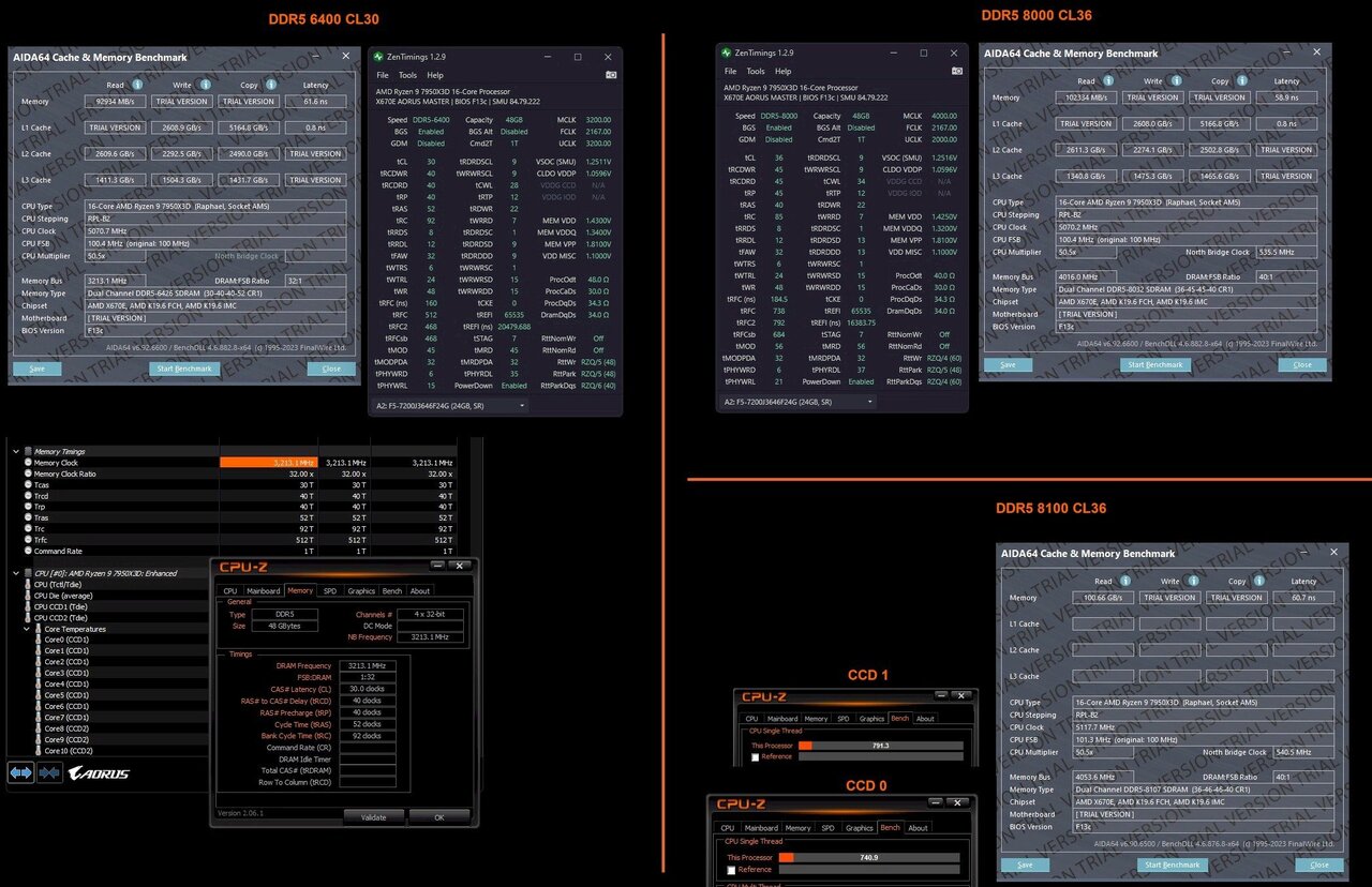

I hope you folks don't develop RAM_eritis; I have seen that before, it is hideous 🤪  For example, if you dream that you have to pass 666,667 % of RAM stress test xyz, call 911... 😉
Below on the left is a quick test with @kaliz 's suggested timings for CL30 6400 (using the same 2x24GB new M-die kit as before). I didn't translate all the voltages and timings but it is serving as a good basis for comparison to my regular 8000 settings...an irregular, non-optimized 8100 is also there for fun. I even have quite accidentally seen an even DDR5 8200 in Win 11 Pro, but it didn't last very long. The CPUZ items at the lower right just show single-thread performance with CCD 1 (speed) and CCD 0 (VCache).
Nice, thanks for the context! I think I am getting RAMitis at this rate lol. I am looking forward on setting on an OC and sticking with it. On that front I do have an update. So far I have the below stable (at least so far in the testing)
I can start to reduce secondary timings more as I think I have hit the best I am going to get with the primary timings so far as 28-37-37-52 but does anyone have any particular suggestions on the rest of the timings ? I have some references to use, but happy to have suggestions.
Also managed to get GSAT setup on a Live instance of Linux Mint, thanks @neurotix

RAMitis for sure 😁   ...nice timings, and for MEM VDD of 1.55 V, I think you mentioned the extra cooling you added for the RAM. For the secondary and tertiary timings, I would go with Buildzoid's Hynix-A-die YT above.  The 6400 I showed was using @kaliz 's timings to give you context. The 'new' M-die I run is very good for higher bandwidth (7600+, 1:2) but A-die is probably better for 1:1, given what I have read.

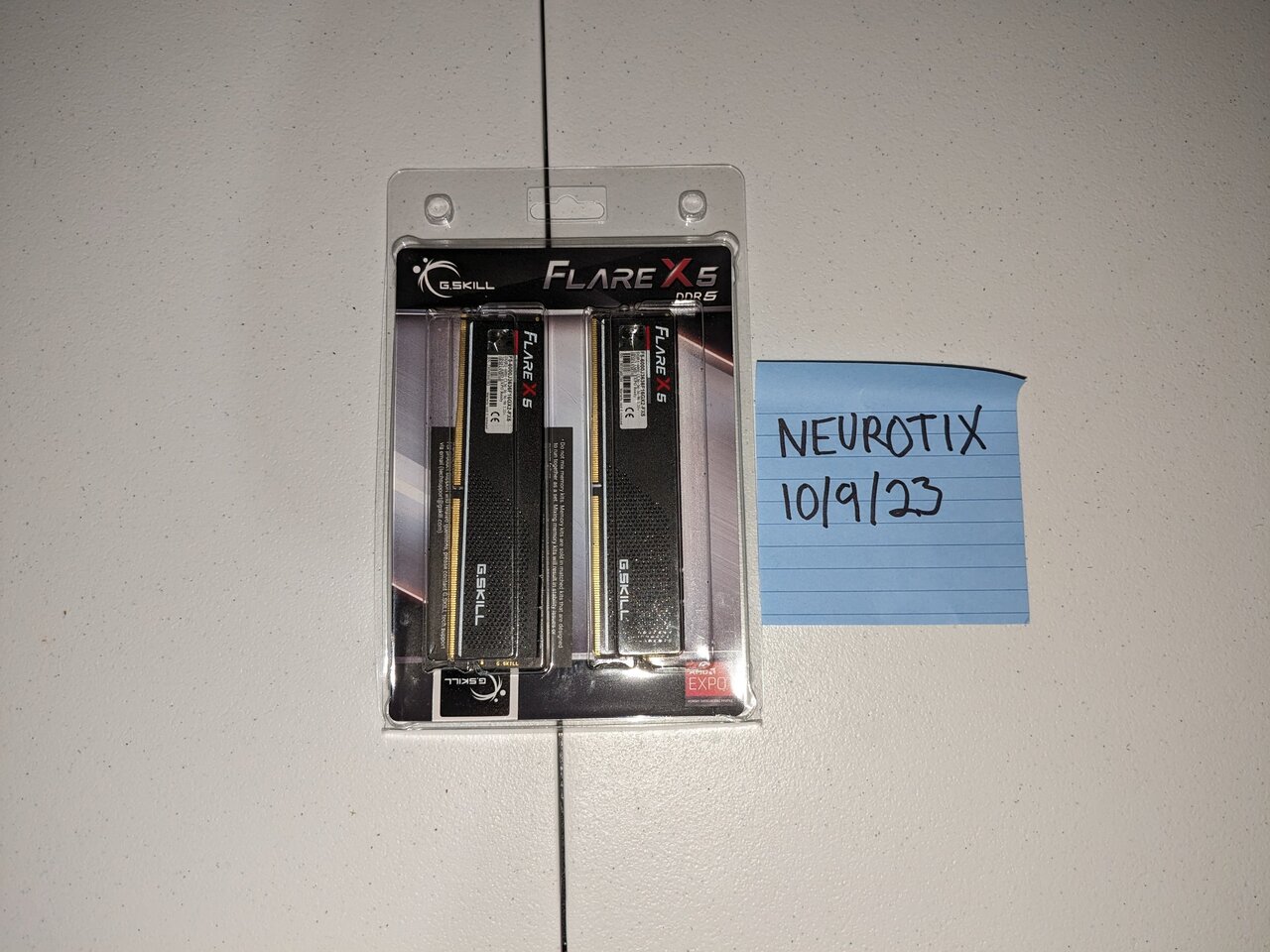

My G.skill Flare X kit had B-Die. Before I upgraded to my current TridentZ5 with Hynix M-Die.
Seriously, read a guide on using Thaiphoon Burner to generate a html report and take a screen of it and post it here if you want us to be able to help more. ZenTimings would be nice too.

Flare X 5. It is DDR5 Samsung B-Die.
