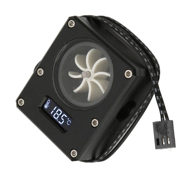

Right so perhaps instead of a y-splitter, maybe a couple of those cheap plastic flow indicators that have 3 ports. They sell them on ebay, ali express, ect. There's even ones with coolant temp readout and they are all cheap asf.

this little guy looks fun for $10
Link
