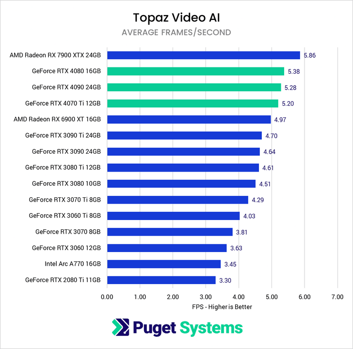

Can someone explain in detail how much faster a 7900 XT is than the 6900 XT on Topaz Video Ai software?
Currently going from 1080p to 4K, I get like if I get lucky 2 fps on my Vega 56 with Vega 64 BIOS, thoroughly optimized for this task because it's insanely demanding.
It hits the 3D engine hard, not the compute.  So what kind of fps would I get with a 6900 XT vs 7900 XT?
If my math is correct, with my Vega 56 3584 shader units, I get 2 fps, then a 6900 XT would be 5120 which is 42.86% more so that could yield 2.8572 fps but I guess with architectural & clock improvements it should yield 3-4 fps?
Then we get to the 7900 XT @ 5376 shader units which may yield 3 fps, but with architectural improvements from RDNA 2 to RDNA 3, could see possibly 5-6 fps?
Or am I nuts & I'm looking at my original calculations?
Thanks
Not a big difference between the two considering the 7900XTX was barely faster... if you already have the 6900XT I wouldn't bother with the upgrade to a 7900XT and that includes for every task outside of Topaz as well.   That said if you are considering both of these over your current Vega 56, I'd go with the one you can get at a better cost/performance.   7900XT does have other benefits though such as AV1 encoding and newer features plus the extra 4gb of vram.

13 hours ago, HeyItsChris said:
Thanks for the chart bro!  That makes it so clear to me.  Yeah I can get the 6900 xt for 449 or the 7900 xt for 799, i guess its quite clear 6900 xt is better for the price.
All good.  6900XT's are getting hard to find so do consider the 6950XT's as well, they will close the gap even further on the 7900XT.
