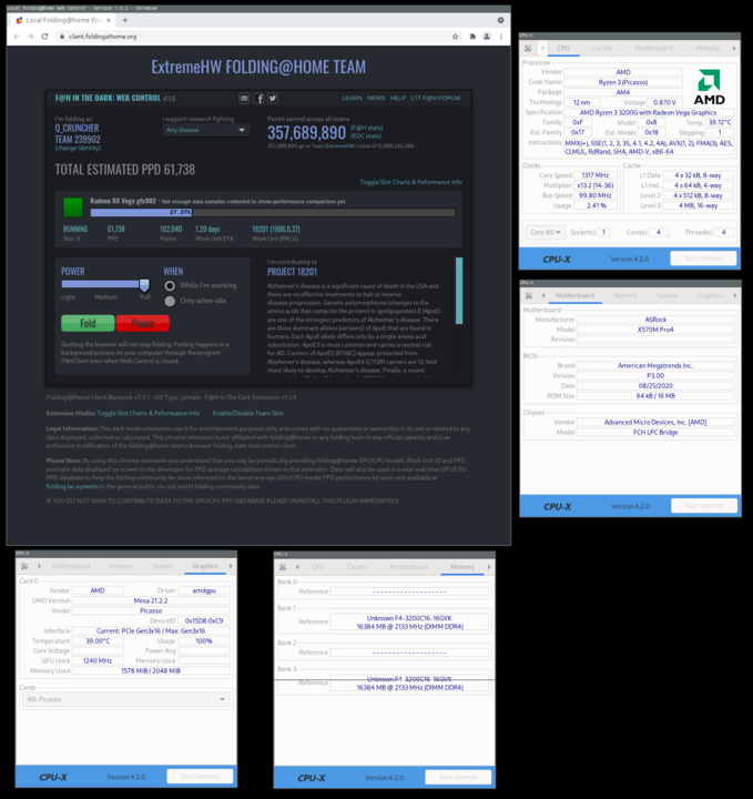

@damric  I might need to tweak a few things on my 3200g.  Do you know what you're average TPF is on p18201?
Right now, at bone stock, it doesn't look like I'll complete this WU on time.
*Edit*
Just looked at the LARS info for that unit, and it looks like it averages about 6 days to finish that unit.

On 18201 I am getting 16 minutes 53 seconds. I'll have some time tomorrow to walk you through how to tune it up.

Thanks for the info.  I was just looking for a bit of a baseline.
As far as tuning the 3200, I've messed around with a number of AMD APUs, so I should be good.  I will hit you up if I hit a wall. 👍
*Edit*
It will finish a p18201 in plenty of time. I just had to wait for a few frames to get a proper TPF.

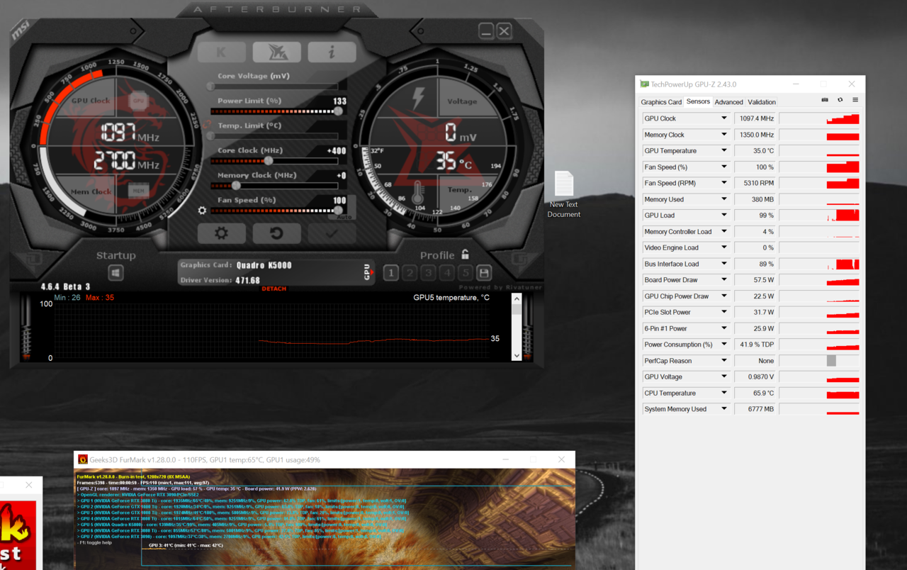

Eat your heart out @BWG Broke the 1000MHz barrier. Seriously though, I need help @tictoc. No matter how hard I try, I can't get the card to use more than 70% TDP. I have tried manually setting higher voltages and increasing base TDP through Keplar Tweaker to no avail. Maybe you and I can get together this weekend if you have time Greg and do some modding.

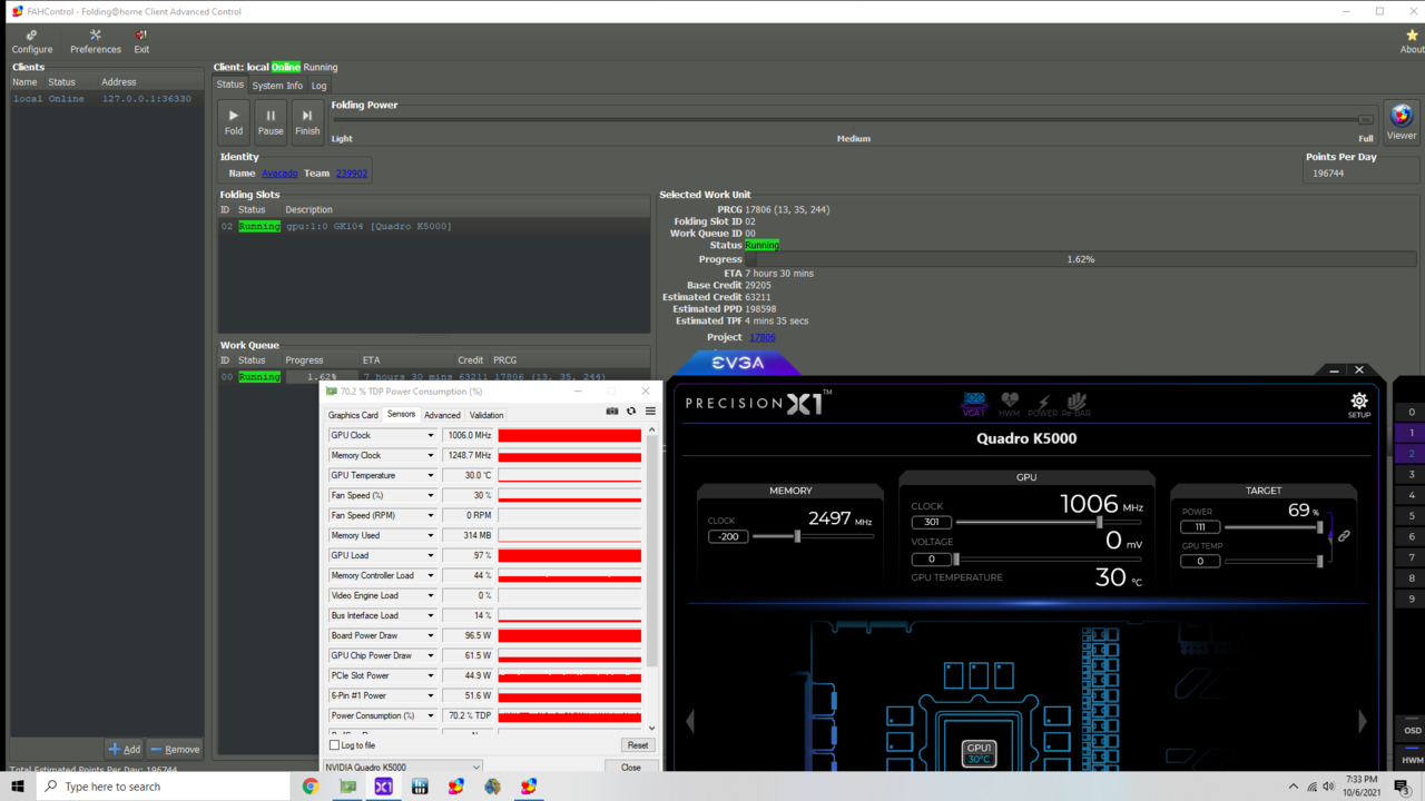

There are 4 entries in power table tab. I am quite sure #2 is board power, and #4 is Power cap as 111% is max. 1.png.ecc75da560375888d5fce853a8b750dc.png
Yes, well partially modded. The card is rated 122w TDP and gets power from a single 6 pin and the MOBO so 150w in theory. It rarely uses more than 100w. Even if I could get the the card to just use its TDP of 122w, I would be happy. I have modded the voltage and the power table you see above. There is no clear way of knowing which of the 4 is for what because it's not labeled.
I think I might have to modify the Def range, though I can't find what that abbreviation stands for.
It has been quite some time since I modded a Keplar BIOS. 🙂 You will need to edit the Def table value.  I'll have to grab a copy of the BIOS to poke at it to try and figure out which table is which.  For starters the second table looks like PCIe power, so bump the PCIe rail Def up to 75000, flash and then see what the results are.  Looking at your first post, and the fact that you are only hitting 70% of TDP, I suspect the third table is the Power Target.  I would slowly bump up the Def value there, and test to see what the results are.

It has been quite some time since I modded a Keplar BIOS. 🙂 You will need to edit the Def (Default) table value.  I'll have to grab a copy of the BIOS to poke at it to try and figure out what which table is which.  For starters the second table looks like PCIe power, so bump the PCIe rail Def up to 75000, flash and then see what the results are.  Looking at your first post, and the fact that you are only hitting 70% of TDP, I suspect the third table is the Power Target.  I would slowly bump up the Def value there, and test to see what the results are.

So success! Finally pushing 90's on TDP, I have been hitting 74w on the 6 pin and think I might just be able to get the card past 1100Mhz. That is a 58% OC!
Nice.  I bet there is still some headroom to push it even a bit higher.
I would personally be comfortable pushing 100W on the 6-pin connector, since I doubt you're running a cheapo PSU with 20 gauge wires.  The GPU should certainly have no problem handling a bit more power with half way decent cooling.
