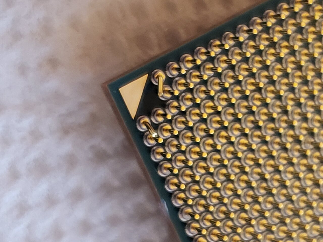

Gah. I was tearing down again and taking this air cooler off tore the cpu off the socket with it and I now have a bent pin. Grrr....
Correction - 2 bent pins.
Appropriately sized syringe is supposed to be the ideal tool for straightening them, sorry for the troubles ☹️.

Think I managed to fix with some stuff out of my iFixIt kits (tweezers and an almost razor blade type tool).
Now I see what people mean when they say the coolers can pull up the CPU. Problem is once the retention arms came up, I didn't even have time to wiggle the cooler off, it pulled it right out just from the released tension. Was using a BeQuiet Pure Rock Slim 2 to test with, has retention arms on both sides.
All I can say is that this is making me appreciate the LGA style Intel uses way more since it has that retention bracket where yanking the chip out of the socket is impossible.
 ...you sure are having a ton of fun with this build 🥴 ...all is well that ends well...
...re. bios, I asked to vendor to load the latest one when I picked up the mobo w/ the CPU already mounted. Said bios is 3501 and I never had any problems with it on my Win 10 Pro, so it is still there (I'm a bios luddite). If you are running Win 11, there is supposed to be a new one in May that deals with select TPM stuttering on some systems.
...re bent pins, check this out, including the writing utensil he uses to straighten the pins (and some tips in case you break one off)
