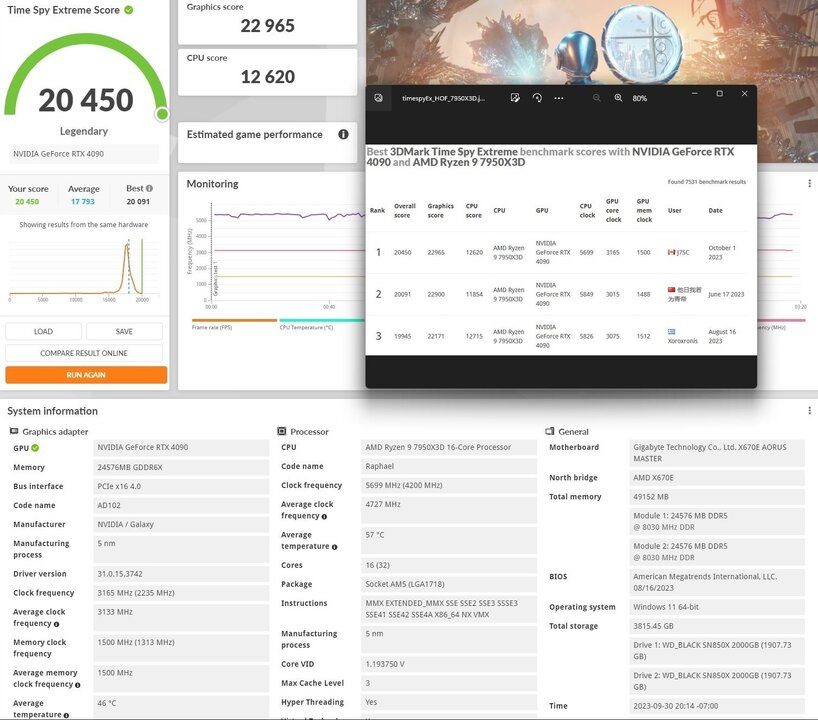

After RAM and standard CPU, bclk+, and eclk+ profiles are all set now, I played around a bit with with Process Lasso , something @ENTERPRISE @neurotix  and Co will also surely enjoy soon. It is more complex than Microsoft's  XBox GameBar but ultimately gives better control.
edit:   ...did a few quick benchies; all that CPU & memory tuning is worth it:
Nice dude! My best is 17k.
https://hwbot.org/submission/5244641_

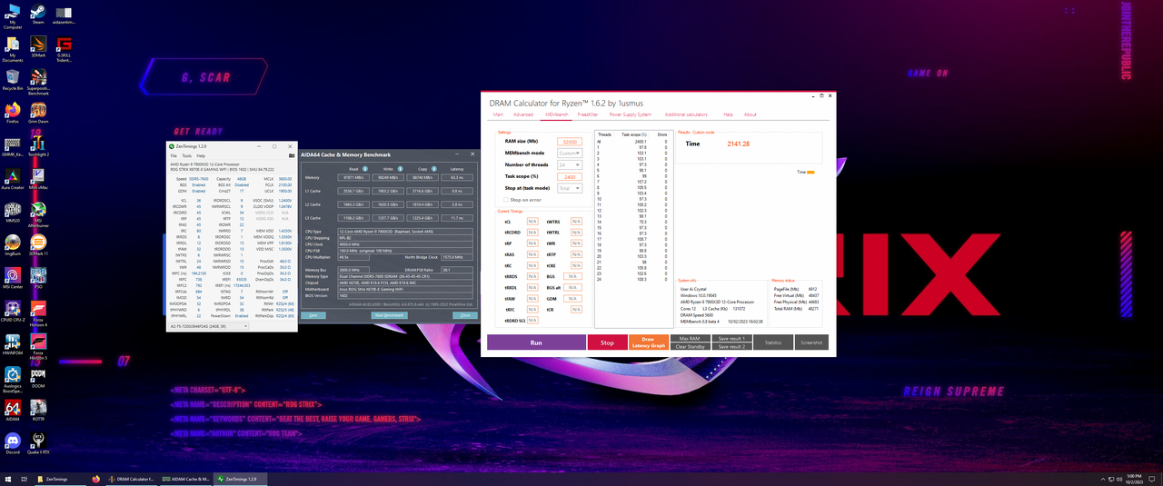

Hey guys, I got my kit of TridentZ5 with single rank Hynix M-Die today. I'm having problems where it's unstable (in memtestCL in the old Ryzen DRAM Calculator), I am going to try applying more voltage and see if it passes.
Unfortunately these are my results, using the settings @J7SC_Orion gave me:
The bandwidth on all the memory readings looks quite low to me for DDR5-8000MHz. These results are barely better than my tightly tuned B-Die at 6200MHz I was previously using.
@kaliz I am going to try adding more voltage to see if it will pass memtestCL and then GSAT in Linux, but can you go through and mark timings and make them a little looser to see if that gets me stable?

I passed memtestCL in Ryzen DRAM Calculator at 7600MHz on 24 threads with 32GB being tested and to 2400% task scope.
Next is stressapptest in Linux for 4 hours.
I'd still be interested in some looser timings from @kaliz to see if I can run 8000MHz. Unfortunately, 8000MHz and 7800MHz both errored out in this test pretty early on (within 10 minutes).
Thanks everyone.
...Keeping in mind that we have different boards and also that both CPU and RAM kits can have some variation, I would start with the less-tight settings shown on the left > here   ...start with the stock RAM speeds and primaries per XMP setting, then work your way up. Also make sure that your FCLK is rock-solid; I typically lock that in after RAM tuning is done
Thank you. I know 100% that my fclk is rock solid at 2100MHz. The looser timings helps too, but they don't seem that different from the others excepting the tRFCs. I'll give it a shot but I doubt it will be stable. I'll eat my words if I'm wrong, but it seems like my board and these DIMMs like 7600MHz and looking at the two AIDA's I just posted, there isn't really that much of a difference besides slightly higher latency and it seems like the bandwidth readings are actually higher in AIDA at 7600MHz vs the 8000MHz I posted.
Thank you again though. I'll try giving the looser timings a shot but I doubt they'll be stable at 8000.

As I suspected, the looser timings @ 8000MHz failed memtestCL with tons of errors within 10 minutes. I think for 8000, I'm going to need timings that are way looser, but it may be better to stick with the tight timings @ 7600MHz. About to start GSAT on it now.
What about 7800 MHz on your board, noting that the Aorus boards are usually among the better ones for RAM oc'ing. In any event, 7800 MHz was fairly easily locked in with tight timings. I only went up to 8000 after I 'learned' the particulars about my mobo, CPU and specific RAM at 7800. Also, depending on your board, bclk can also get you there, but again subject to A LOT of testing.
FYI, another thing to remember per earlier posts in this thread is that V_SOC adjustments work in opposite directions for higher FCLK vs higher RAM speed; you might want to try 2033 fclk and see what that brings re. top RAM speed.
Appreciated. Repped.
I think the gains are so marginal, if any at all (according to AIDA anyway), on my setup that I am going to leave it at 7600 with the 'tight' timings. As shown for whatever reason my bandwidth in AIDA was low for 8000 and 7600 nearly matched or possibly outperformed it though I'd need to check them side by side.
7600/2100 fclk is stable in memtestCL to 2400% task scope on 24 threads, as well as 3 hours GSAT stable in Linux.
I think to get 7800 or 8000 stable the timings would need to be increased significantly causing higher latency and thus, 7600 with your set of tight timings would outperform it.
Thank you so much for all your advice and help.
