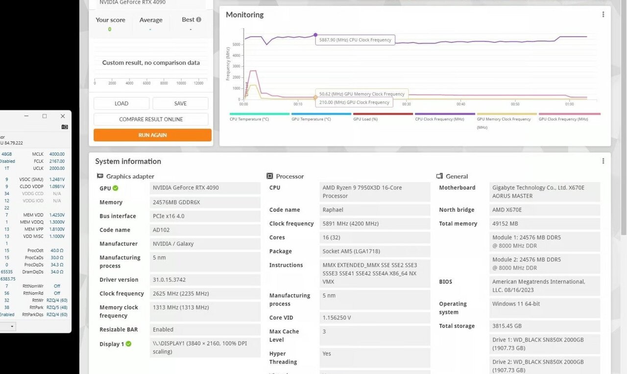

19 hours ago, J7SC_Orion said:
...here you > go
...and the latest Zen timings I use for DDR5 8000
What does your latency look like at those speeds/timings? Just wondering as im working on a kit now, granted at 6400 MT/s but looking at tight timings to better the latency. Then after that may push for higher clocks, at or close to 7000 MT/s and try to tighten timings again.
Looking at your UCLK you have it at DIV/2 ?

...yeah, I run mem DIV/2 at DDR5 8000. According to Buildzoid and a few others, DDR5 7600 speed is were DIV/2 becomes more or less worth it over DIV/1, at least in many more modern apps (think also resizable_BAR). As to latencies, I have now arrived at / dropped to the high 50 ns range in Aida bench, after much additional tuning. Things such as disabling PowerDown Mode and GearDown Mode give you an extra push in at least Aida cache and memory benchmark. That said, while I have disabled GearDown because I dropped a few primaries to 45, I re-enabled PowerDown again - sometimes, disabling it can lead to intermittent and hard-to-track oddities.
Given the most recent AGESA updates which opened up a whole new world for Ryzen RAM clocking, a bone-stock 7200 kit at DIV/2 starts in the low to mid-70s ns latency - but the stock XMP and/or EXPO settings are soooo generous for the vendor as to not throwing any surprises (and RMAs). A well-tuned but 24/7 '''sane''' multi-purpose work-play setup should get to 59 ns - 64 ns range, depending on various factors such as your mobo's topology, your specific RAM kit and such...and I have seen low 50ies (51.x) ns on the 7950X/3D some folks showed w/ their Aida, but only with very high voltages.
I have three rules for my 7950X3D build re. voltages (and related temps):
1.) V_SOC has to stay in the 1.25X V range (up to 1.30 V is considered mostly 'safe' even after the bubble-burns on the socket / CPU underside earlier in the year), and
2.) VDD DDR has to stay in the 1.42X V range. My RAM's stock voltage is 1.35 V, with many newer DDR5 high speed kits even at 1.4 V or 1.45 V
3.) Cool DDR5 is happy DDR5 - I have some extra Arctic P12 fans right above the DDR5 RAM - this kind of RAM gets hot (including PMIC) and you want keep it in the low 40s at most when under stress. Many folks resort to water-cooling as DDR5 has some fundamental differences (and heat sensitivity) compared to DDR4 Samsung-B, for example
Final advice: Open your favourite beverage before diving into the RAM-tuning-and-stress testing rabbit holes (there are many of them)...it's going to take a while and a lot of testing...
