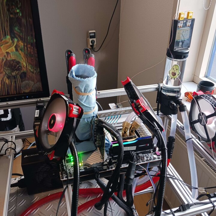

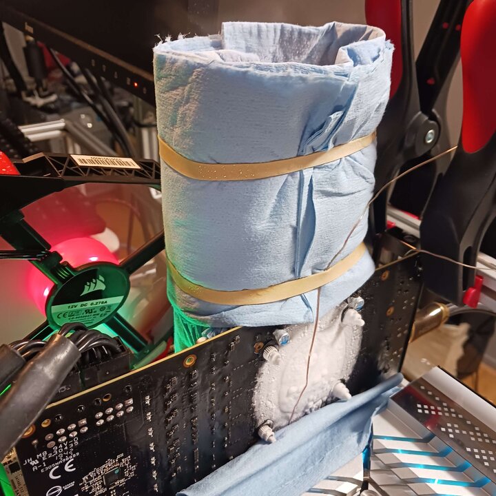

This weekend I've been playing with dry ice on an MSI RX5700XT.
It was my first time with dice and running a GPU sub ambient (the previous attempts with the cascade didn't go so well). It was fun and I learned a few things at the same time, for instance: don't put too much dice and acetone in the pot or it will boil over the edge and make the GPU stop working 😂
I managed to take back my gold in TimeSpy (for now) and get a second place in WildLife Extreme for the team competition.
Near the end of todays run the pot started leaking, acetone is dirty stuff and makes its way through threads sealed with Loctite. The shop towel protecting the motherboard was getting wet from Acetone, not ideal.
Anyways, here are a few pictures, a YouTube video and a few links to submissions:

Lucky for me, the card was already in 'cold trim' and had some additional mods to help her do a little better. Sadly I didn't get my flexible heaters in time, which are needed instead of a normal heater because I moved a few capacitors to the back of the PCB to make clearance for the GPU pot. Anyways, here are some pictures and the result (one of them 🤫 )

I added more insulation to the back of the card to reduce the risk of it causing shorts. Up and running, testing Superposition:

Onto the next subject, an AMD 4300G. This one was the most fun we had, as it ran full pot (constant -76°C) for almost 5 hours until I decided to quit. The hardware itself was totally happy, besides the ASRock x570 Taichi being a bit weird with a lot of missing settings. The main reason for choosing this hardware is that this was a fitting CPU for another part of the Country Cup.
The setup, figuring out some settings on the fly as it was a sort of last minute decision to switch and prep this board.

Due to the mass of the pot, and the minimal dissipated heat from a cute 4 core CPU it would run just fine without any dry ice in the pot. It would only heat up about one degree with the benchmark running at any subzero temperature we tested, and because it was totally new to me we did steps of about 10 degrees. Starting at -20°C all the way to hours of full pot fun.
And this is what it looks like after many hours of benching:
