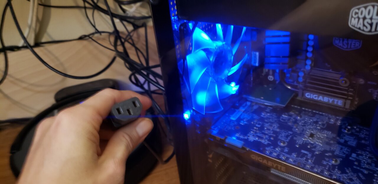

Swapped the CPU back into my Sabertooth 990FX, figured it was an FX.....it'll be fine.  System SEEMED fine for the week-ish I had it setup like that.  I never really stressed it, but it booted right up at its old clock speeds fine and was working.  Ripped a few thrift store CD's to my collection with it, again seemed fine.
I received an EVGA Capture card in about a week later.  I hooked it up, and I also hooked up a VGA adapter to it and an HDMI splitter.  This way I could run HDMI into the capture card OR a VGA cable into it, and either way I could capture footage.  It SEEMED to be working, but for some odd reason it kept crashing.
When trying to determine the crashing, I swapped rigs out completely at that station, trying my Phenom II rig in its place.  Something wasn't right.  I noticed that with the Phenom II rig connected, my fans were powering up..........WITHOUT the AC power plug even connected to the wall!!!!!  So something, either the capture card or the splitter or VGA adapter, was backfeeding +5v back through the HDMI cable.  I ran the FX rig like this for a week or so before figuring this out.  (See picture for proof of the power problem)
(Pictured rig is my 1100T build, I never ONCE powered it on like this, HDMI plug removed, the lights turned off)

Based on what you describe with the fans powering on from something other than the power cord, seems like that would have to be something the motherboard is responsible for, so I'd assume that's probably the part that's bad. Never heard of that happening before tho. Pretty weird!
