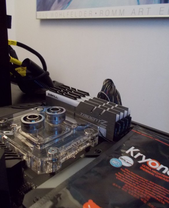

...all the parts trickled in (some quicker than others) and I started the prep work for the dual-loop (3950X, Strix 3090 OC)...everything cleaned and flushed; allen head srews and fittings checked and tightened, initial leak tests done...much left to do though
Looking good, keep it coming.
Looks great! Definitely looking forward to seeing the rest.

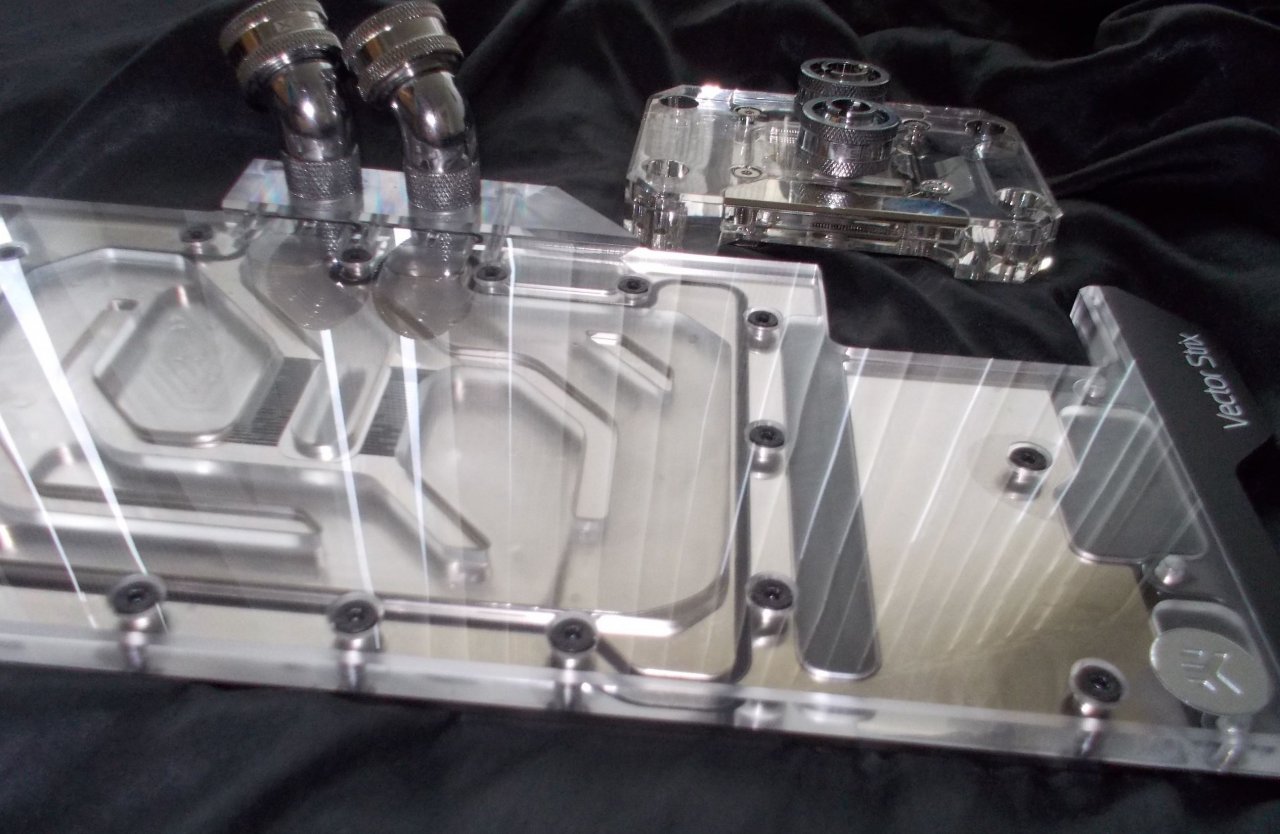

On to the fans...the two smaller Hardwarelabs BlackIce GTX M160 pack quite a punch (thick, w/20 fpi)...I had them for eons but they're getting 8x Arctic P8 pwm (up to 2000 rpm) in push/pull...these are the revised P8 and are the counterpart to the P12s destined for the two big 480 rads in push/pull.
It's fun using older but proven w-cooling peripherals and rejuvenating them.

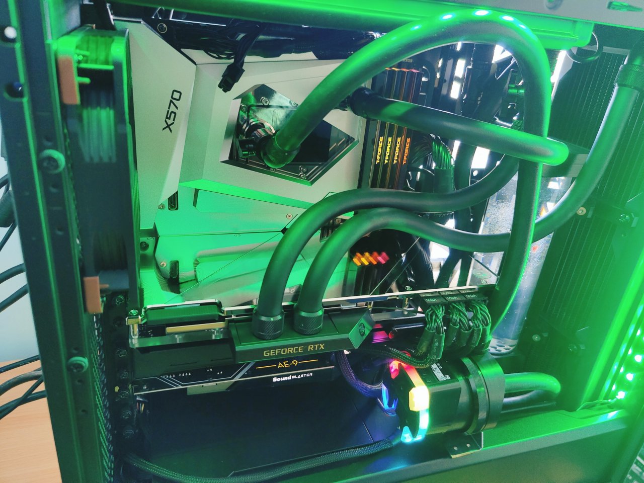

...is this your first rigid-tubing project ? I've done copper tubing before, but never a build with the tubing you linked above...
...one of these days ?
Yes. I've only ever used soft tubing up till now. Hard tubing is very new to me so it seems I have much to learn. I looked up some fittings and see they don't need barbs like soft tubing, which I guess makes sense. So I guess that answers that question on ID.

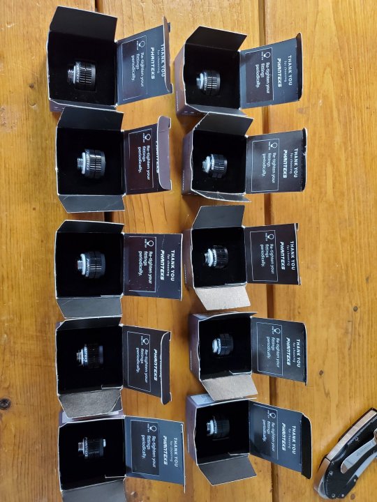

13 minutes ago, Avacado said:
Side note, these Phanteks fittings have to be the NICEST presentation I have ever seen for a fitting. Effing felt ffs.
Yeah, Phanteks does seem to do a good job with presentation - the AM4 block I just got was packed and presented very well
Oh, good call. I thought it was PETG, so I am a dummy. I will just order from that PPCs link...
No worries, let me know when you are ready for a bending tutorial. I only have a cell phone for recording so it might be a bit weird.

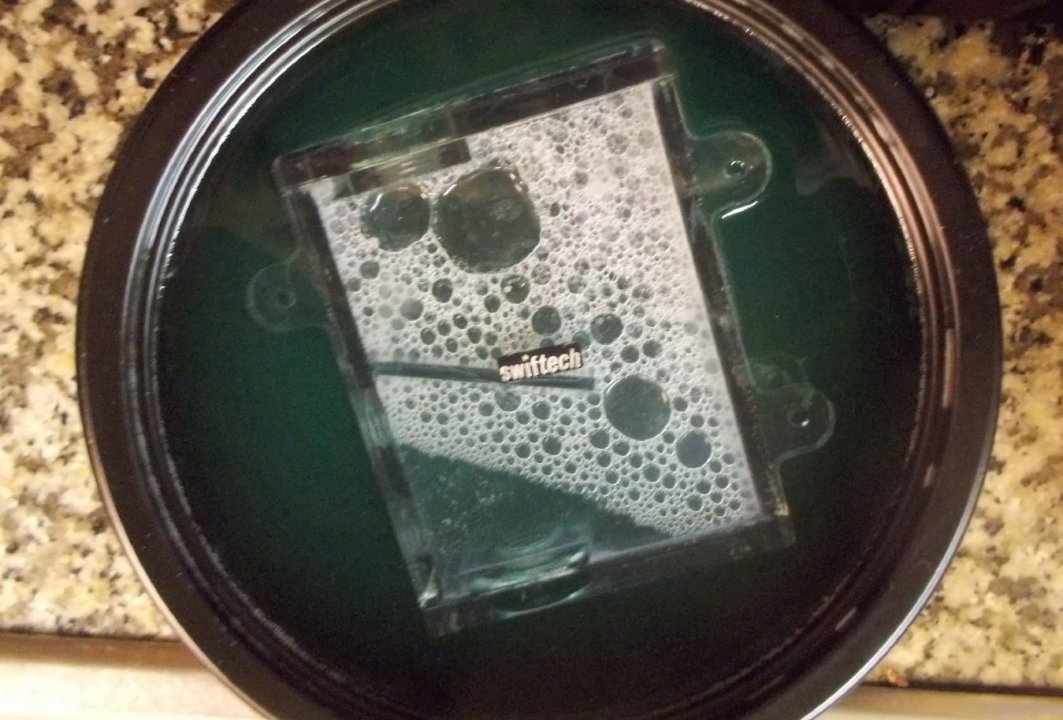

EDIT: ....finished soaking and cleaning 25 or so previously-used  compression fittings, now on to the 2x Swiftech rev2 mini-rez_s

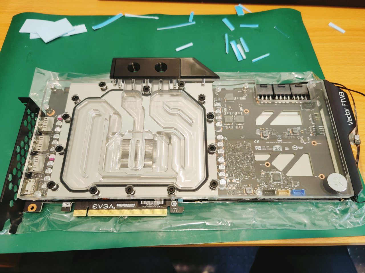

Just finished adding my EK block and backplate to my EVGA 3090 FTW Ultra Gaming.
IMG20210313133256.thumb.jpg.7711e1687625201b768b05d310118d4a.jpgIMG20210312122444.thumb.jpg.d3ea06fba790deb5302d7c1b623b5b91.jpg
Yes...my PC is Borg.
...Congrats ! I get to do the EK GPU block for the Strix later today ?...btw, didn't you have an Alphacool block (broken stand-off on arrival) for this GPU/build ? If so, will you switch GPU blocks later ? Or did the EK Cube transmit 'resistance is futile' ?
