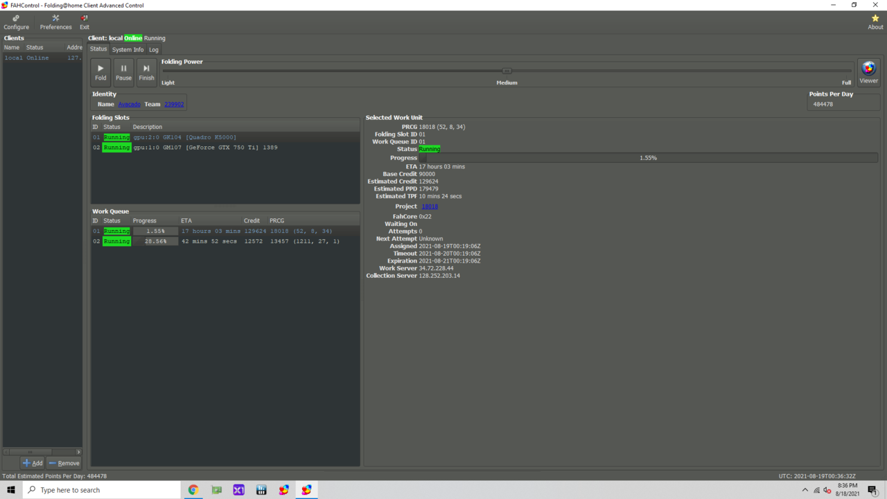

Same issue as the K4000 @tictoc. No idea how to fix the issue of failed CUDA initialization. At least the 750Ti is working as expected. So I will be running that I suppose.
I really don't know whats happening, same issue on the 750Ti now? I can only assume that having Quadro drivers and GeForce drivers on the same machine is messing with it somehow.
First thing I would do is ditch the Quadro drivers, and see if the regular drivers pick up both cards. I'm pretty sure that you can only initialize one NVIDIA driver at a time without creating conflicts. There is not really anything in the Quadro drivers that will accelerate F@H, compared to the regular GeForce drivers.

So, had a major storm roll through with significant flooding in the area, though we weren't effected. Lost internet for a day and a half. Did a clean wipe of windows and did as you suggested @tictoc and it seems to be working CUDA on both GPUS. Going to run overnight to see how it holds up and petition for the change tomorrow. Sorry about the lost points.
I have to say, at the current multiplier rates and current folding, the K5000 is dangerous @+200 core. Looks to be about 23 million PPD with 140 multiplier. Fingers crossed.
And the 750Ti @40x multi is nothing to sneeze at, still 12 million PPD Stock.

Does anyone have any idea how to counter the cards running CUDA on the first WU, then always defaulting to OpenCL after? Even with current drivers? It is really becoming frustrating, I mean the PPD difference is almost double.

Yup, sorted. 40% OC, she has been hitting 220k PPD on teh larger units. Would like to put her on the AIO when we have down time and take her higher.
