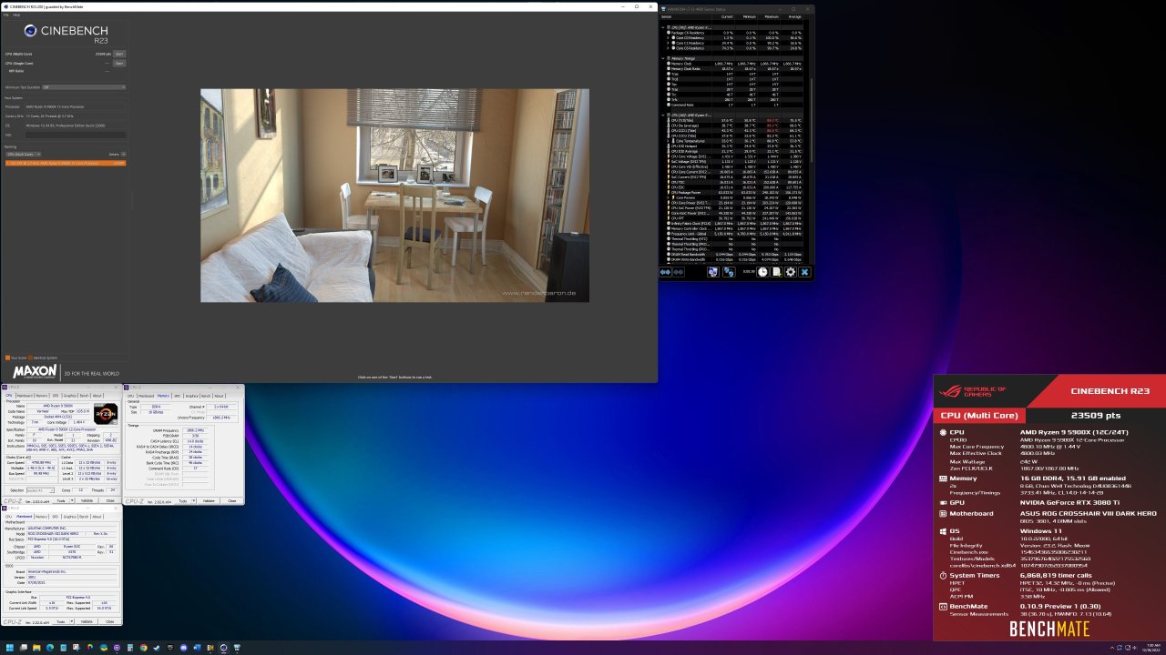

Following the tips from @neurotix, I tried some per CCX all-core overclocks. I think I still have a lot of room to work with, hit max temp at about 75C.
Here's my last CB R23 multi-core run with CCX0 at 4.75GHz and CCX1 at 4.6GHz under 1.35v. Looked like you hit 23,700ish, what did you end up getting your OC's up to @neurotix?
EDIT: Tried again with 4.8GHz and 4.65GHz. Did a bit better.

Very nice! I'm about 250 behind then. Were you also trying Dynamic OC mode?
A protip: you get slightly to a decent amount higher Cinebench scores if you set the process priority for Cinebench to Realtime. The system will essentially lock up and show just a black screen for Cinebench and not show the render, but if you wait it will finish and show the whole render and your score will be slightly higher. I tested both with Realtime and without at 4800MHz and in R23 it increased my score by around 300 pts. On other setups/my old 4790k/older versions of Cinebench, it would actually give you like 500pts more or higher when running the process in Realtime.
I think you can set process priority to Realtime using benchmate, but I personally use a program called Prio Process Priority setter. https://www.prnwatch.com/prio/
That program will allow you to control process priority through Task Manager under the Details tab by right clicking on the Cinebench process.
And no, I did not use and have no idea about Dynamic OC mode. I just went in the Extreme Tweaker PBO menu and set both PBO and PBO Fmax enhancer to off, left voltage on auto, and set clocks and VID in the per CCX menu.

Thank you very much for the advice/tips @neurotix and @The Pook. I was able to do 4.8GHz/4.65GHz on the 5900X at 1.44v and crossed 24k multi-core score for the first time.

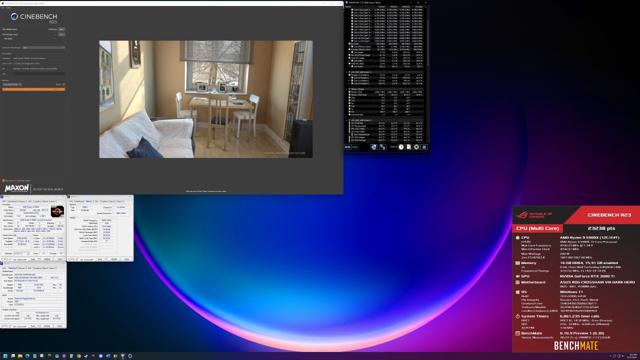

Results with 4.8GHz / 4.675GHz @ 1.44v:

Was this with L1 and L2 prefetcher off? I hadn't heard of that tweak either.
Also, in Extreme Tweaker there's a drop-down box near the Per CCX entry that says something like Performance bias and it has entries for Cinebench R15 Gentle, Cinebench R15 Aggressive, etc. I wonder if those would help.

Yep that trick with the prefetchers and the one to run realtime.
Might have to try that performance bias setting.
FYI, L1L2 prefetcher off is not really a 'trick' (as in cheat), but a setting 😉 ...but no matter what you call it, it works well on multi-core (in exchange for a small loss in single core, depending on the binning distribution of cores within your chiplets).
