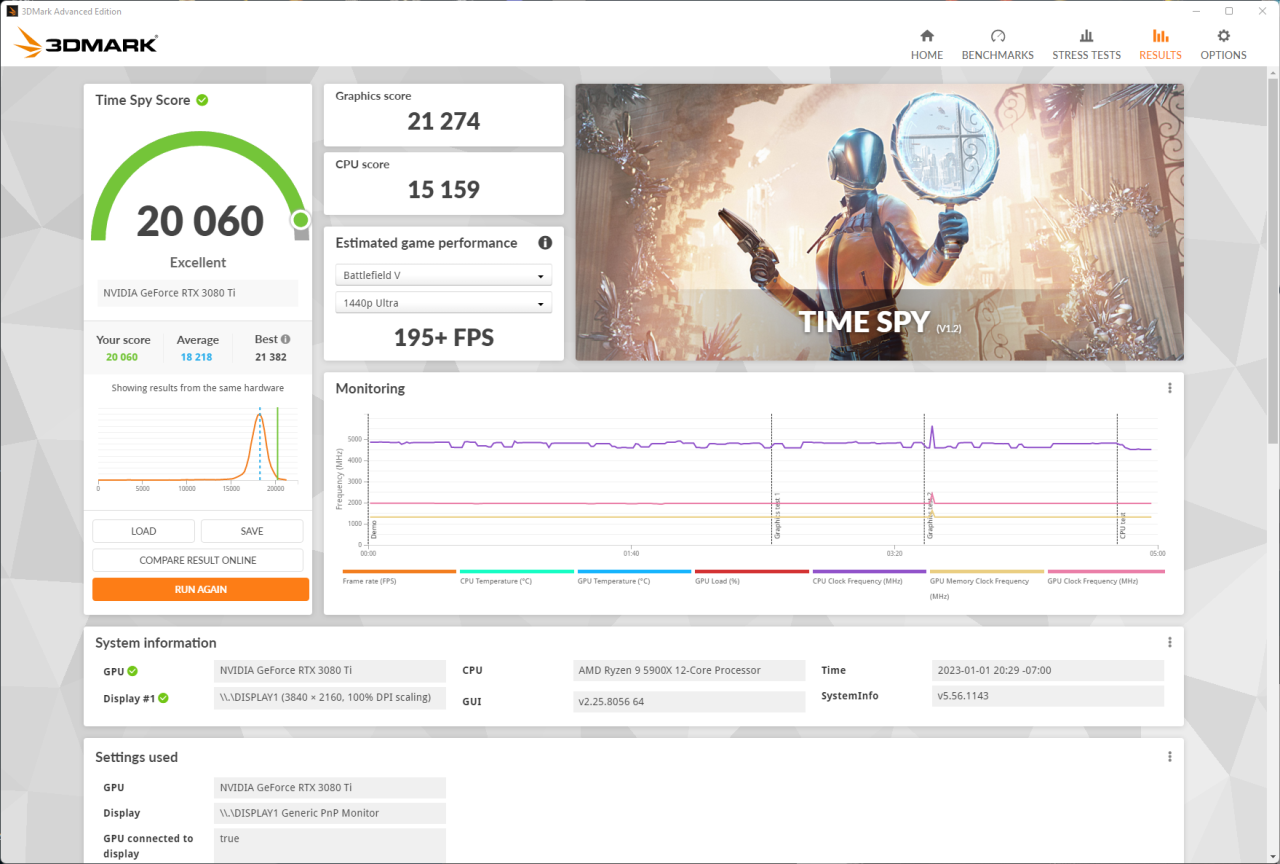

8 minutes ago, Sir Beregond said:
I did a little TimeSpy loop testing with voltage locked at 925mv and it was holding 1950 fine, it technically held 1965 fine too but both these frequencies hit power limits when it spiked up to 400W (max on the FE) despite a 360-370W avg. Tried 1980 as well and it would drop a lot to 1965 and after 15 mins crashed the benchmark.

I noticed once I added the +1100 Memory overclock, my 1950 clock would drop to 1935 on those spikes that hit 400W limit.
That said, I upped my TimeSpy score to 20,005 from 18something with just an overclock and no volt limits (and thus lower avg clocks). My average clock on this run was 1949 while previous overclock and no locked voltage was more like 1919.
Did another run. This time I dropped to 900mv locked at +210 to the Core and same +1100 Memory. I mostly had a 1965mhz run on this one: Compare Link
Seems my real limit is the 400W. Really contemplating getting a cheap card and learning how to shunt mod.

Oh I've been tracking the graphics score and that one was my best run with voltage lock. I did another run without it and got marginally higher, so not sure this undervolting is really helping me here aside from maintaining a steadier clock that isn't bouncing around.
