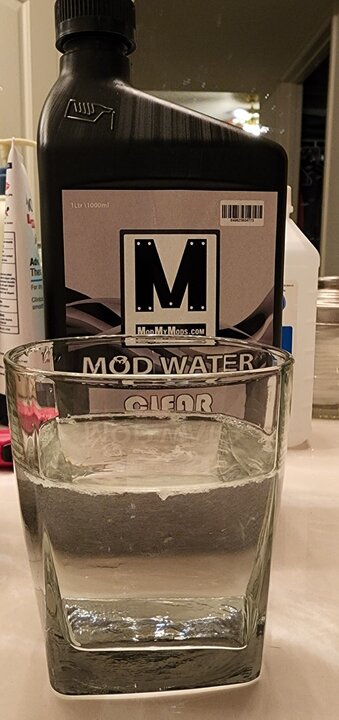

Here's some info about ModWater that's a couple of years old now, but may still be relevant: ModMyMods.com premix Fluids is made from Mayhems concentrate
Also see:  Tons of flakey debris in loop
Mick, the original owner of Mayhems, sold the brand not too long back. Hard to say if the new owners might have screwed something up.
Awe, I had a post on that thread. 2020 keks.
I finished draining the loop tonight. There seems to be approximately 150ml of fluid left in the loop, I'm guessing stuck in the rads at this point. Will be doing a very thorough flushing and a blitz part 2 run when I get some more distilled water.

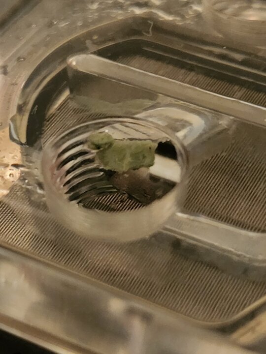

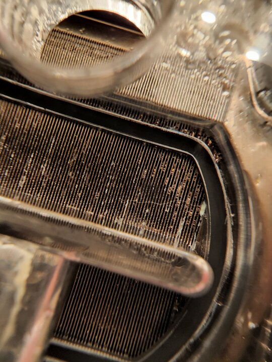

Anyway, here's what the drained fluid looks like. I think a lot of the big particles either broke up or lodged in the Optimus block which appears very gunked up. But you can still see some floaties.

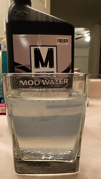

For comparison the second image is another bottle after vigorous shaking and it's full of this gunk too.

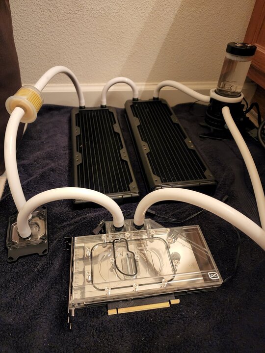

Current plan is to rip everything back out (not sure I am going to take the block off the GPU though) and run a bathroom loop to Blitz part 2 it again and then do subsequent flushes. I want to be thorough. Also need to take the CPU block off and probably clean it manually first. The GPU block by comparison does not have as small a jet plate and microfin structure, so I don't see any gunk stuck in it. Really not sure about the radiators.

The two bottles of Mayhems XT-1 Nuke I ordered arrived today and look to be perfect, no particles floating around. I also emailed MMM support to see what they say about the Mod Water.
I still need to grab some more distilled water to re-clean the loop, but alas, difficult to find around here for some reason. There is one store I can usually find a couple of gallons (which is all I should need) that I'll be by later today or tomorrow. I think I have enough on hand still to make another batch of Blitz Part 2 tonight and get that going at least.
EDIT: Just got a call from MMM, they stated they had some bad batches from the Mayhems switchover when Mick stepped down with the additive packs, and that likely is what my bottles are from. Since they don't serialize the bottles, was hard to track who got what when they fixed the issue. They have assured me that those initial pains from the Mayhems transition are resolved and are sending me 3 new bottles of Mod Water clear. Huge props to MMM for the quick response. They also asked if I needed a Blitz kit, but as I already have one, said I was good there.

Yeah, I'm tearing down as I write this and its not fun...
And back to the Blitz part 2 run in the bathroom...
I did manually clean the Optimus block.
Wow - that was significant contamination !

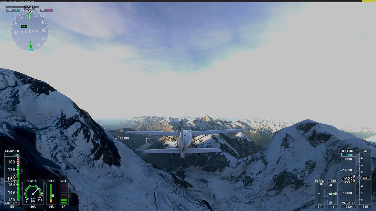

Ed.: ...but once you're done, max your 5900X, pick a medium level oc for the 3080 Ti for FS2020 and go flying in the New Zealand mountains for some reward !

Ok, finished the Blitz Part 2 run and 3 flushes with distilled water. PH testing is coming out a solid 7 after last run. Parts are drying now. Also cleaned all fittings and the tubing.
This gives me an opportunity to think about my fans again. I previously had it where the side is intaking and both radiators are exhausting. Wondering if it makes sense to intake both radiators and exhaust side? I don't know. This case still confuses the hell out of me when it comes to airflow. I definitely think that custom PPCs front panel is in my future.
