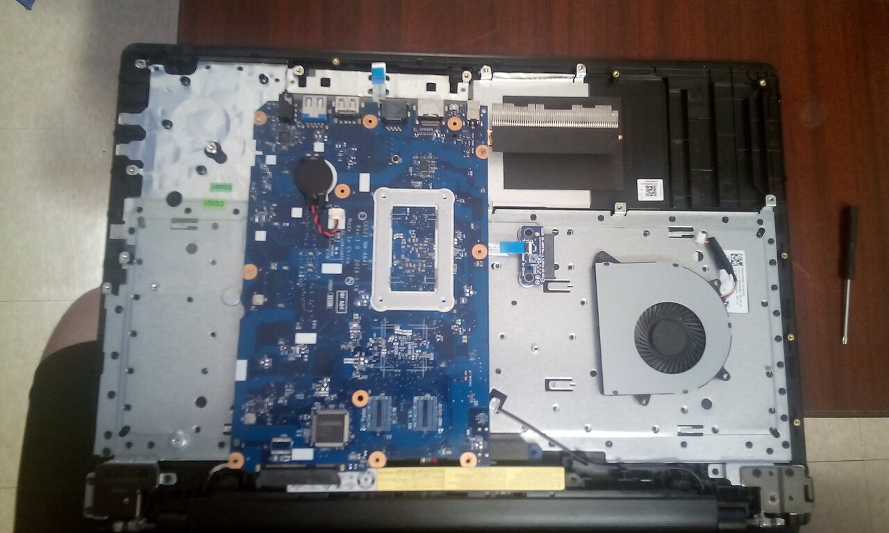

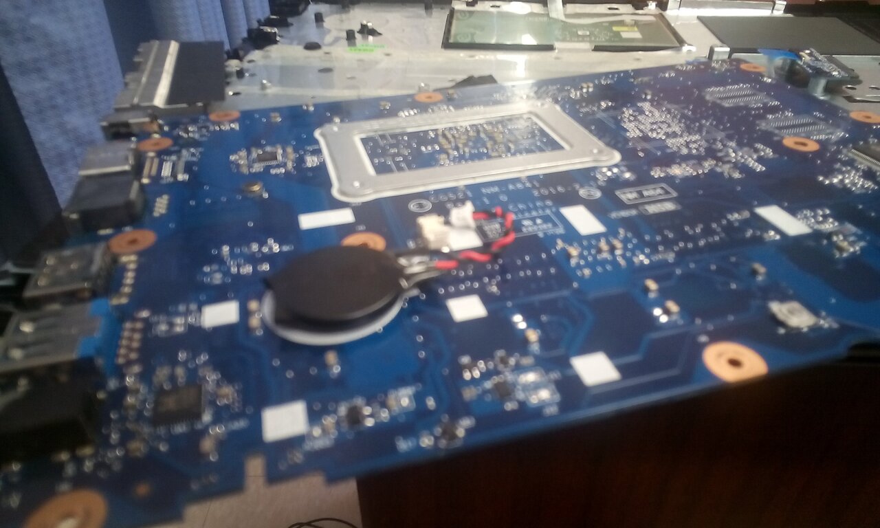

You can try resetting the motherboard by removing the mobo battery if there is one, maybe try one stick of ram at a time but it sounds like the motherboard is probably the issue so short of replacing it, you might have a paperweight on your hands.
I think I accidentally locked myself out because the Novo button doesn't work, well it does and I press ENTER on BIOS Setup & it reboots and doesn't do anything same with Fn F2 or F2 alone.
How do I reset the CMOS?

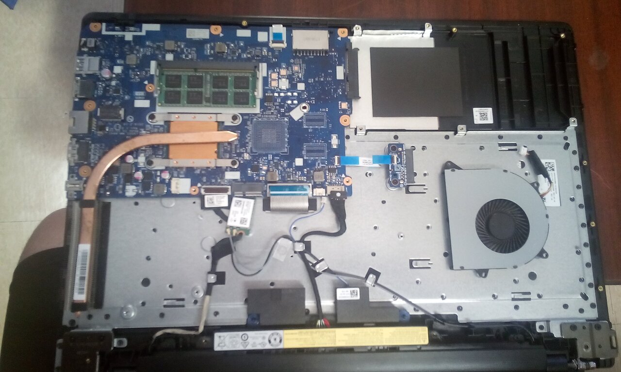

Take it apart and look for a battery on the motherboard. Take the battery out for one minute and then put it back in. Make sure the main battery is disconnected first. Just like you would do on a desktop, this will reset the CMOS/BIOS/UEFI whatever.
Newer laptops don't usually have this battery, but your probably does if it's DDR3.

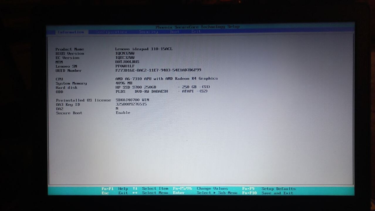

So I put it back together after now charging led is blinking orange idk why it appears to be charging in windows.
Anyway yeah I cant get into the bios, fn f2 doesn't work and f2 just keeps rebooting every time i press f2 on boot up it restarts over and over and over again never going into the bios.

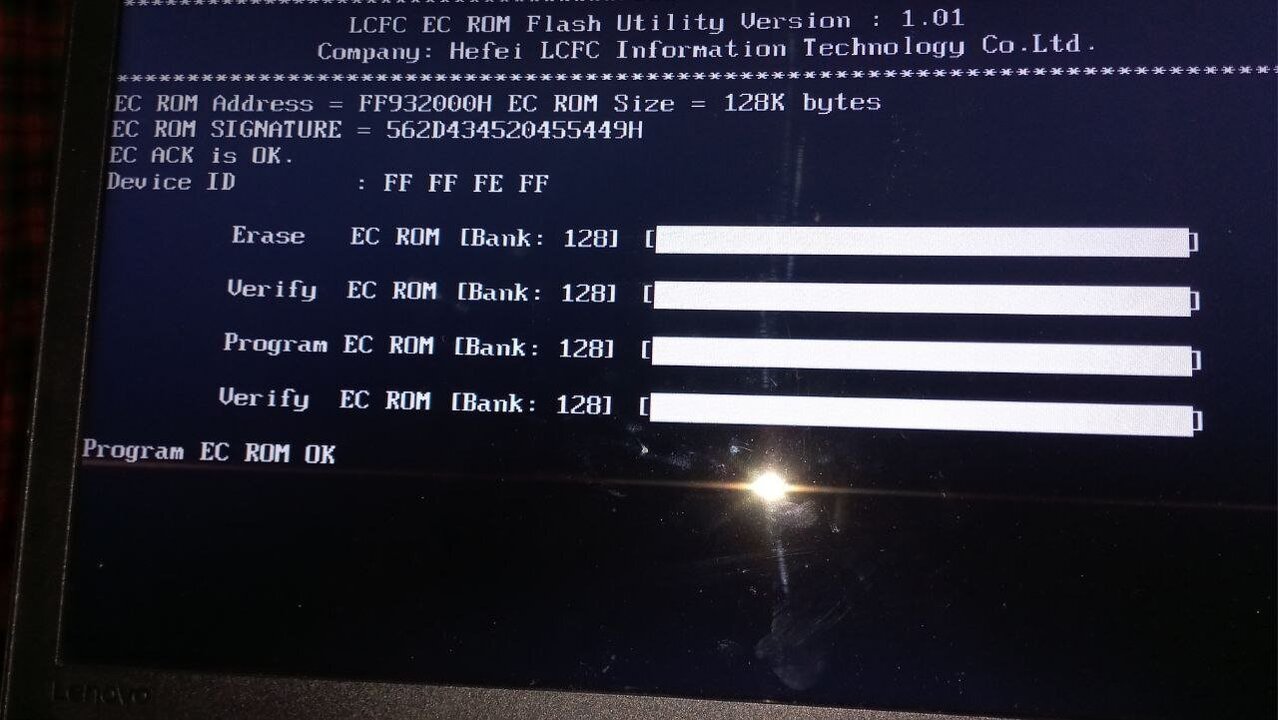

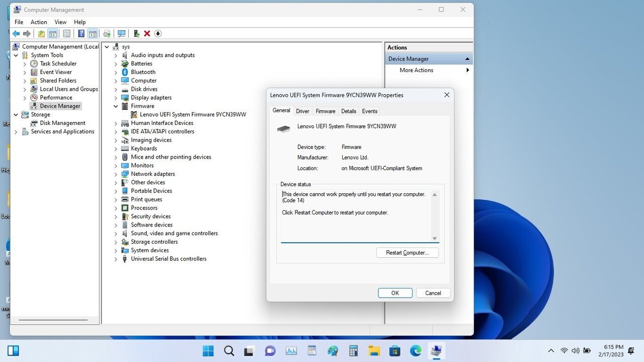

Well I updated the firmware via Windows Update & it reports an error in device manager and won't apply the system update which is reported in the BIOS.

Thanks so I am working on it now and it says Rollback flash is disabled in the BIOS so I am hoping I can bypass it.  I'm reading this content here but the commands aren't working.  May you advise how and which command to use to skip the bios version?

From the flag list, I would try using the following
sd                        Skip BIOS build date time checking.
winflash /nodate
It is saying the usage is:
winflash32 sd
Don't use a / or - prior to the command, just a space.
winflash32 sd
still receiving the error message.  I am looking all over for how to enter the command.
5 minutes ago, ivebeenmemed said:
This is a corrupted firmware update pushed by Lenovo to Windows Update and Linux fwupd. Unfortunately I also don't have backflash on so the Phoenix flash utility is no use to me, i havent tried winflash yet though.
Hopefully we can help you out.  I know I never updated my BIOS and I was able to get in there at one time and now I can't.
Thanks
So I was poking around & I found this thread which is pointing me the right direction, not to mention I opened this file which gives me some juicy information as well.
COMMUNITY.ACER.COM
So I wanted to set up a dual-boot between Windows 8.1 (With update 1) and Ubuntu for Android development on my Acer Aspire V5-571P-6429, rather than using a Vitual Machine and having to share resources.
I am closer to getting it.  I ran this command and it almost worked but errored out instead.
Just copy the BIOS.cap & WinFlash32.exe to C:\ and try some commands out... lol I'll let u know what works.
C:/WinFlash32.exe /bcp /sd /ver /cvar /v /endkey /silent /bbl /cac /cbp 30 /file C:/BIOS.cap
Edited by HeyItsChris
