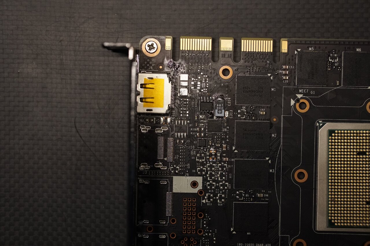

So let's start with the card itself:
Looks pretty with those red lights reflecting on the original cooler, which looks even better in person. A shame I have to remove it..
The old paste and pads:
The paste was pretty dry, but it wasn't hard to clean it.
I'm not sure if this is original, it looks like someone replaced the pads.
Looks good after cleaning, but we will have to wait for the cooler to arrive.
New pads on the aluminium backplate:
I did some measuring to get the thickness right for the pads next to the Vram.
I'm pretty sure I don't have any option to cool anything on the other side of the PCB, so I try to cool this side of the card as good as possible.
A lot of bolts to get some pressure on the back, and not too tight for obvious reasons.
Also, an IO shield from a GTX580 installed on the card. Not the strongest solution with only one bolt, but at least it's a good fit.
And here are the m.2 coolers on the back with some double sided tape/coolpads. As soon as I can fire the card back up I'll measure the temps on the back with a digital thermometer, to see if I have to improve it.
That's it for now, I'm waiting patiently for the cooler!

Just so you know, there are thermal pads under that backplate there. 0.5mm. Is yours the 12 or 24 GB variant?
I already replaced those, but on my card they were 0.75mm.
This one is a 12GB card, does that impact anything?

Below 85°C should be no problem, maybe some OC headroom or possible mods.
I drilled out a hole in the backplate a little bit to fit the io shield, so I knew it was metal. But here is a little display for you, I scratched a little bit of paint from the side and did a resistance check.
Also flipped the picture around in the original folder a few times but the forum keeps uploading it upside down :classic_laugh:
