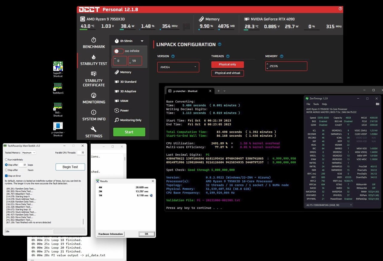

My primary RAM test tools are TechPowerUp Memtest64 (lower left) OCCT, including the Linpack, and Y-Cruncher, with some SuperPi thrown in. Each can be varied re. loops / length all the way up to infinite (not that I would, but I could...).
My version of TM5 has a severe security issue, probably because it was downloaded from a questionable site (did check first, though) --- it attacked Win 11 tpm 🤪
